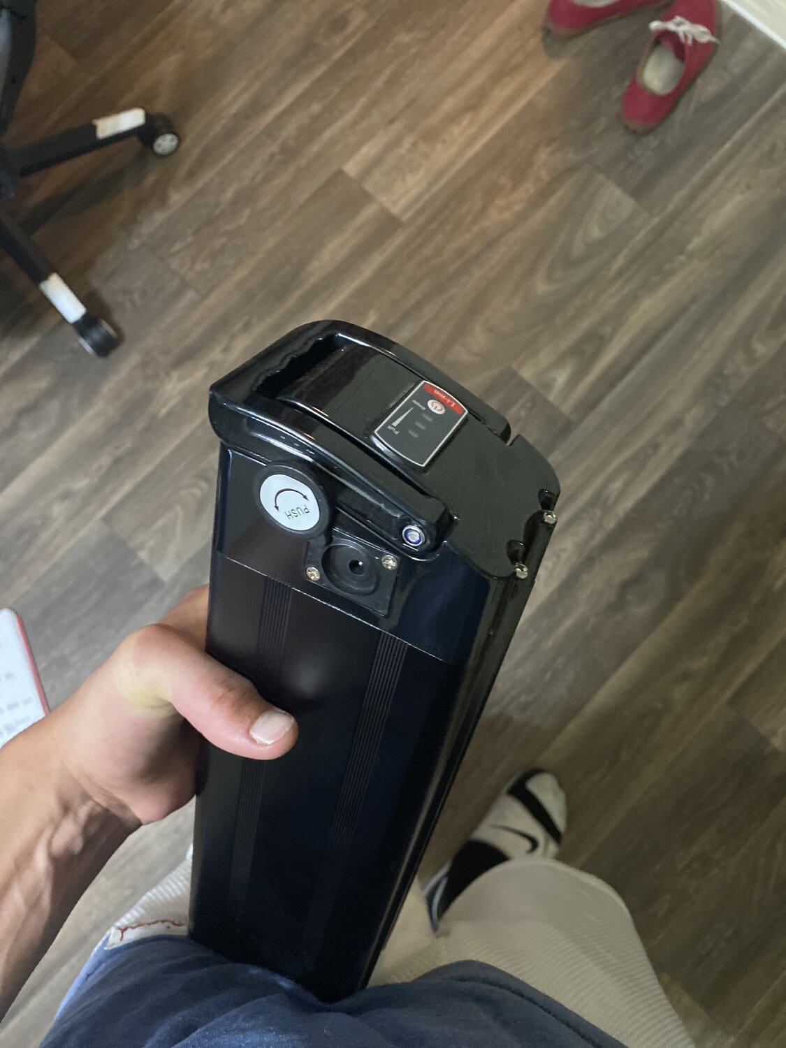

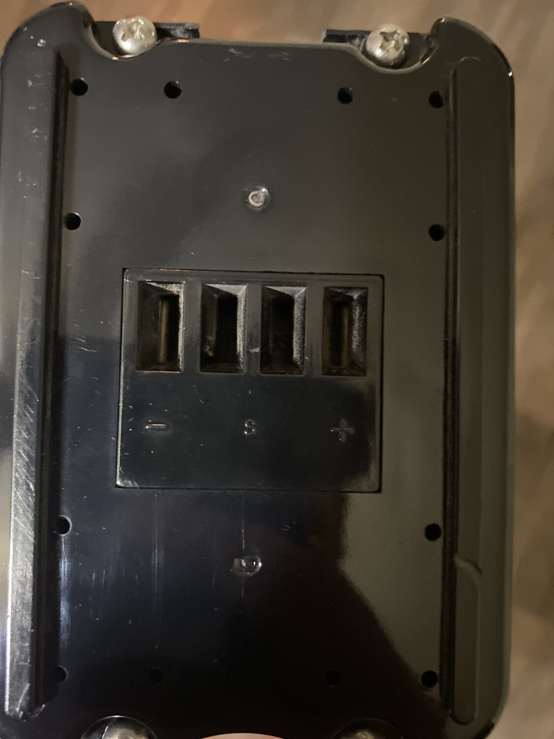

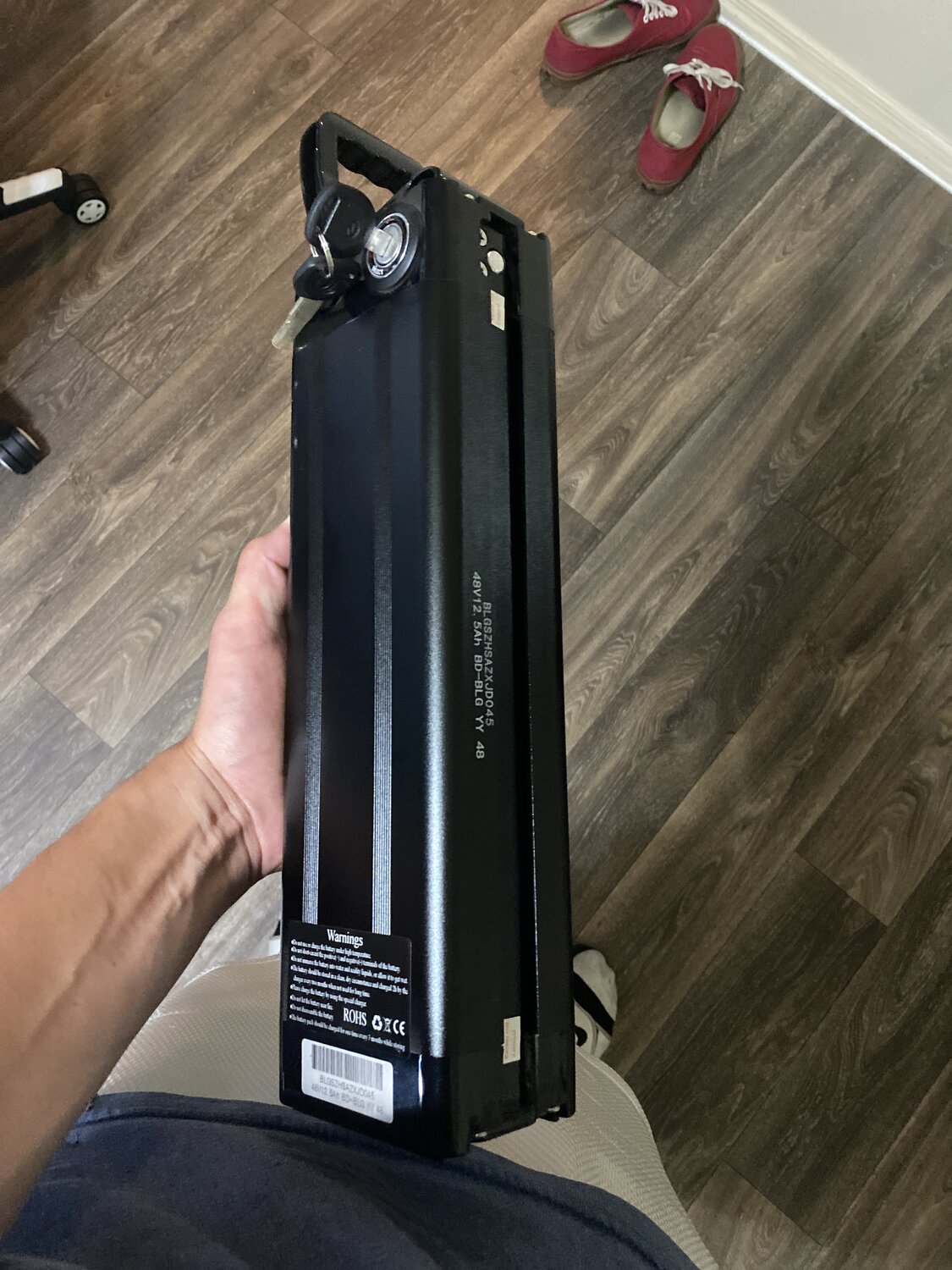

Provide a picture of your battery. Most suppliers across the pond have access to a variety of cases it is just luck of the draw if they have one like yours.
Here she is
Send those to herbert@dtbattery and let him know you want a 48v 12.5ah one and see what he says?
