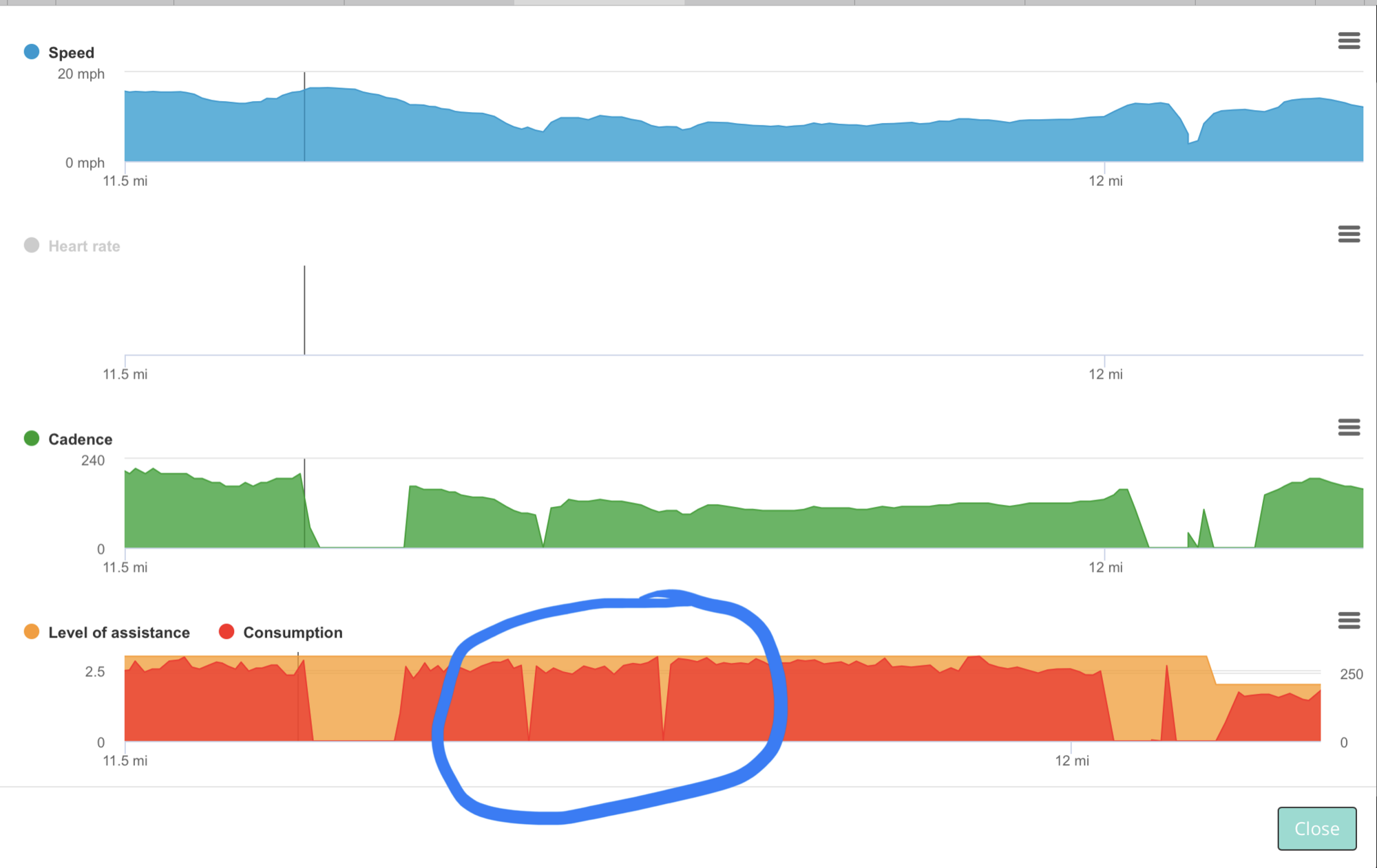

Don’t let them get away with that. Record your ride on the MAHLE app then look at the graphs that are created in your on-line account. Scan the “Level of Assistance” graph for places the level drops to zero. Keep zooming in and scan carefully because those sections can be only a fraction of a second. I and my LBS struggled with MAHLE for 5 months before, eventually, Bianchi stepped up and sent me a whole new bike. I have not had that cutout experience once on the new bike. Dealing with MAHLE was a very, very frustrating experience for both my LBS and me.
