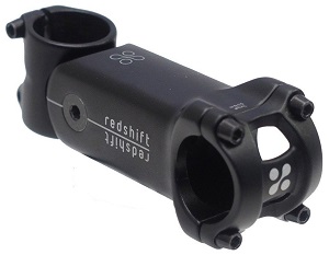

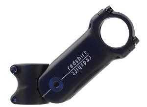

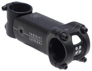

Consider a suspension stem as an alternative to suspension forks. This adds less weight to your bike and removes much of the stress on a rider's upper body and hands from bumpy roads. Found the ShockStop stem made by Redshift, not expensive, $139 and it allows you to adjust the stiffness of the dampers. They make one for a flat profile and a version with a 30 degree rise which could be nice for the more upright position on the Interceptor.

THANKYOU Tom & Ann ! ...Can I ask you Both,...if you know, if that "Shock Top, Red shift" Suspension stem will fit a 2015, 24" interceptor ??....Thanks for Posting these ideas !!
