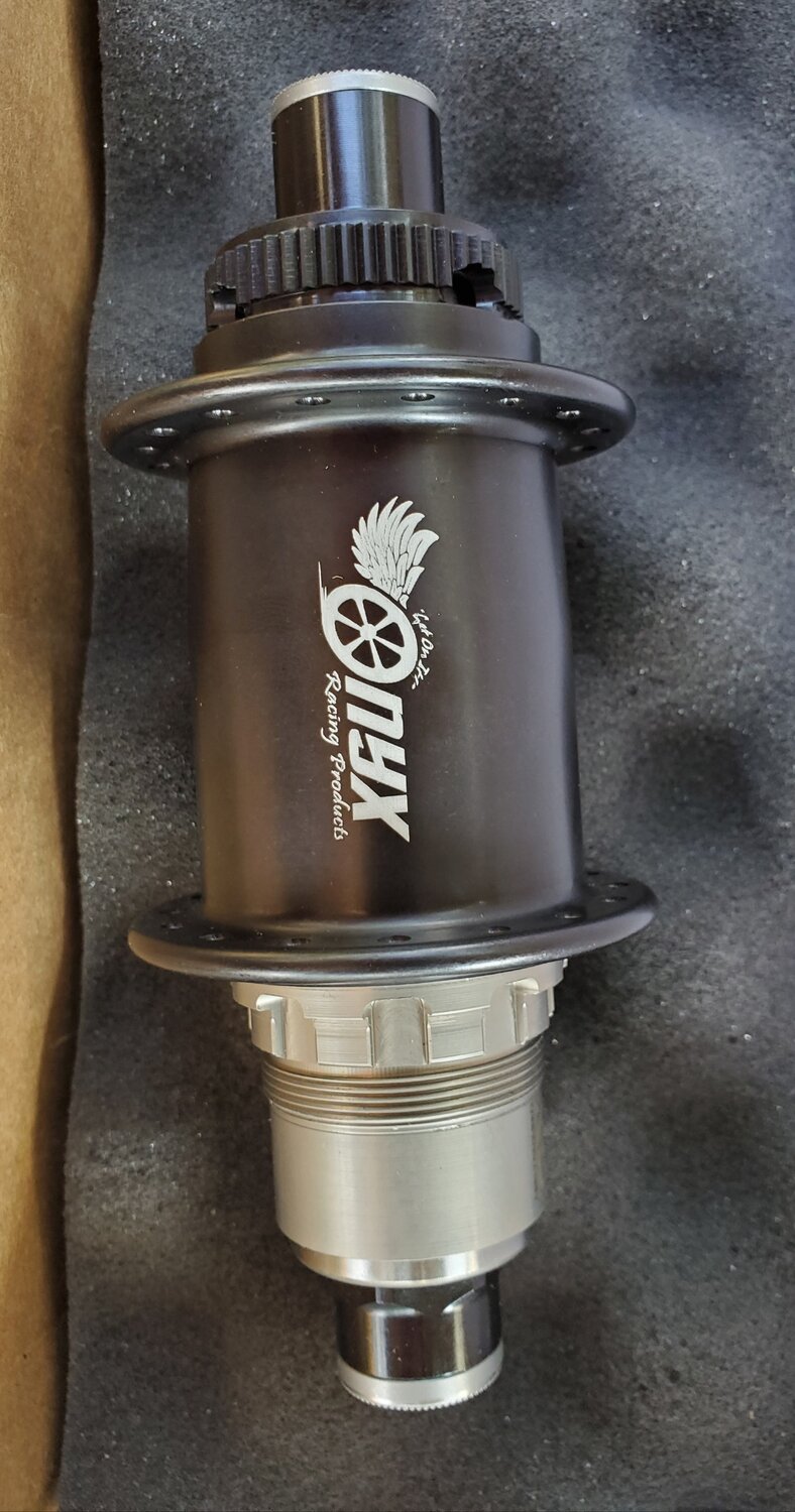

I ordered my new Onyx Classic rear hub last week and hope to have it by the first week of July. I’m also having my Bosch Nyon installed soon. Thanks for all your helpful upgrade tips! In the meantime, I’ll continue to take short rides on my noisy bike.

@JonVonGod Can you tell me which hub did you ordered, Today the hub sounded more noisy.
is this one ?

I’ve got 500 miles on my 9.9s and believe I’m hearing the start of the fail. Rhythmic creaking under stress...but I’ve Recently ordered the Onyx. Today I stopped by the shop and showed them the most recent response from Onyx in the above thread with the part number...micro-spline. The tech that ordered the part was not in so the exact part # was not readily available. I believe on the call the tech made to me earlier he spoke with Onyx and they recommended the ‘Classic’...so the question is will they both work?

I ordered the "classic" in matte black. It weighs a ton by the way. Tech called me today and said it went together just fine with my new SRAM setup. The tech said he was really happy when he heard I wanted the Onyx because he thought it a first-class hub that would match up well with the Allant and hold up well under use - and because he loves to install cool stuff. His report today was that the bike is ready to go, the hub is silent and the whole setup he said was "just badass". I'm just going on his word and the hope that he has fully tested it because I can't pick up the bike and test it for myself until Thursday.

Update: after daily short rides, the rear hub noise has stopped! Not sure why, but I’m keeping my fingers crossed. (...and my Onyx hub on order.)
