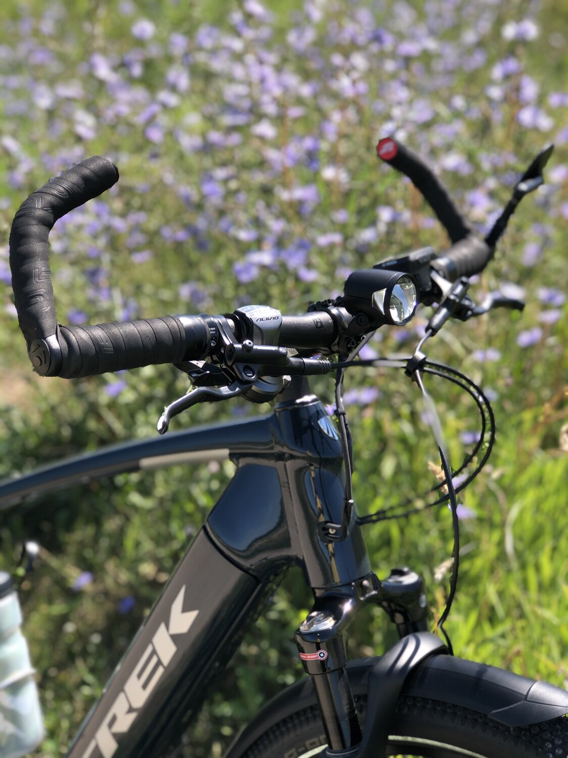

I'm new to e-bikes so sorry for the newbie question but where did you get the extra handlebars that connect to the end grips? , I've been looking for those to change posture during long rides but I dont know what their called exactly.
Very nice setup, I have the same bike too and have already 800miles on it and it's been flawless.
Bar ends? I got mine @ Amazon...Profile Design Bar Ends
