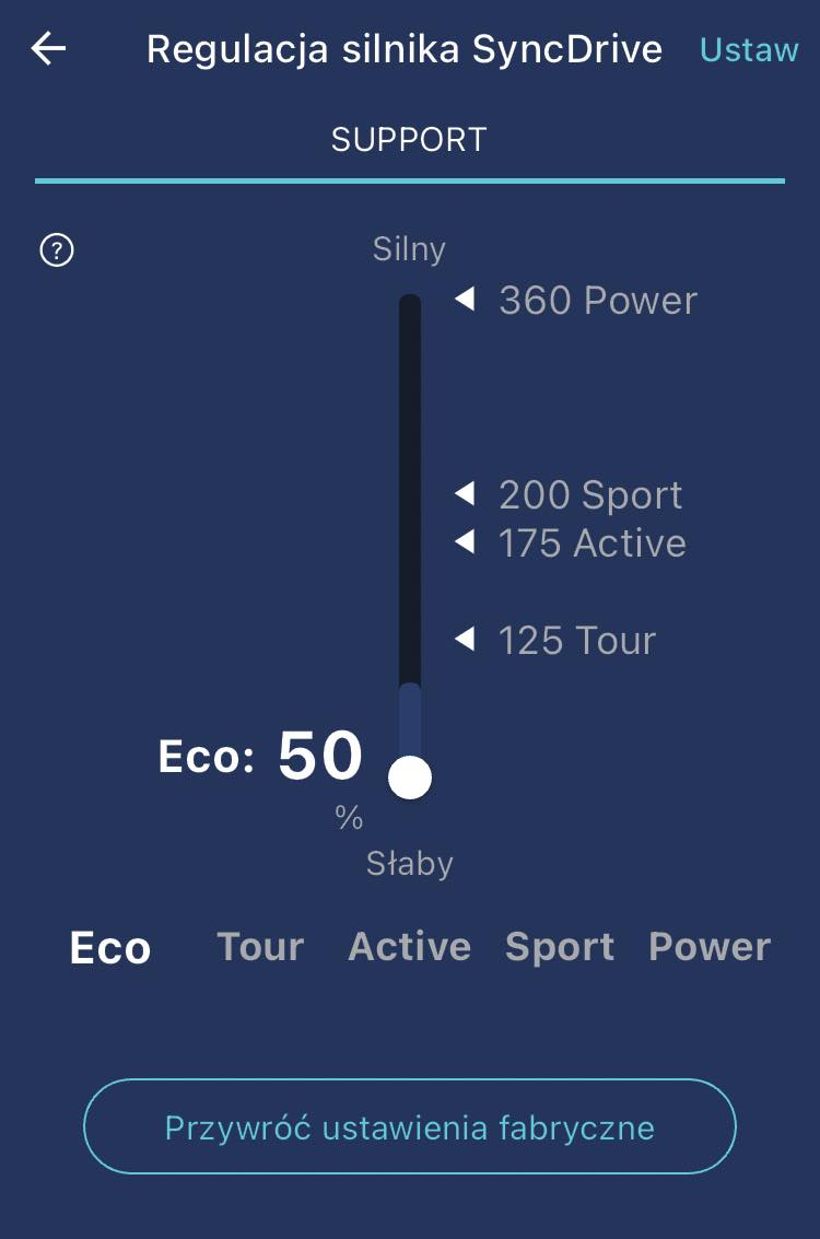

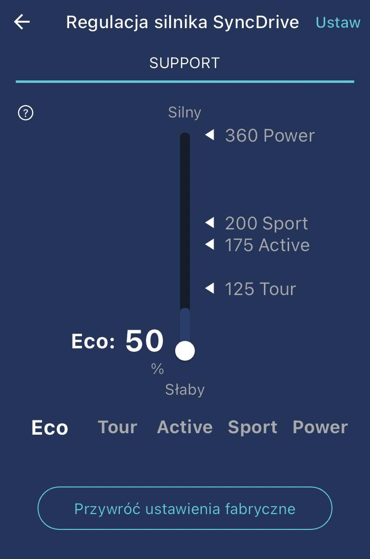

The lowest assistance level is 50%, not 25%.

Try to install the Giant RideControl App and connect it to your e-bike. Were I you, I would set your preferred assistance preset to 100% (the e-bike would assist you with the same power as your legs can provide). That alone would increase your battery range. After several months of riding - with your fitness improving, you might be able to reduce the assistance down to 75, and perhaps even 50%, resulting in very long rides.

Let us assume the Trance E+ Level 2 assist is 125% (I don't know what it is by default indeed). If @ebikenoon pedals at 100 W average, the motor gives the assist of 125 W mechanical. At 80% motor efficiency, the average power draw is 125/0.8 = 156 W. The battery initial charge is 500 Wh, of which around 80% is useful* for a Giant e-bike, making it the effective capacity of 400 Wh. The effective ride time would be 400 Wh/156 W = 2.56 hour. I assume the average speed of 21 km/h, giving the possible range of 2.56 * 21 = 54 km if there is no headwind and the ground is totally flat.
