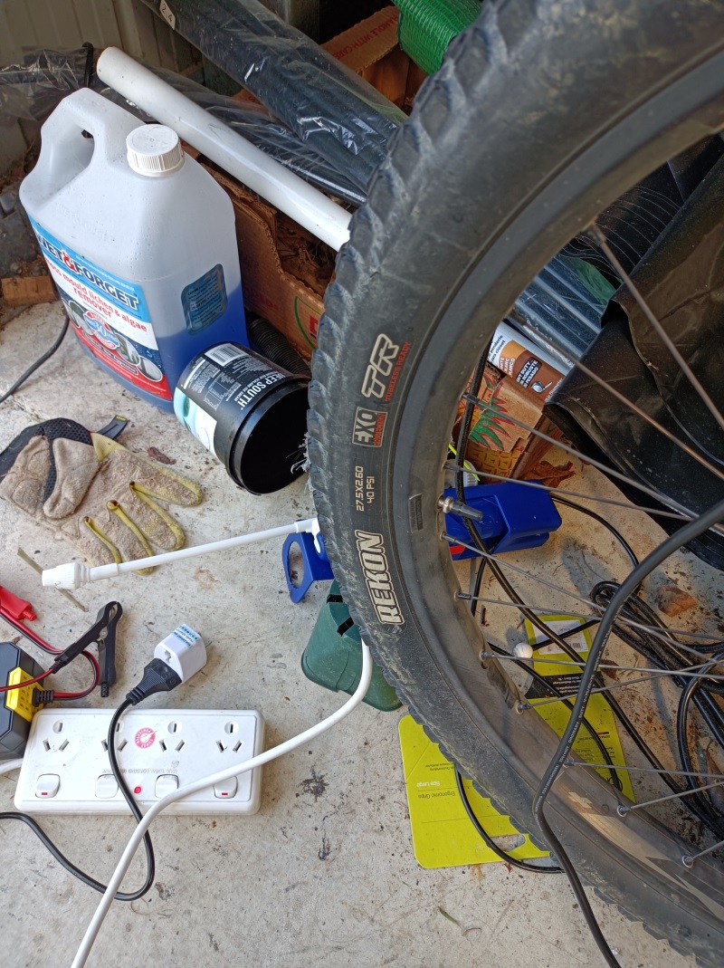

right, so tyres, sorry I was busy all day yesterday
this is the rear that I am told came with the bike

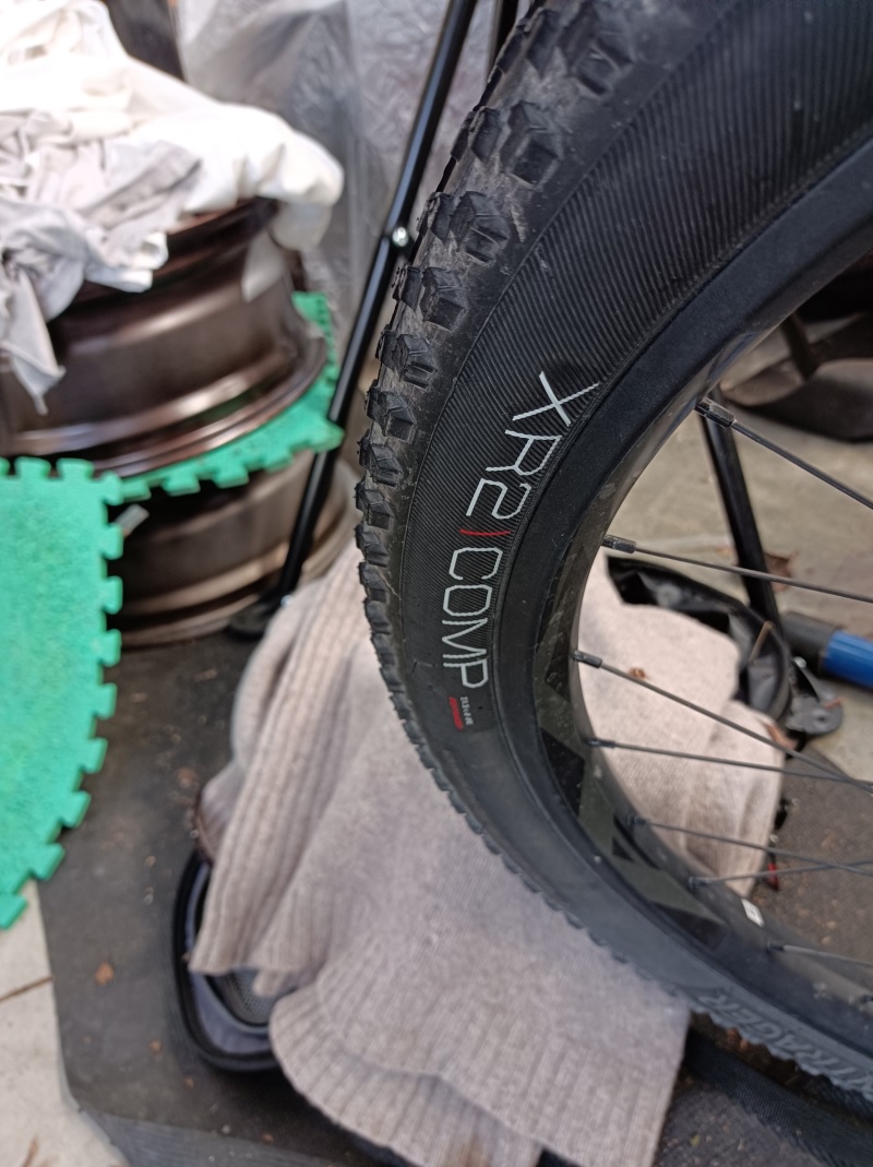

This is the front, its new because I had a blow out, thats another interesting story lol
but I have 2 of the below but I only replaced one because the rear still seemed to have some tread left
Well, if you want to save on the tyres... :) The advice was to replace them so you could save some Watts and ride quieter on the pavement :)

They're both reasonably fast running tyres , so unfortunately you'd only be looking at a couple of extra k's with Stephans suggested tyre
