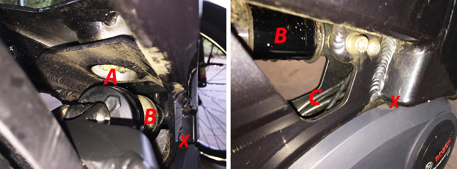

@David Berry :
Regarding dropper posts, is there any way we could make a remote one work?
In other words, is the seattube open at the bottom, allowing for a cable to be run through the frame into the seattube?
Could you post some detailed pictures of this area, and of the cable management in the bottom bracket / swing arm area?
Thanks,
Wannes

Running an internal dropper cable will not be straightforward, especially in transitioning from the bottom of the seat tube A to the bottom of the down tube C. The rear shock B is in the way!
X is in the same place on the bike in both photos – to help indicate photos' relative positions; otherwise irrelevant.
Four suggestions for fitting a dropper post…
1 : Internal cable running inside the seat post A. (Yes, the seat tube is open at the bottom but has a stopper to prevent the seat post bashing onto the rear shock.) The cable will have to exit the seat tube immediately above the X-Fusion rear shock B; there's little room here so a tight bend will be necessary.
2 : External cable running down the rear of the seat tube.
Either way, the cable can then enter the down tube together with the rear brake line and the Rohloff wiring C and follow them past the PowerTube battery. There is an unused cable entry/exit hole on the down tube (top left, next to the battery keyhole).
Is routing the cable through/outside the seat post, around the rear shock, and into and out of the down tube and up to the handlebar worth the trouble?
3 : Wireless remote control. Think Magura Vyron; think many dollars.
4 : Integrated lever. I have used the same KS Dropzone (operated by a lever under the saddle nose) on three ebikes and a road bike. It is simple and effective and does away with cabling problems. Rcommended.
I chose the minimum 'drop' of 75 mm (65 mm on the budget E10 version) because anything more than that would have shot me skywards beyond my correct pedalling position. If one has plenty of room between seat collar and saddle, then 100 mm would be better. The correct setup will have feet flat on the ground when stopped and also allow easy slipping back onto the saddle.
… David

David,
thank you very much for the detailed pictures.
I think a reverb seatpost might work (internal cabling).
The cable (or better yet, hydraulic line) would not have to make a sharp angled turn, but would need to be gently routed around the rear shock.
I guess I'll just have to try and find out when I get the bike.
Main problem is the height difference between me and my wife, the post will have to be at the minimum height for her.
Meaning that at full extension, it will need to be at my perfect setting, or lower.
As this is a eBike, I am not too worried with reachin perfect leg extension. However, I would not like to be more than a couple of cm off.
Technically, I think the dropper post might fit, but the dimensions of the combination will determine if it is worthwhile.
Main problem is the height difference between me and my wife.
The correct dropper post would presumably be one with the same 'drop' as the difference between your preferred saddle heights (150–175 mm?).
On my Homage the distance from the centre of the bottom bracket spindle (to which the pedal cranks attach) to the top of the saddle in the dropped position is 600 mm. Will this be too high for your wife? I suspect that it might. If so, the dropper post option is probably not the way to go.
Before you spend upward of 200 euros on a dropper post, try the supplied seat post to compare your preferred saddle heights.
Bear in mind that Homage's seat post is long but can be cut down to size (proper seat post/steerer sawing guide required). If you so – I'm guesstimating these measurements! – the seat could drop to around 580 mm (with lock in place) or to 550–560 mm (with lock repositioned).
Cutting the seat post might make it unusable for you!
There is always Plan B: his and hers saddles with separate posts. This is based on the probability that any dropper post would be too high for your wife.
… David
David, thank you for your insights.
I guess there's only one way to know for sure: when we take delivery, measure everything.
I'll adjust the bike for her, adjust it for me, and look at the possibilities in using a dropper post, or another solution.
Dropper would be preferred, but I won't put form over function.
