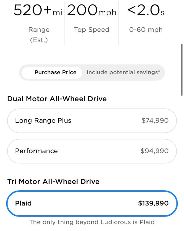

When they announced the Plaid Model S with a Laguna Seca time of 1 min 30 secs, I thought of you :)
