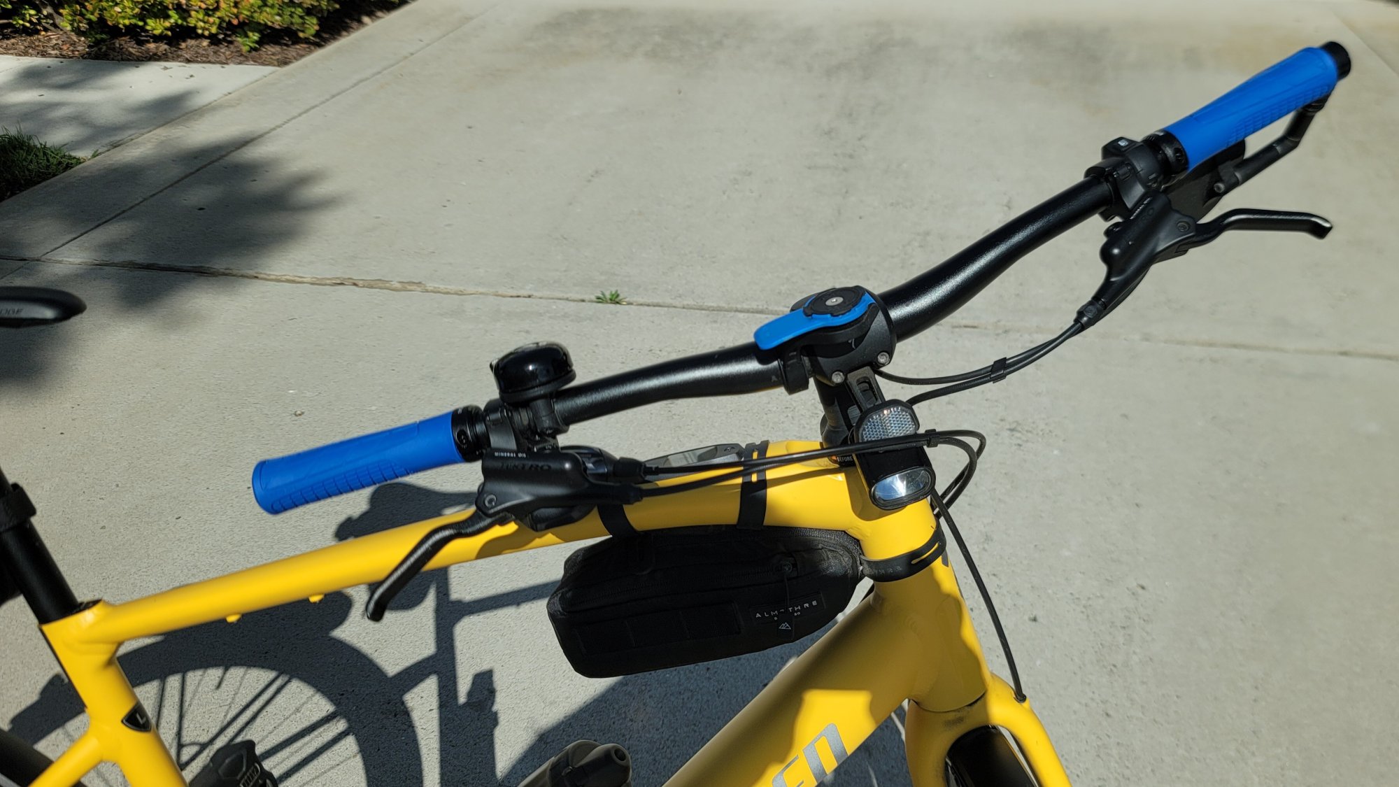

Over the last 4 years, I've had the telephoto cameras in 3 different Samsung Galaxy Note20 phones lose their normally sharp focus. (The first 2 were replaced for other reasons.)
All three have logged many hundreds of miles on my ebike handlebars — mostly on QuadLock out-front mounts like the one shown. That exposure includes a good bit of rough hardpack and cobble. No other pertinent phone issues.
Recently read that this is a known problem with high-end phone cameras mounted on MOTORCYCLE handlebars. The culprit: High-frequency vibrations coming from internal combustion MOTORCYCLE engines.
Apple has acknowledged damage of this kind to the image stabilization and auto-focus mechanisms in certain iPhone cameras mounted on MOTORCYCLES. In response, QuadLock has introduced a vibration dampener for its MOTORCYCLE phone mounts.
QuadLock says that the dampener is NOT needed for phones on BICYCLE bars because the damaging high-frequency vibrations don't occur in bicycles. However, they also said that it's compatible with their PRO out-front bicycle mount.
About to purchase a new Samsung Galaxy S25 Ultra phone. I really like my phone on my bars and really don't want a computer there instead. But also don't want to trash yet another high-end phone camera.
Q. Anyone have direct experience with this problem on a BICYCLE?

Three damaged smartphones on a Quadlock mean a lot of a direct experience :) My S21U lost the focus because I used it on the bars.

It seems on investigation that the vibration affects the microscopic gyros and magnets used for focusing and optical image stabilisation.
Gopros dont have either, so seem far less affected.

I can't say I've ever damaged a cell phone on my bars, since I always carry mine in a pocket, but I have trashed a couple of automotive GPS devices. You are correct about the culprit being the high frequency vibration.
When I installed a Redshift ShockStop stem, the problem disappeared.
The trick is to install a single light (yellow) elastomer.
It does make the bars feel a little "spongy", which serious MTB riders might find annoying, but I like the fact that it also eases my wrist discomfort.

I'm an evidence-based guy. Given that correlation ≠ causation, what's your evidence that your camera issue was really caused by being on a BICYCLE bar?
QuadLock did a lot of testing to identify and specifically target the damaging frequencies with their dampener. Their site has a pretty compelling discussion and video of all that.
That puts them in a position to say with some confidence that those frequencies DO NOT occur on BICYCLES. And they specifically say that the dampener isn't needed on bicycles.
It also implies that the dampener might not do much for the frequencies that DO occur on BICYCLES.

Just a technical note: Vibration engineering is very tricky stuff. A dampener that helps in one frequency band can easily have no effect or even make things worse in another.
So, throwing a dampener tuned for damaging MOTORCYCLE engine frequencies (as the QuadLock dampener was) on a BICYCLE doesn't guarantee the desired phone protection.
In fact, QuadLock says the dampener's of no real benefit on a BICYCLE. As they put it elsewhere, "It's not for bumps in the road." And to my mind, bumps are the only real concern on a BICYCLE — even an ebike.
Conclusion: The dampener won't be part of my solution.
