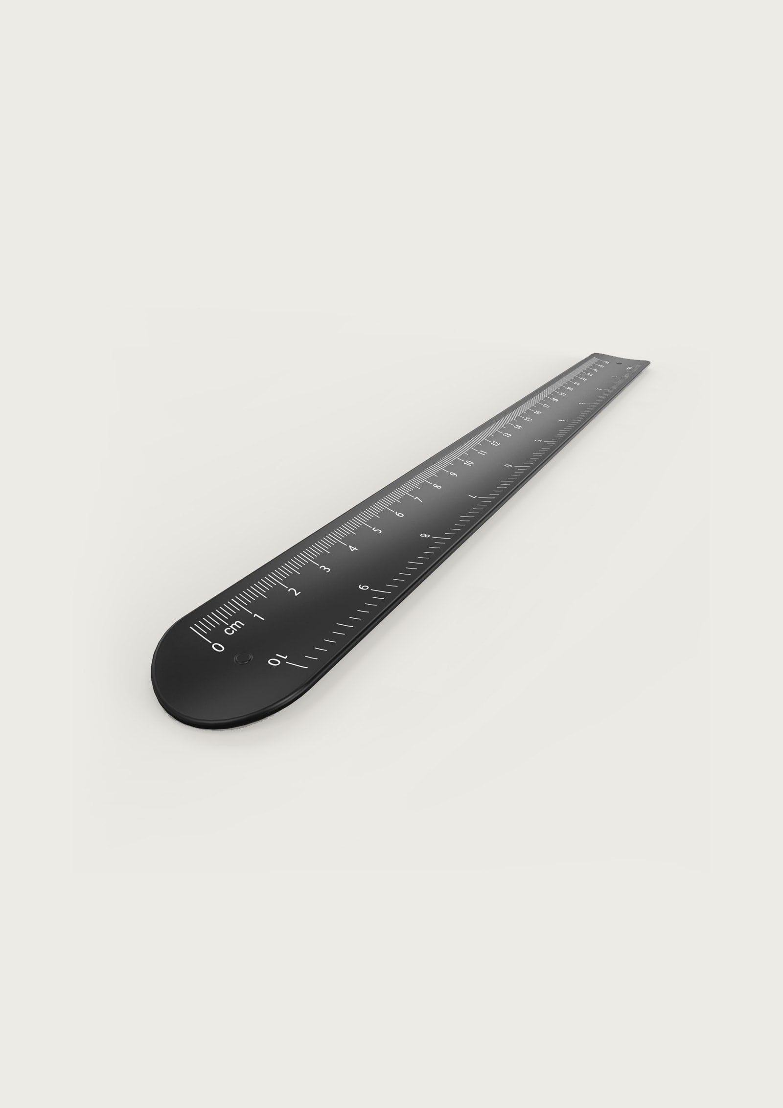

Ah-Ha! There's a tool for that. I should have guessed that someone would have introduced science into bicycle chains. I wonder if there's a tool that can measure shrinkage? You know like after I've been in the pool? It shrinks, like a frightened turtle. Ha-Ha!
Actually, there is a tool for that:
Seems like in 2025, there'd be an app for that.
There is an app for that! 😁😁
It's called Penometer, and is available on the app store:
So it's like Strava with a leader board?? And just when I thought life couldn't get any stranger.
