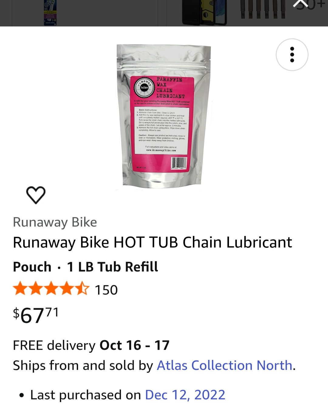

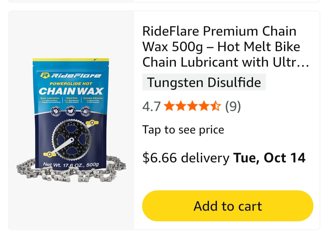

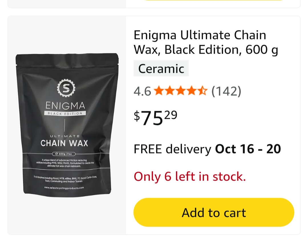

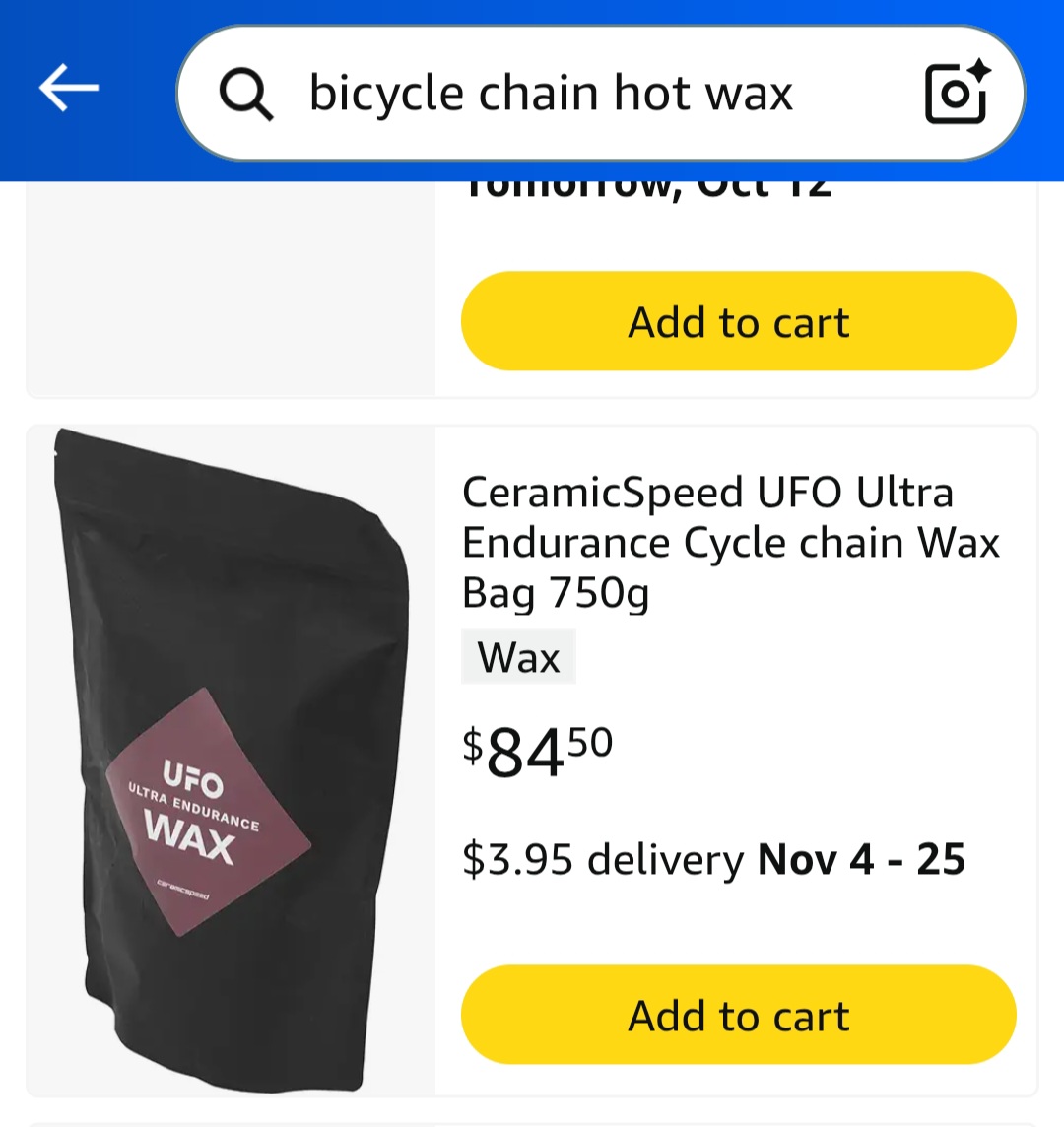

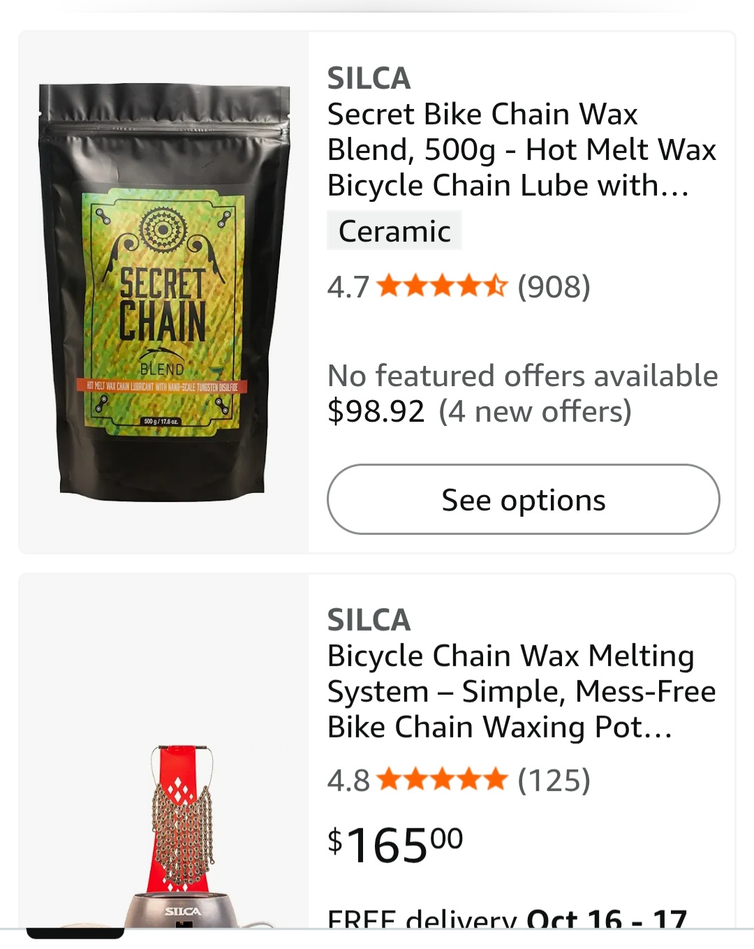

There's a bunch of hot waxes on Amazon, but they're kinda expensive.

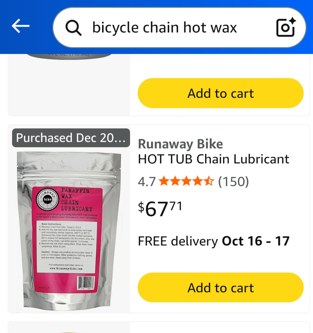

This is what I bought a few years ago,..
It was $35 when I bought it in 2022.

I used a pot full of boiling water with the chain and wax in a heat resistant plastic container in the hot water.
That keeps the wax at a maximum 100°C
A slow cooker works too, and they aren't too expensive.

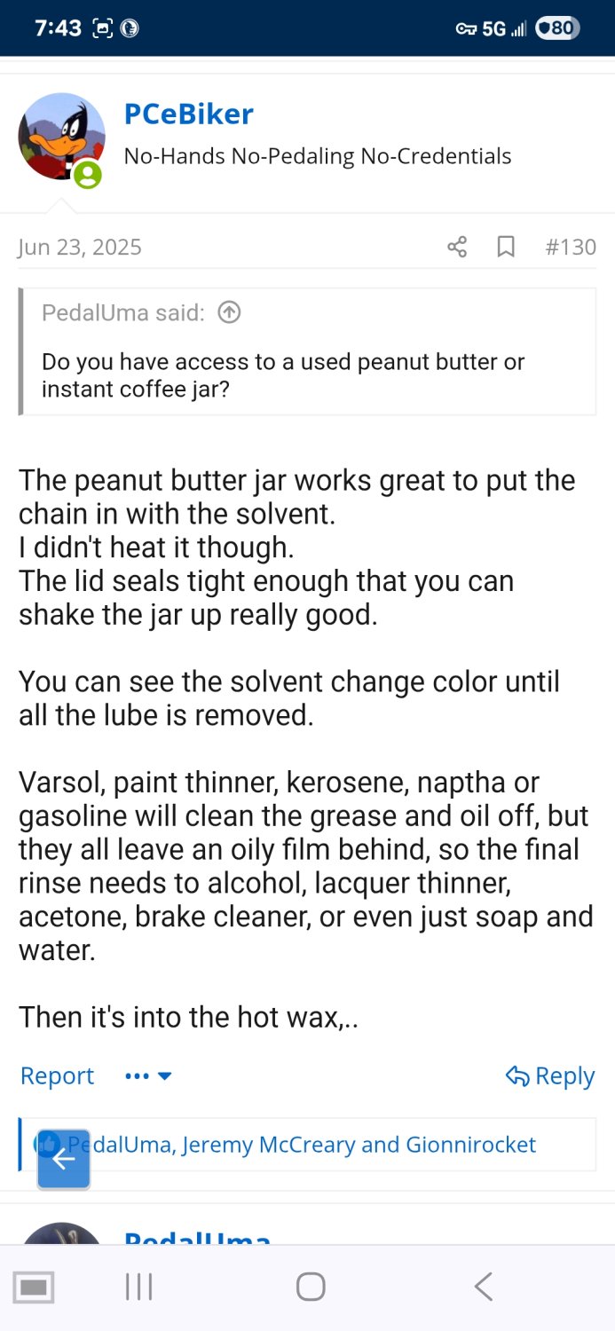

The most important part is getting your chain Completely Clean first with no trace of oil left.
It needs to be removed from inside the rollers.
Any oil left is like finger prints on your brake rotors, and the wax won't stick.
Here's some posts about my chain waxing,..
A pound of wax will do at least a dozen chain treatments.
You remelt and reuse the wax over and over.

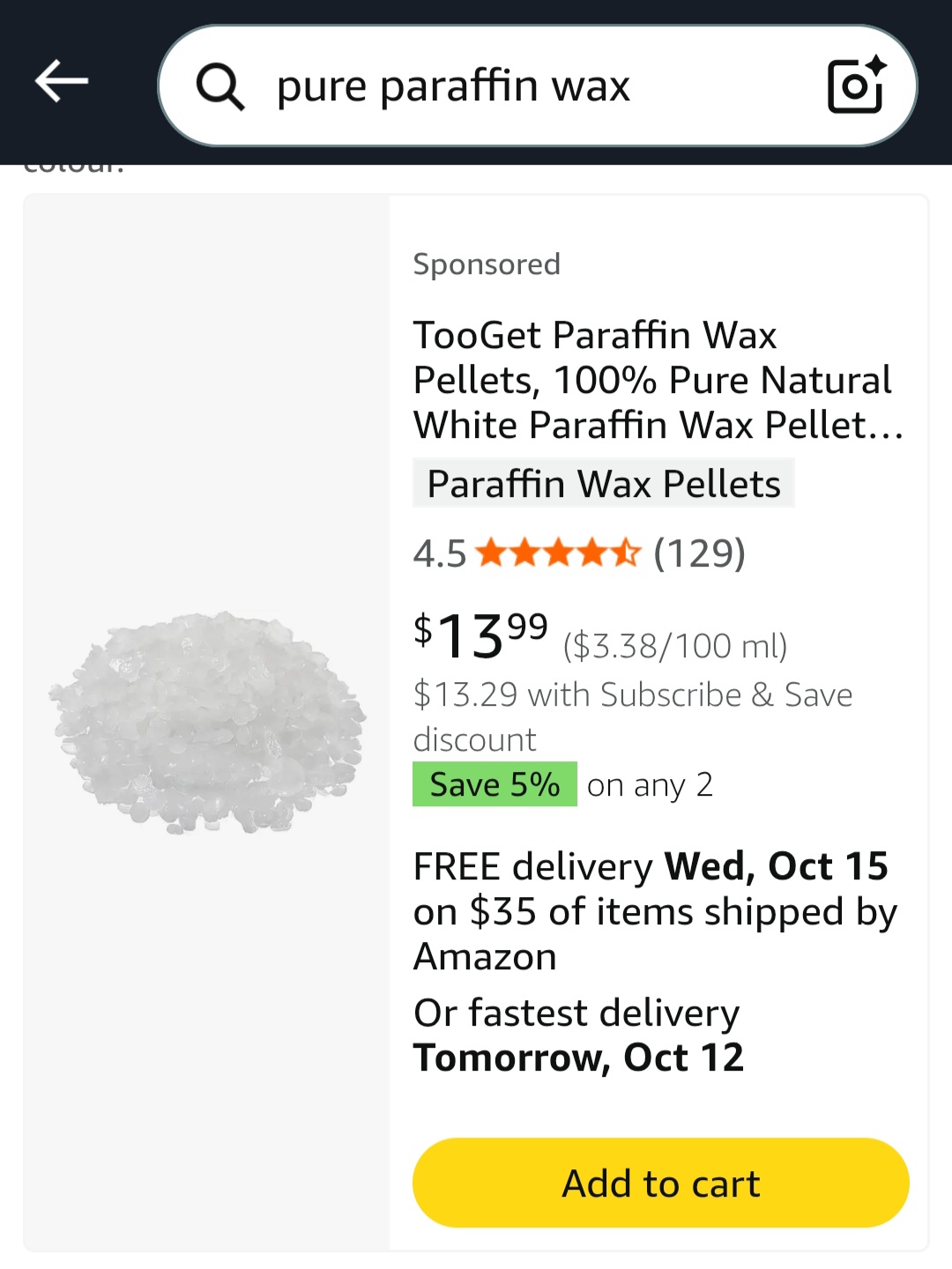

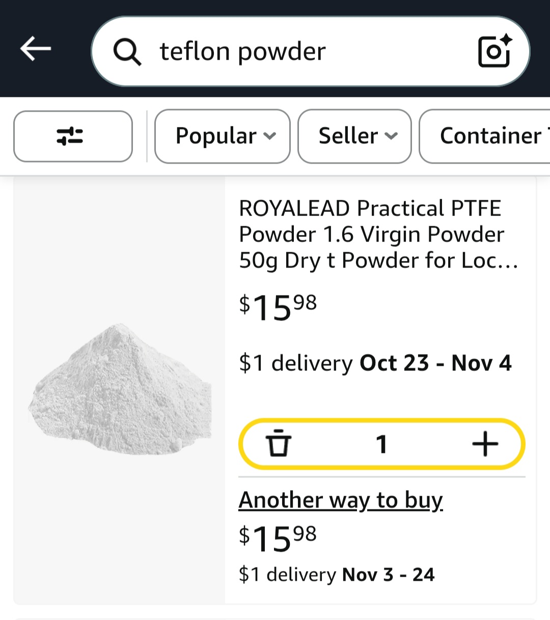

What some are doing and I plan to try at the next chain change is pure paraffin and some dry Teflon powder.
Ratio 50:1 respectively.
Soy wax is not known for its lubrication properties and has a lower melting temp than paraffin which can be a real problem in warm climates.
That said, I don't expect it to last a year as others suggest... Or for it to totally repel contaminants, especially in warm weather.

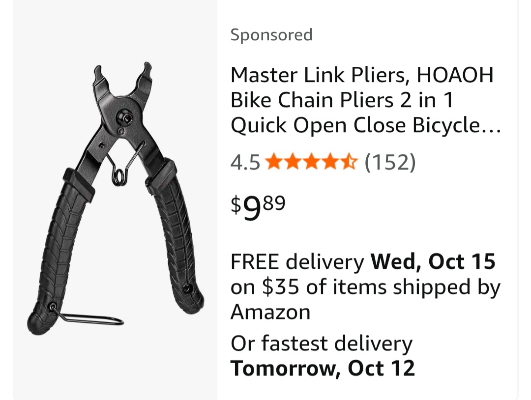

I had problems removing the quick link. (no problem installing it though)
A quick link tool was a must.

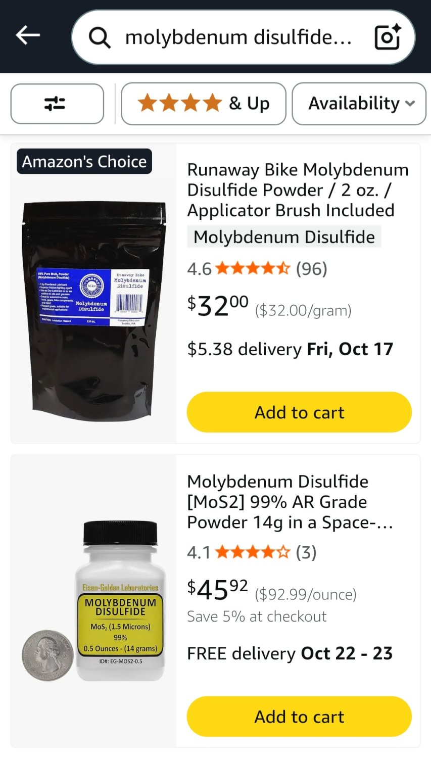

Your links didn't work for me in Canada, so I just searched Amazon.ca and bought some wax and Teflon powder.
My original bike chain wax has Molybdenum Disulfide in it as well, but it's $67 now and 2 ounces of Molybdenum Disulfide powder is $37, so I just bought the wax and Teflon.
It's a bike chain... I'm not going to gold plate it and then protect it with a coat of titanium 🙃
