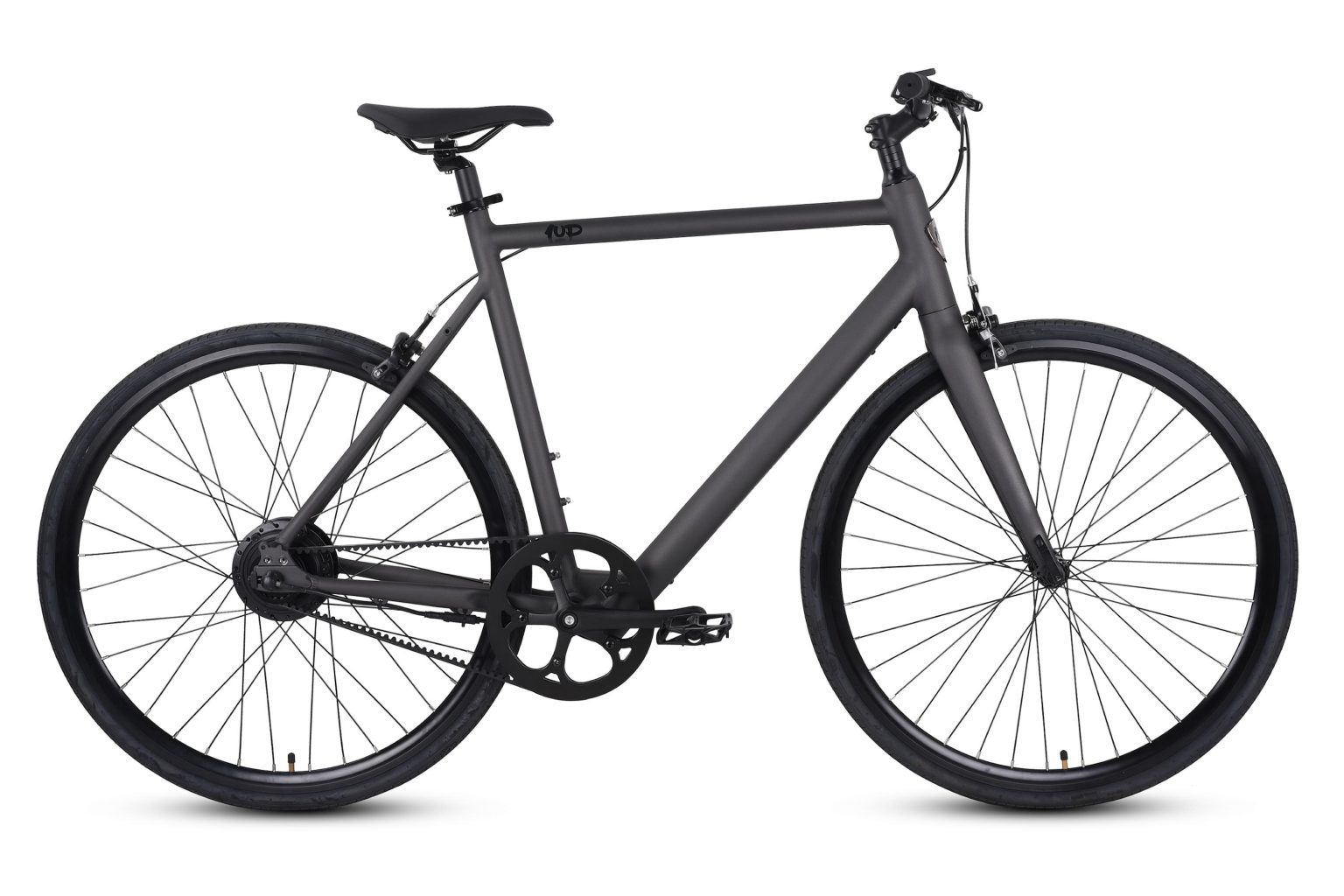

I'm not in the market but I'd ride this $1000 ebike any day without undue concerns
EDIT:
above bike also has rim brakes. It must be an unreliable death trap with both a cheap battery and no disc brakes.
No one said either was a death trap! Just perhaps ill-advised on some builds. BTW I limit my rim-brake build bikes to speeds under 15MPH. Appropriate braking speed for the rim brake bike's design parameters. Having tested all on an MSF course I know what my panic braking distance is. Anything over 20MPH on my bikes with Koolstop eBike pads makes for a situation and braking distance I'm not prepared to accept.
