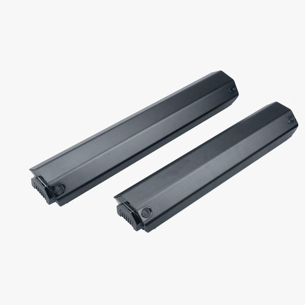

I have several days of looking for a empty battery case, with NO success,
the closest I came was this battery that had the correct end, (on the lock end),
but has a 5 prong Hailong battery connection and is only 36V.
I need a 4 prong and 48v,
battery overall case length is 17.375" long, 2.840" tall, 3.330" wide,
there is a step down that is 3.040" wide on the narrow side,1.190" tall, on the bottom step down section.
Useable inside space length is 15.125" long.
I have a female 3 pin charger connection at the Hailong end and a push button battery scale at the other end, has several colors, (but I can only see the Blue color).
This battery is shaped like this Apache battery case.
