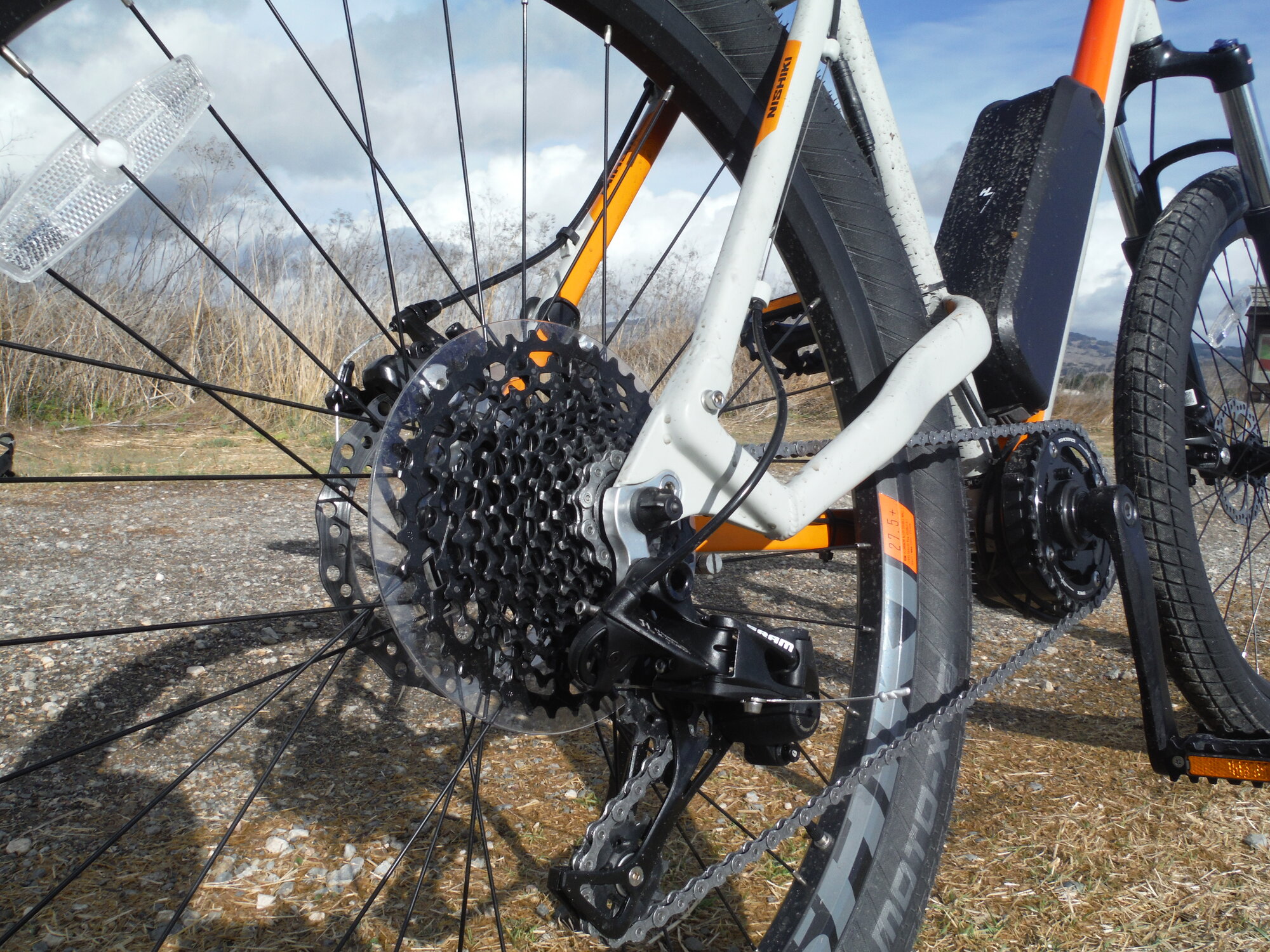

The Sondors Ultra shifter, derailleur, freewheel cogs all suck. The gears are made of cheese. Gear range is limited and the cage is short. If you upgrade these watch out. The gear sensor is way down under the battery and the motor packs a capacitor charge. The shift cable needs to be fed through that hidden gear sensor. Using tandem cable helps so you can make a big loop to make the bend.

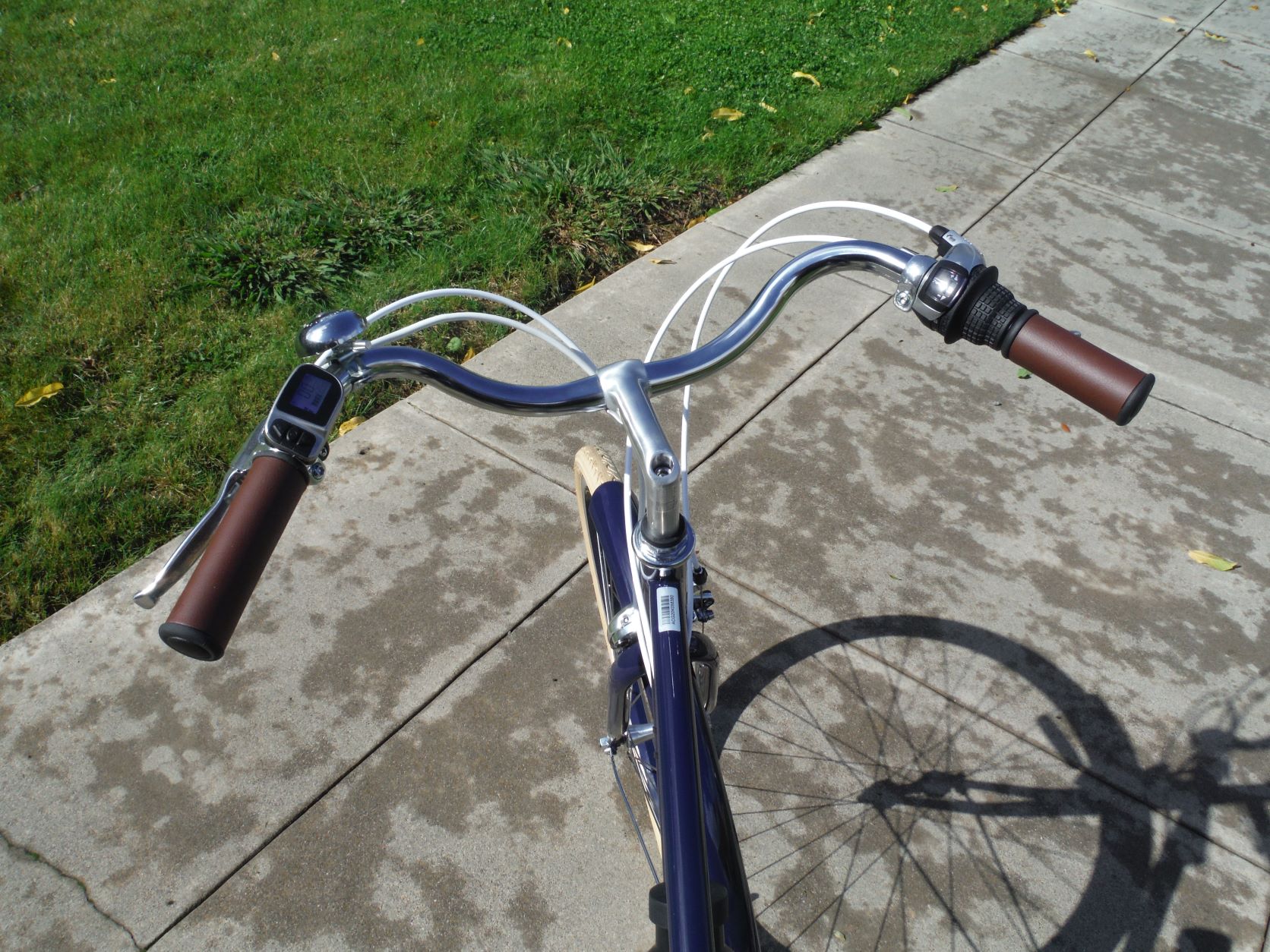

An additional issue, motor aside, is how BAD the geometry is on so many e-bikes. I've already reviewed the pedego element:
That bike had terrible geometry and therefore awful balance. I get that many e-bikes are being marketed to older riders who haven't ridden in a while. An upright riding position can be especially appealing, test ride or not, for an older rider with poor flexibility or a heavier rider who has trouble leaning over. However, the front wheel needs to be weighted properly or the bike is just going to flop over in slower speed riding.

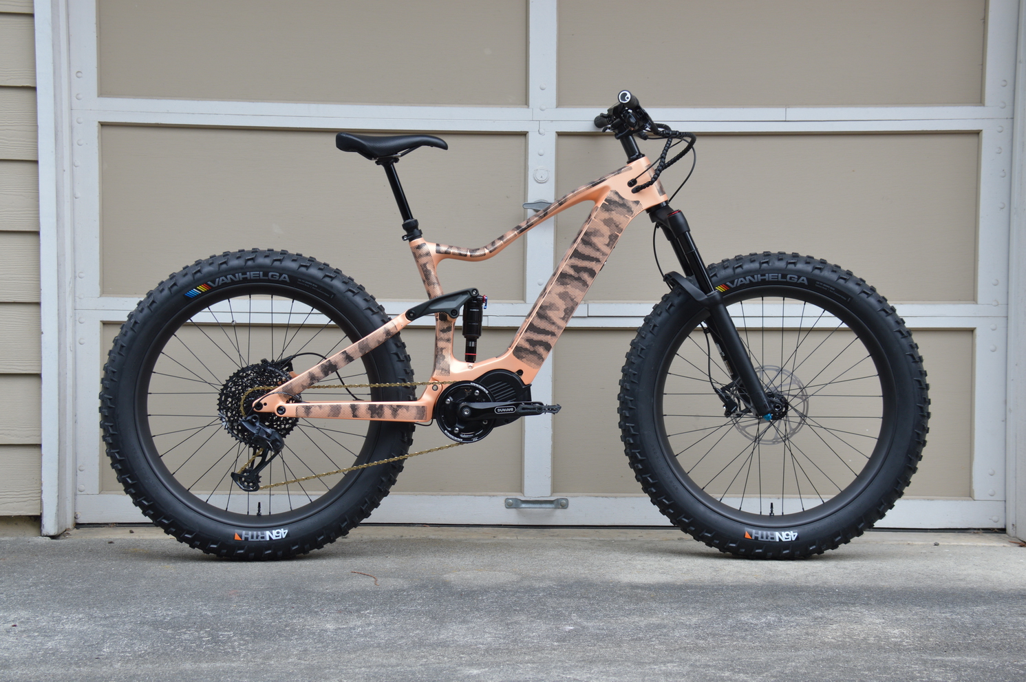

I’d love to see some Bafang Ultra builds that aren’t fat bikes. My use case is commuting/utility so I’m not really interested in full suspension or mountain bike geometries.
The closest I’m seeing to what I want out there is the WW UC2. There are also some nice Bosch mid-drive options out there, mostly R&M models.

This bike comes to mind....
I bought the Rx PRo which is the fatty version of that bike, which for my riding 'druthers (mostly paved) turned out to be a (expensive) mistake. Currently in the process of converting it to 27.5". Betting others will find this out the hard way as I did, and you'll eventualy see more of the Ultra based hard tails set up for street with 27.5" wheels....

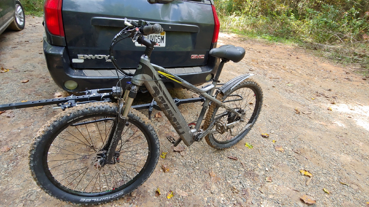

From what I've read, going with any of the 27.5+ sizes will be a good plan. Hybrid, dual sport, whatever you want to call them. I've converted my geared hub city bikes to 2.4" Schwalbe Supermoto's and LOVE them. Great ride with little rolling resistance, so anxious to try the Schwalbe Supermoto 2.8" on the Ultra bike. Hope is I can get the ride and lack of rolling resistance similar to the 2.4", without the bulk and self steering issues the 26" fat street tires suffer from. We'll see here in just a few weeks.

Recently upgraded to 2.8x27.
5 Schwalbe Nobby Nics. Awesome improvement in ride quality on the gravel and off road. Grip is very predictable in the wet.
And they were on sale for half off!

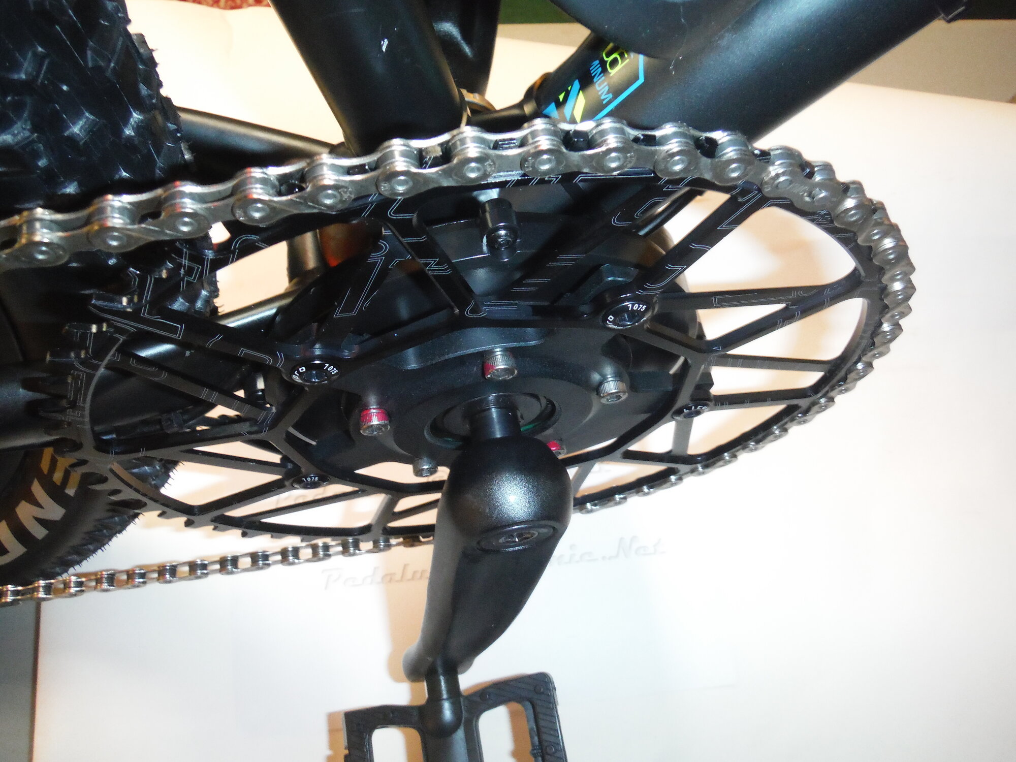

The asymmetrical chain stays were a problem on that bike. See how on the right it goes over the chain and not through it. I had to use a little chain ring or the chain would rub on the stay. It ate the small cog of the cassette quickly. I sold it to a contractor for $999 after zapping the charge port and stopped making heavy throttle bikes, except for a couple of HD's. It is all part of paying tuition. The bike after that had a 58-t chain ring! That was just as dumb in the other direction.
