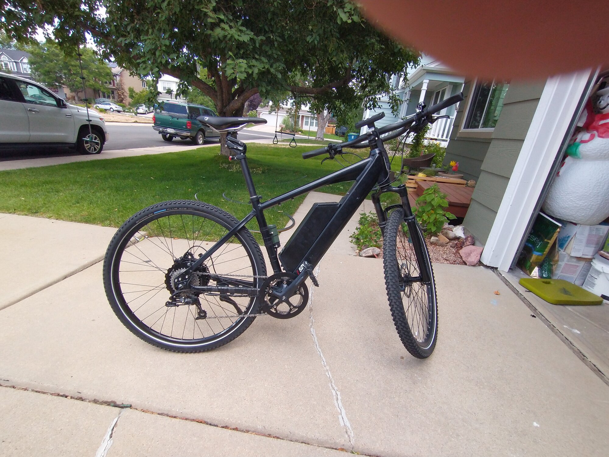

Another soon to be CCX owner, ordered it as a christmas present for myself.
I work from home so dont really need it for commuting (I agree its really well setup for this).
Im basically going to turn it into a gravel bike. I have never really understood the whole gravel bike thing as I think a rigid MTB is better for that
purpose. Silly road bikers trying to do something new! No offense to any road bikers, I did it for many years until I saw the light of MTBs.
Anywho, mods to the CCX will be
Gravel Oriented Tires (Surly Knard 700cx41 tires), some reviews show them at 46mm wide.
Going to try tubeless again (used it several time on MTBs and went back to tubes with stans due to burping issues eventually causing a bad crash, tubes/stans has worked well over 10 years i.e. no flats on my MTBs)
42T front chainring - lots of hills where I live and I find 42x11 works well enough, usually when Im going this fast its downhills anyways.
Remove Rack/Fenders/Lights - I want it as minimal as possible and have my own high powered offroad lights collection and rear lights
Considering a rigid front fork.
Basically this is going to be equivalent to my curent DIY speed pedelec 'gravel bike', a 94GT zaskar MTB with 52V TSDZ2 mid-drive conversion running opensource software,
rigid front fork, Conti Traffic 26x2.1 tires (width actually measures 46mm). While I like this bike alot, the TSDZ2 can be a little noisy and the mid-drive while
working up to 30mph probably isnt the most efficient at higher speeds.
I almost went with a 2017 Raleigh Redux IE or IZIP Moda(same basic bike) with brose motor which I can get locally for $2200. I LOVE the silent brose motor on my Bulls eMTB but want to go with the larger battery on the CCX.

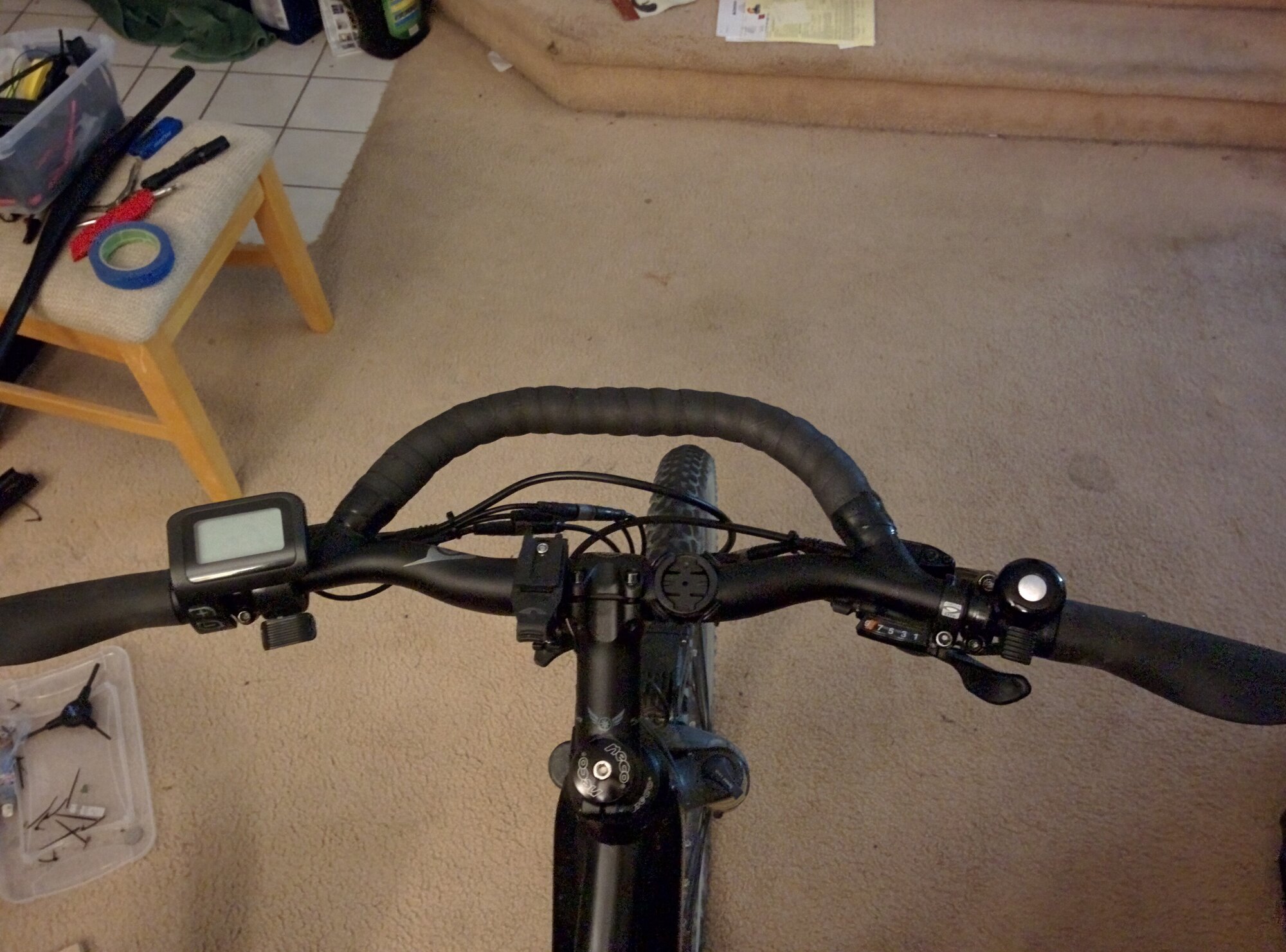

I installed a different handlebar(origin 8 strongbow) to allow me to get 'more aero' when I encounter brutal headwinds. 'Dramatic' improvement when needed.
I also needed a different stem since this handlebar has no rise, I finall settled on a salsa guide 100mm/25 degree rise stem

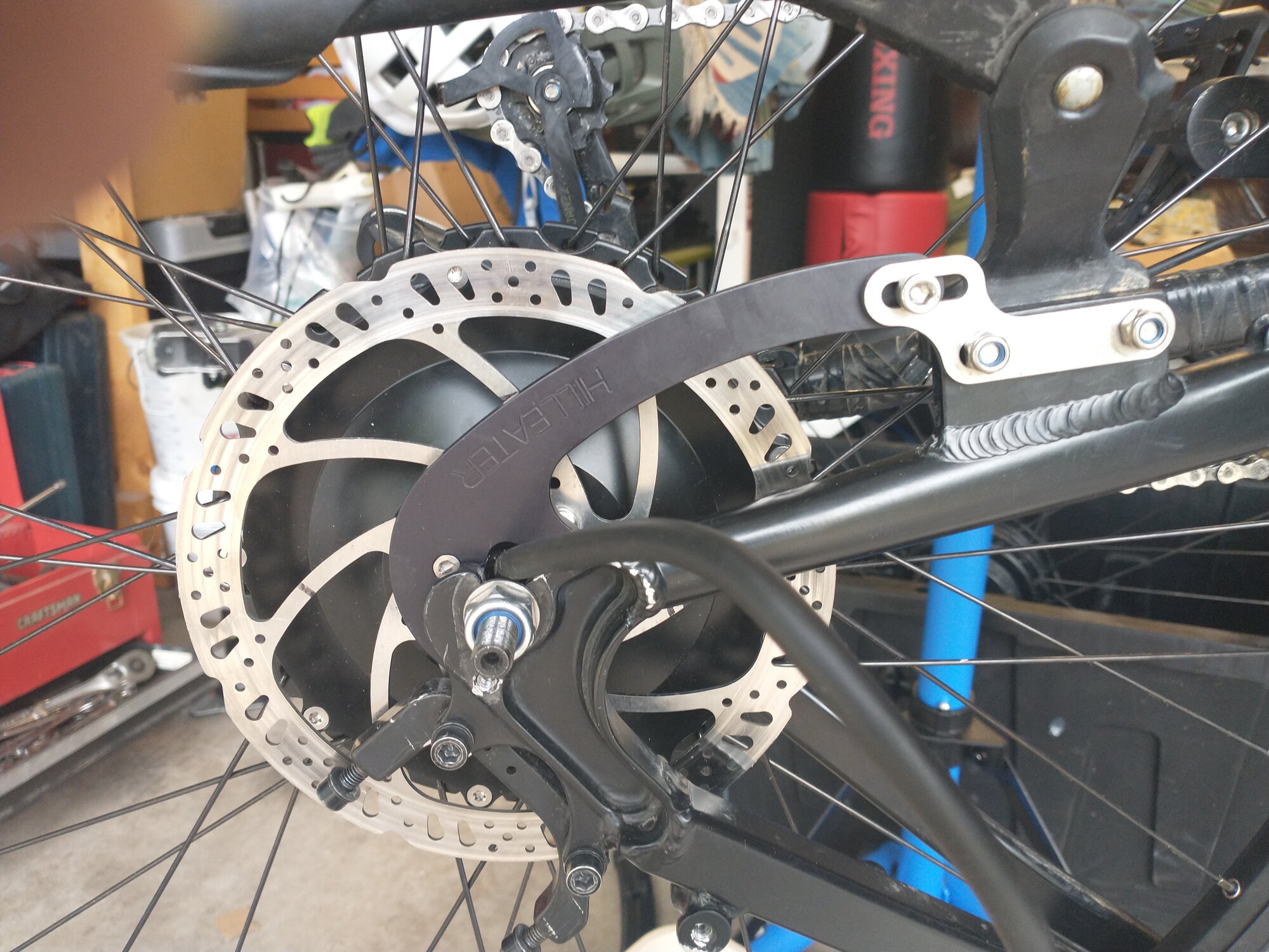

Went thru another set of rear pads. The stock pads (tektro A10.11 metallic) seem really hard to find in the US. Replacing them with organic pads (E10.11)
which are available everywhere seems like a safety issue given the speed capabilities of this bike.
I just bought a set of Tektro P20.11 metallic rear pads and replaced them. Turned out to be quite a fiasco.
The problem is, the pads just rub like crazy after doing the typical loosen caliber bolts/squeeze brake/tighten the caliber mounting bolts.
Even slight tweaing afterwards just doesnt work like on other bikes.
After literally 4 hours trying to get the pads not to rub, I decided to attempt fix the problems.
Its obvious that the caliber is not square with the rotor both by looking at the caliber/rotor gaps both front/back and side/side.
How they ever got a rub free alignment at the factory is beyond me. The wear patterns on the old pads confirm this.
FWIW, The rotor is very true probably the best of the 7 bikes I currently own.
Step1: Make sure that paint on the frame is not causing an alignment issue(it doesnt take much to have an issue). I removed the caliber and mounting
bracket from the frame and used boxcutters to carefully remove all paint from the frame mounting points. I saw an improvement but needed alot more.
Step2: Make the caliber square with the rotor. Decided the best approach was to put the mounting bracket(which is replaceble) in a vice and bend it
as needed with a wrench/pliers. The front and rear posts needed different tweaking but I finally got the pads to be square with the rotor.
HUGE improvement but a new problem emerged
As I tightened the caliber mounting bolts(with brakes applied), the caliber would shift inwards. I spent several hours trying to negate this and
nothing seemed to work (Im guessing something isnt perfectly flat). What finally worked was putting a feeler (0.762mm) gauge between the inside
pad and the rotor and holding the brake lever down while tightening the caliber mounting bolts. This works...just barely.
Another issue as mentioned before in other posts, the threads just seem badly threaded as if the taps/dies at the factory need to be replaced. After about 10 iterations of trying
to remount the caliber, I felt like I was crossthreading so I pulled out my tap/dies and cleaned up the threads and all was well.
So the bottom line is I got it to work after a solid 6 hours of troubleshooting (none of my other bikes have ever required this).
I will try using rotor spacers in a few days to see if this makes things better, perhaps moving the rotor farther out will allow for a more square caliber/bracket interface.

Here is a pic of the origin 8 strongbow handlebar cut down to around 700mm. It has a 17degree or so sweepback, no upsweep and the center section allows hand positions to get really aero. Many of my rides encounter winds up to 30mph and getting aero really helps. I did need a new stem as mentioned in previous post(salsa guide 100mm 25 degree rise).

Quite a fiasco with the rear brake getting it not to rub. As I have mentioned before I got it to work but it was barely adequate and not something I want to do often. FWIW, I have worked on /built bikes since 1994. Also played with cars at the track(turbo miata) so Im no stranger to wrenching. Im no ace mechanic but I get things done.
I have 5 other disc equipped bikes and none have this issue.
The problem seemed to be when tightening the rear caliber, the caliber would shift inwards..it would actually 'pop' into place. I finally got it to barely work with a feeler gauge in between a pad and the rotor while also applying the brake lever while tightening the caliber. I was worried, it would pop while out riding so I wanted to fix the issue.
I 'speculated' that shimming the rotor out 'might' solve the problem so I bought some 0.2mm disk rotor shims.
Got the shims yesterday so decided to try them.
Unbolting the rotor revealed something horrendous ...several of the bolts were actually bent. As such removing them pretty much ruined the bolt holes and you could see big aluminum slivers on the removed bolts. In addition, the bolts were shorter than typical m5x10 rotor bolts at about 8.5mm to account for the shallow bolt holes in the hub motor (holes were about 9.6mm). The rotor is about 2mm thick. Not much room for thread engagement in soft aluminum.
I had some existing m5x10mm rotor bolts so I paired them with 2 0.2mm rotor shims for a total thickness of 0.4mm. I was able to bolt all this up but 3 of the 6 bolts (with blue loctite) were basically stripped. That being said, I bolted it all up and adjusted the calibers and BINGO, it worked well. Easiest caliber alignment ever for this bike.
I decided to check the threads on the removed bolts by running a die over them and the stock threads were just garbage, the term 'horrendous' comes to mind.
This is of course, not safe so I decided to fix the stripped holes with helicoils.
Initially tried to use the existing hole depth and it was just too shallow to get a helicoil to work. Hard to go into all the details, but after trying 5 different things(and 10 inserts) I decided I needed to disassemble the motor and drill the holes thru the hub to have enough hole depth.
Disassembling the hub motor is pretty easy but you need torx security bits (basically a torx bit with a hole in the middle). Luckily I had these so I disassembled the motor. While seperating the motor/a shim(15mmx19mm.0.2mm) used to preload a ball bearing was destroyed (see video by grin technologies when they disassemble a bafang).
This video gives a good descriotion
Once I seperated the motor, drilling the holes thru/tapping and inserting the helicoils was pretty easy although I did have to modify the plastic insertion tool with a dremel for clearance. as there was a step that wouldnt allow the tool to sit flush.
After all that, helicoils were inserted super easy. Had to be super careful to make sure no leftover metal fragments to get caught in the gears.
So the only thing left at this point is to get yet more rotor bolts (many were ruined while doing all of this). get some lithium grease to relube the gears and find a replacement for the destroyed shim. Luckily there appears to a shim that will work used in the RC car industry (15mmx18mmx0.2mm).
So, basically waiting for lithium grease and shims, will update once I get those.
I received the shim and lithium grease and got it all put back together.
For future refencence, the shim is "Axial Racing AX31269 Shim 18x15x0.2mm" I got mine thru amazon.
Adding new lithium grease did quiet the motor a bit.

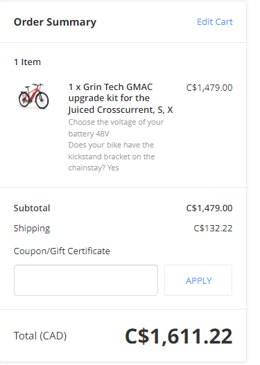

Well its time to sell the CCX since I did a DIY build with a GMAC motor and it just rips, 4 ebikes is too much even for me.
Been almost 2 years and about 4200 miles trouble free miles in conditions it was never designed for (mild offroad gravel rides).

I never liked the stock CCX grips which always caused the outside of my hands to go numb, so I replaced them with Specialized Countour Grips in the largest size. I spent a month or so trying all kinds of different grips(8 pairs), finally settling on the specialized grips
I too replaced the stock bars with a wonderful origin 8 strongbow. The inner grips really do cut down on wind resistance greatly especially when cruising at higher speeds. I seem I'm not the only one who prefers to tuck the throttle under the controls. I find the only time I'm using the throttle is to get off the line when crossing or riding in traffic so this works better for me. Picked up 2 CCX for my wife and I and couldn't be happier yet so far. Only was able to put about 400 miles of mixed riding on it before I stashed it away for winter.

Not much more to post these days since I dont own the bike anymore but the new owner has done quite alot of upgrades for its mostly gravel oriented riding.
Shock Upgrade to Rockshox Recon 100mm fork
Shimano Deore M6100 brakes (no brake cutouts, the new owner hated these on the stock CCX just like I did. Might not be a good idea depending on your skillset.)
GMAC kit from hilleater.ca
KInekt Seatpost
SRAM 9 speed x5 mid cage derailler and shifter (the stock CCX shimano altus derailler is horrible at maintaining chain tension)
I am 'very impressed' with the Hilleater GMAC kit. All the wiring is plug and play and makes for a pretty clean setup. I especially like the Hilleater replacement torquearm and bracket to bolt it to the kickstand mount. All the cycle analyst and frankenrunner setup is already done. Installed by someone new to working on bikes (although I provided alot of assistance) in less than half a day (including new brake replacement/installation which had several issues).
Need to figure out a more elegant frankenrunner mount (not sure the grin solution will work for the CCX). Will probably convert to a phaserunner in the long term.
The bike initially had some surging which got worse with higher cadence. The fix was to add a spacer between the motor and frame on the drivetrain side to gain more cadence sensor clearance

Hilleater GMAC kit. Did you pick up in Canada? Site shows no shipping to USA in cart.
