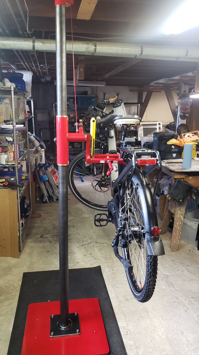

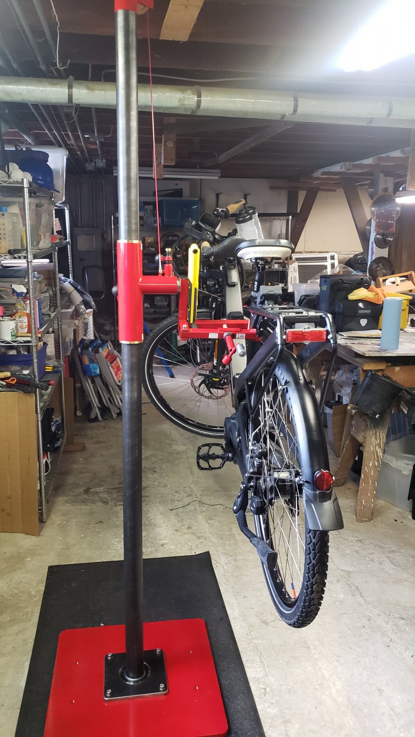

I just splurged on the Efficient Velo Tools counterweighted work stand made in Portland Oregon. The bike is clamped on while it is on the floor and then the whole mechanism slides up the pole with a pulley at the top of the pole and a 30 lb. counter weight inside. The base plate along weights 135 lbs. Cost as much as a good Chinese ebike but if it saves injury to me or damage to a 65 lb. Riese & Muller it is worth it. https://www.efficientvelo.com/tools/ez-lift-repair-stand

Amazing tool! I posted about it a few years ago.
I've never seen it in person. Hope you can do a dedicated review at some point.

Wow. This looks amazing. A bit too much for my use as I only want it for cleaning and lining. I am not mechanically inclined to perform other works.
