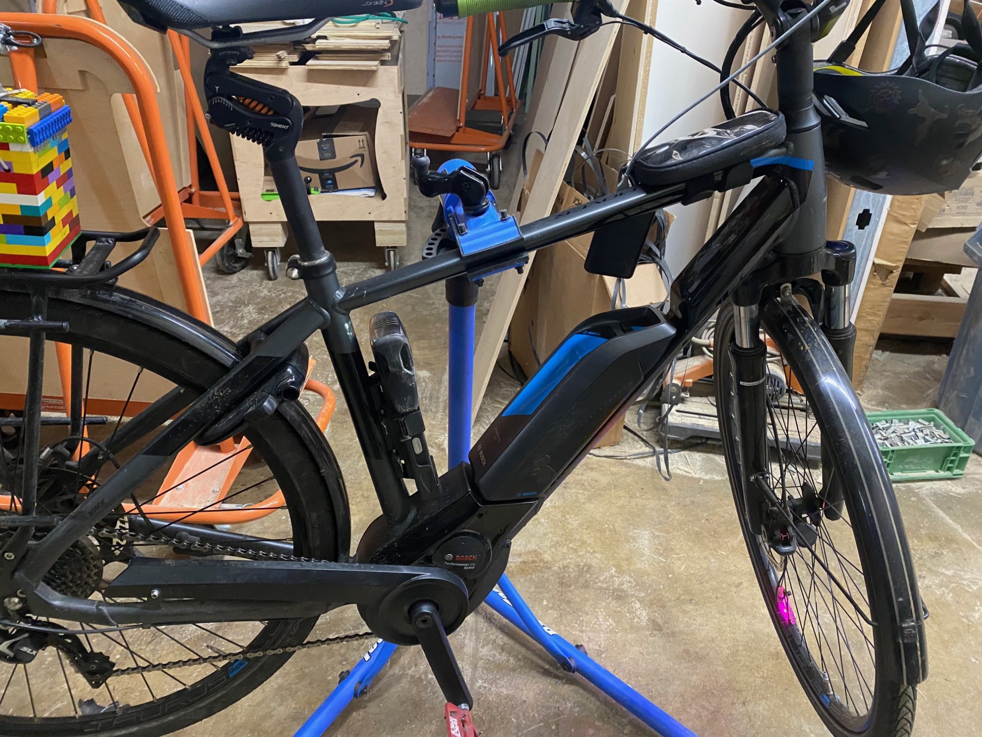

@martee1z have you ever mounted your bike using the top tube as opposed to seat post?
Opinion?

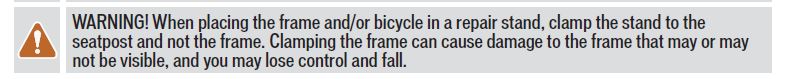

I used the top tube the first time I mounted the Vado to the PRS-25 stand. But then I did a more thorough read of the Turbo/Como User Manual that came with my Vado. On page 8 of the manual, under "6. GENERAL NOTES ABOUT MAINTENANCE", one of the WARNING! statements specifically says:
After reading this warning, I started using the seat post as the clamping point. But each to his/her own.
Good point. How about when we place the bike on the bike rack. Could that then cause issues? Your thoughts?

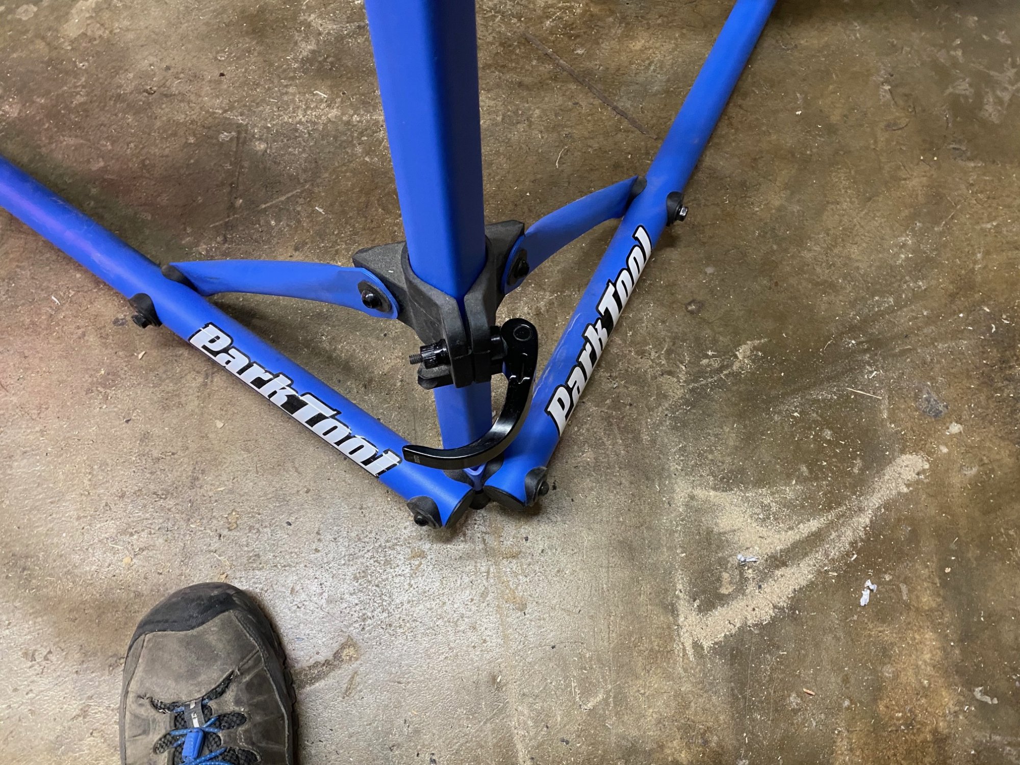

I got this on Amazon because of the 4 wide legs and the weight limit. I think it is Yaheetech or something and only about $53.00339414B3-E425-43E5-BC82-DDC59BADD3DE.png
Got this from Park Tool about which one of their stands is good for Vado:
The PRS-25 would hold it up for cleaning and lubing the chain. No portable stand however will permit the bike to rotate all around like a non-ebike would.
Opinion?
The Vado manual says somewhere that the only place you should clamp to is the seat post (as opposed to seat tube or other frame member). However, if you are clamping on the top tube at a point where the bike is balanced and you aren't planning on rotating it, I would think that you could clamp it with minimum force and be safe.

Currently I have no need to rotate my bike on stand as I am using it for cleaning and lube only...may be in future.
I see the warning in the manual. I will not be using tools to push and/or pull on the bike for repair. I will not be rotating the bike either. I will be washing and/or lubing only which does not require much torque.
I mount my bike on the bike rack using the top tube with all the vibration so if any issues that is going to be the culprit.
I think you got a wonderful stand in the 25. And the pics you posted (all of them, including the top tube mount) is how I've used my stand on many bikes including friend's bikes. That reminds me of one real issue, when friends know how much easier it is to work with a stand, your 'shop' will get popular;)
