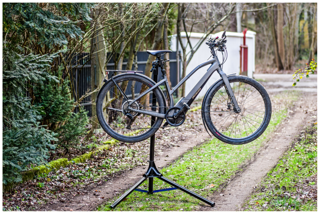

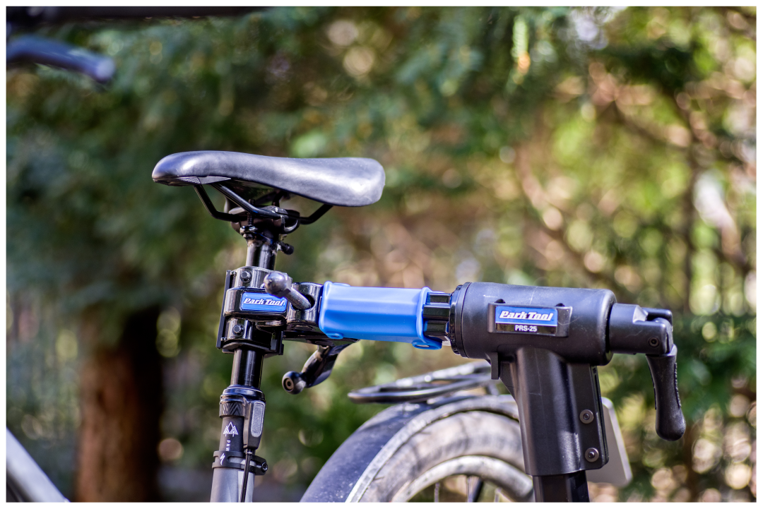

The Park Tool PRS-25 in my practice 😊 Vado --even without the battery -- is a heavy bike but everything is doable. Thanks to all who made me want that stand!
In near future, I will take the wheels off, replace inner tubes and wash the Vado thoroughly!
The bike can be rotated!
Please let me know if you use a work stand for cleaning and repair of your ebike?
