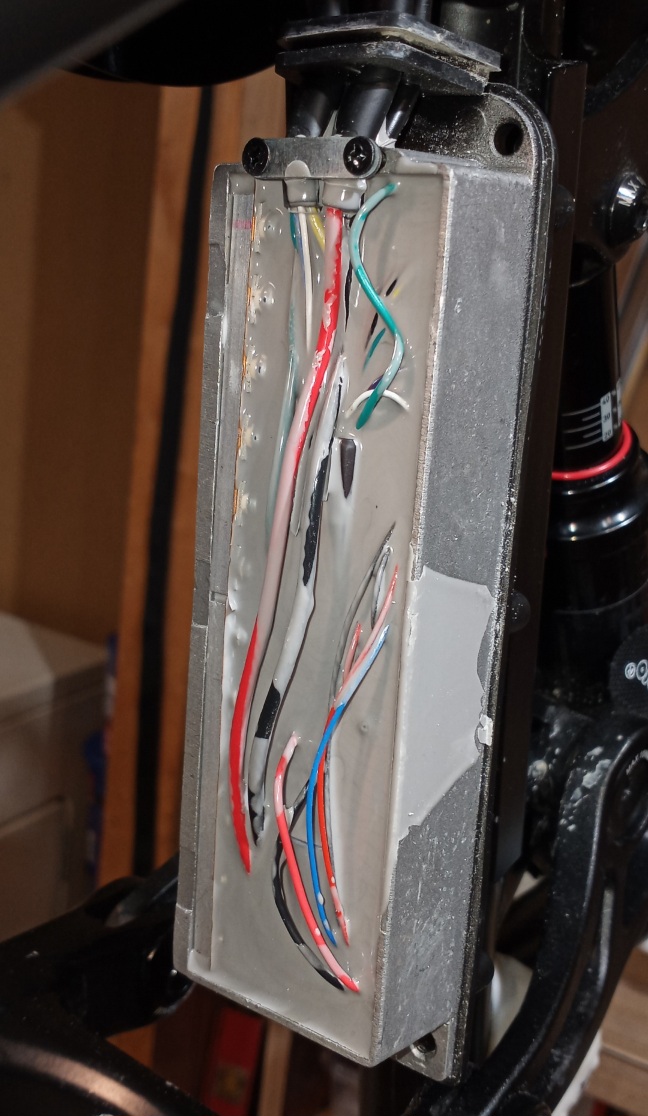

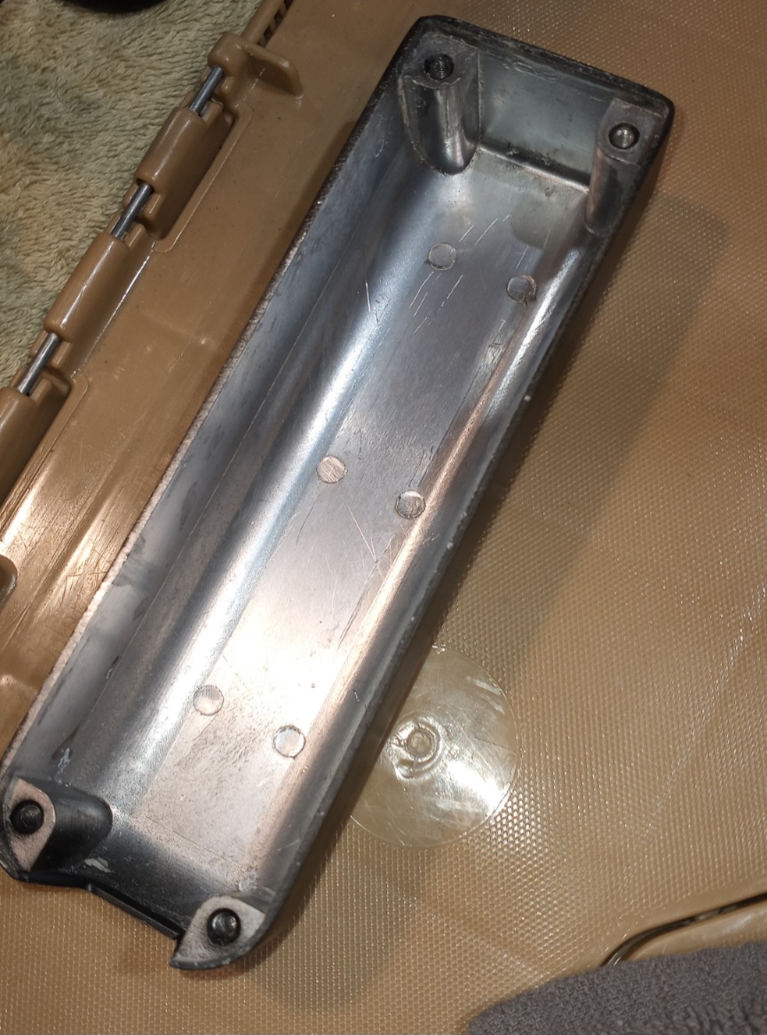

			There was a white pasty substance that looked like permatex teflon paste used to seal water pipe threads between the controller and mount,.. Another fella said it was used to transfer heat to the frame from controller.

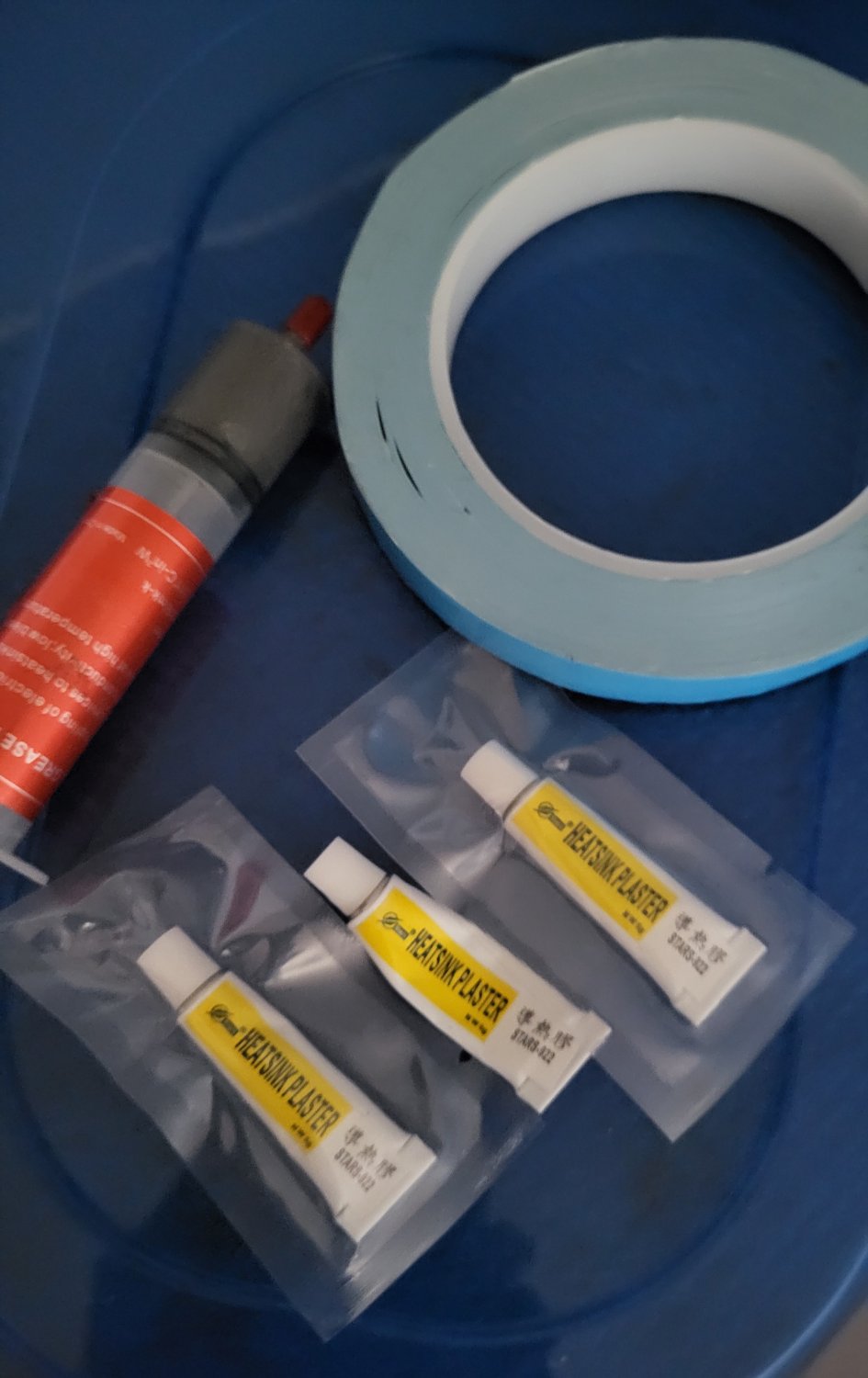

Ah. That is what it was then. Thanks for the info! I wasn't aware there was such a thing. Looking at the thermal conductivity of that stuff is like .671-4.8 w/m-k. Copper is 385-397 w/m-k and aluminum is 205!It's most likely heatsink plaster,..
It's specifically designed to conduct heat but Not electricity.
Most things that transfer heat also conduct electricity.
The plaster is safe to use to remove heat without shorting out any wires or conductors.
They also have heat transfer tape and different colored heat transfer "grease".
I also ordered some silicone heatsink glue to glue things in place, but I was sent the same type of paste. It doesn't cure and harden up like I was expecting.

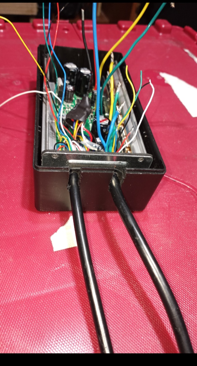

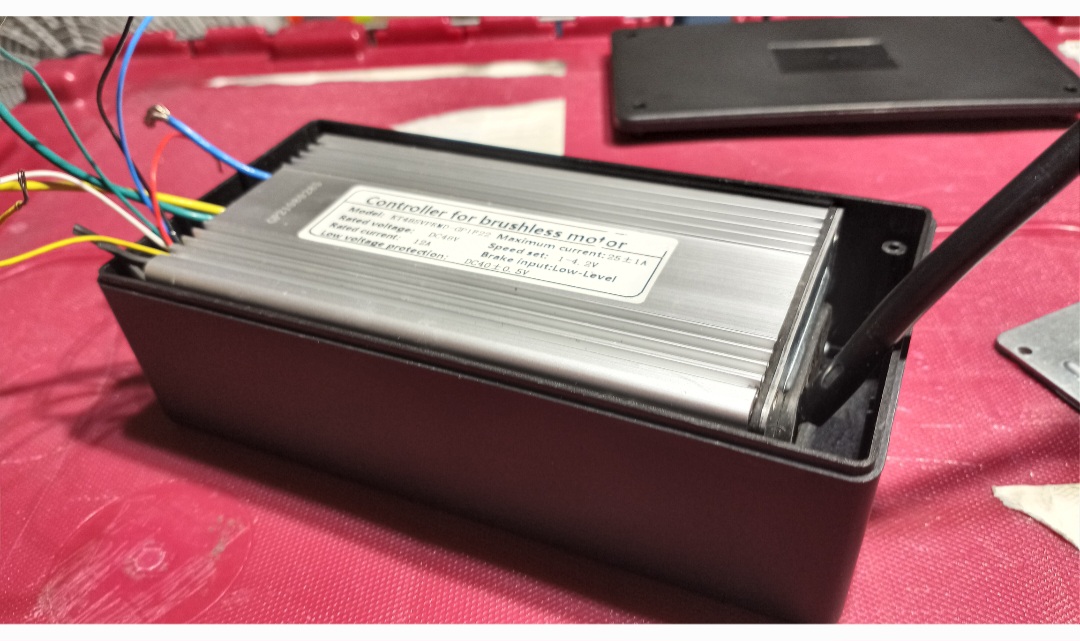

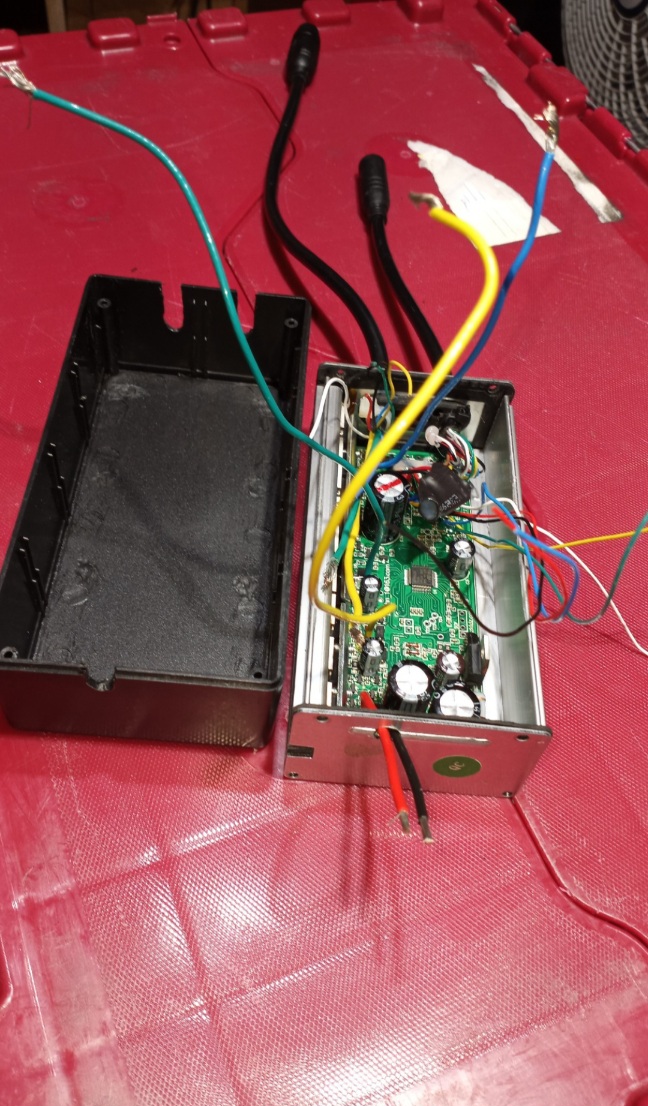

Interesting, thanks for the info. Hadn't thought to google it. Just finished putting it all back together, the more times I do this the better I am at getting the wiring routed better and in the right places. I did use the copper paste, don't know if it is going to make a whole lot of difference, the bottom of the controller is anodized and it wasn't coming off with the effort I put in, but the inside of the box was bare aluminum.

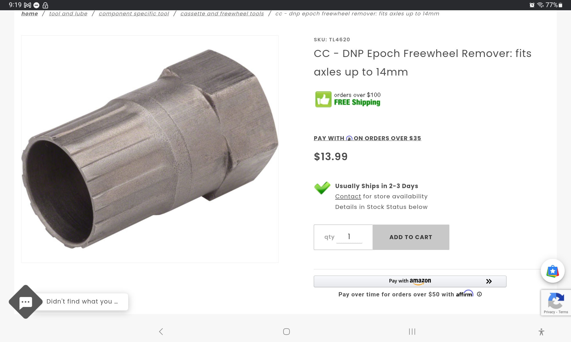

				I'm not positive but I think that's a freewheel not a cassetteLooking for a tool to pull this cassette off. Think this is the ring that needs to be removed. It is 6 prong, can't find any. About 1.3" i.d. at the inner prong cutout.
