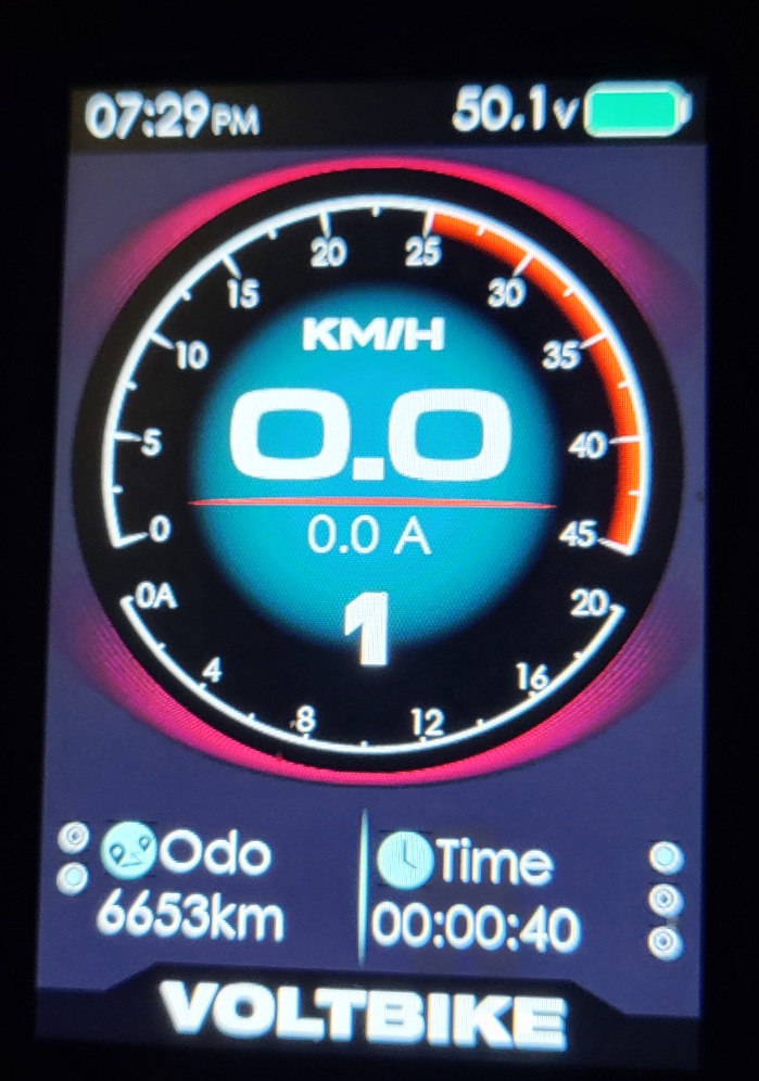

My ebike has over 6600 km on it with more than 5000 km riding no-hands at 20 mph.
I only grab the handlebars when there is a vehicle nearby.
I can ride for ½ an hour without having to touch my handlebars.

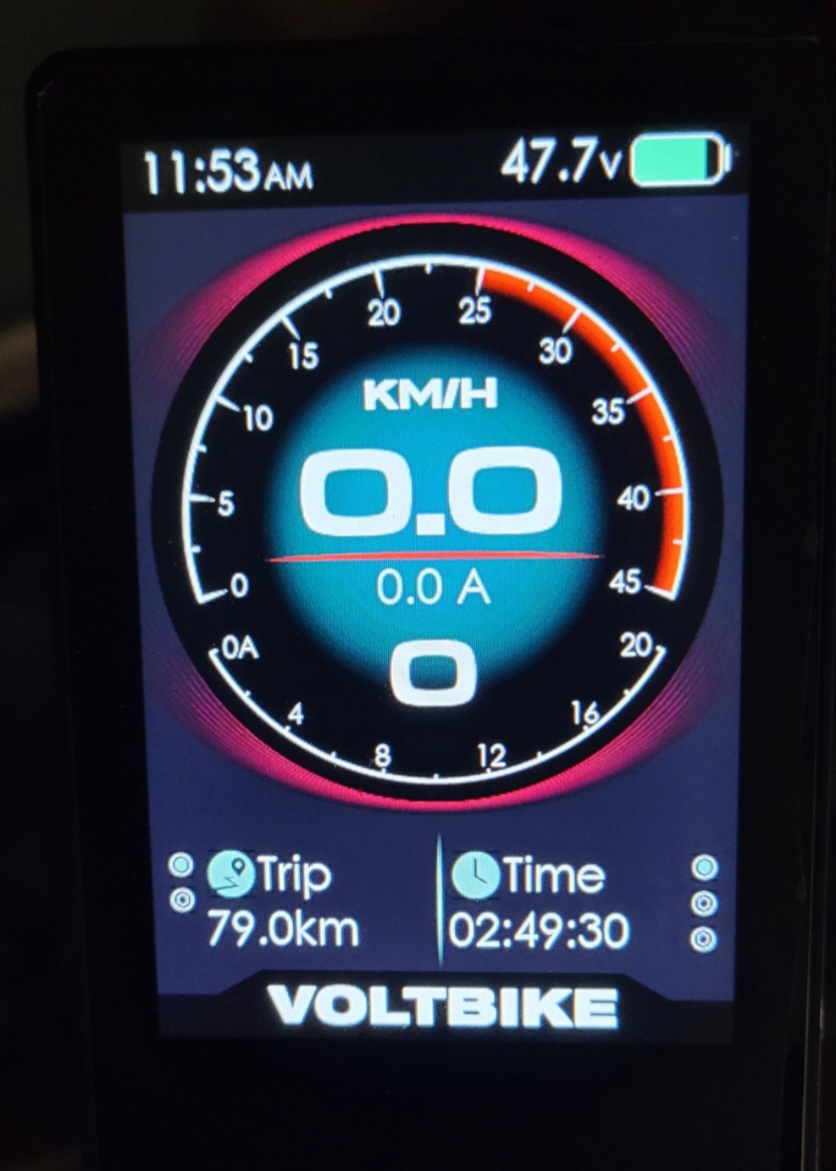

I had tons of battery left on my second battery after a 79 km ride.

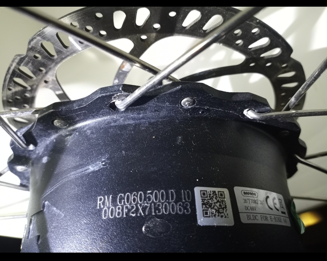

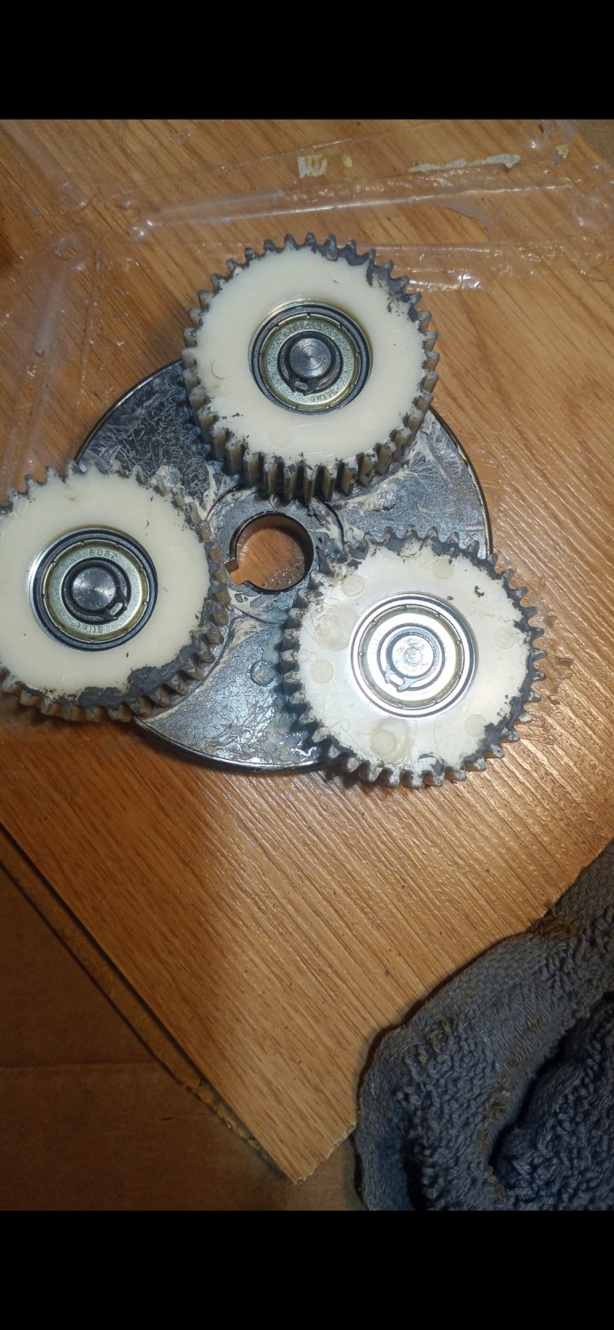

Yup. H550 (G062) geared rear hub motor. Is that what you meant, Mark, or were you asking if it is an IGH (internally geared hub, as in it shifts internally) … which it is not.

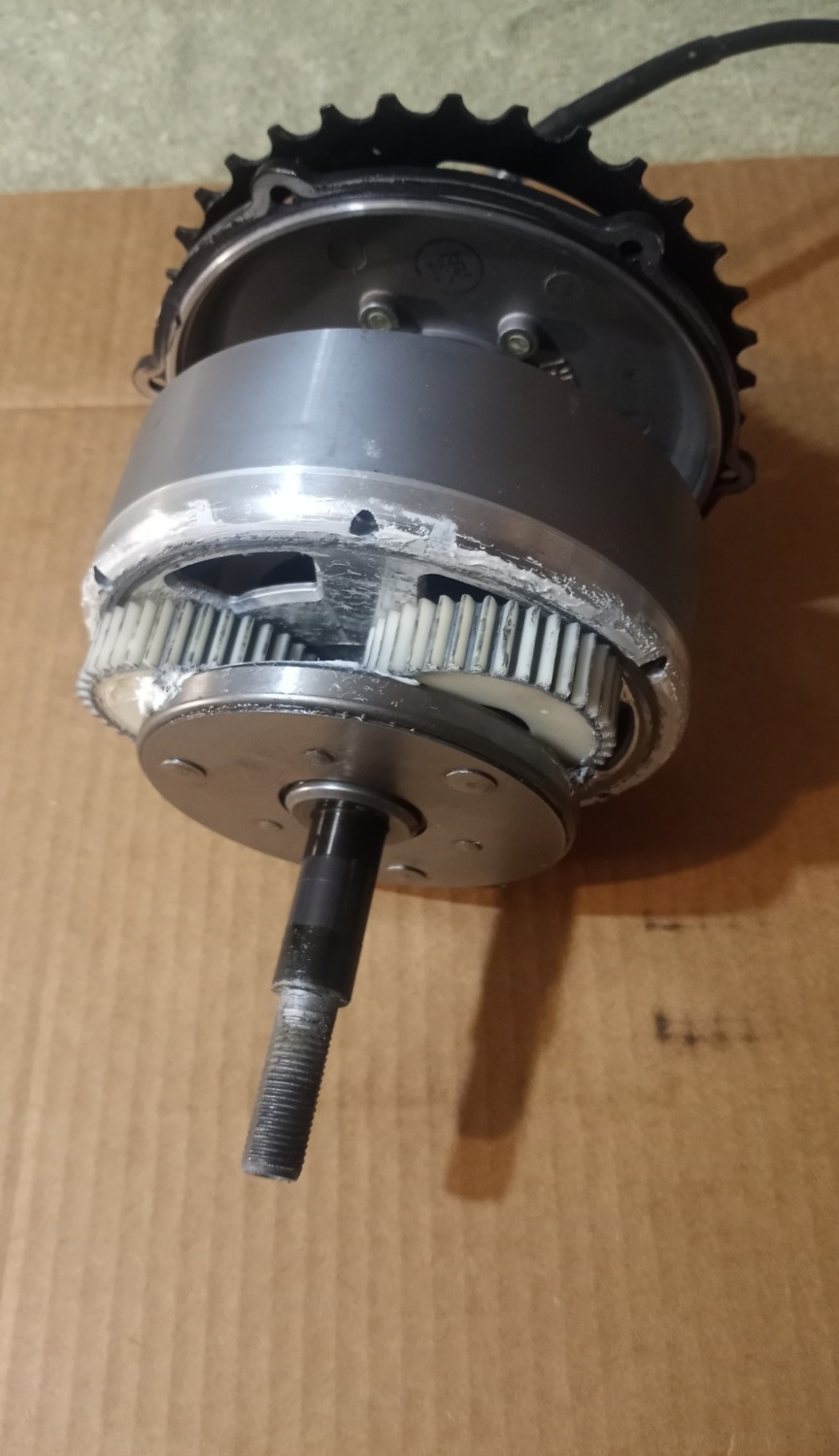

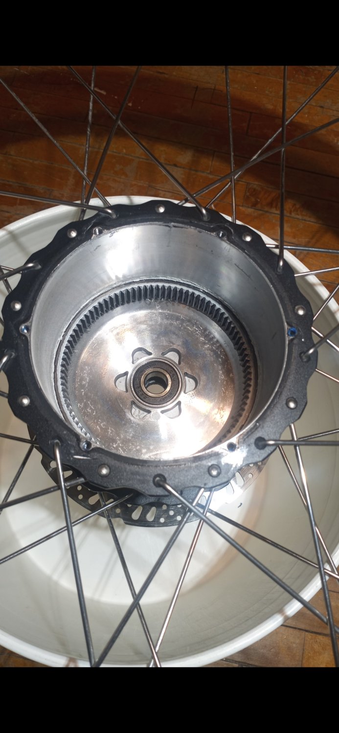

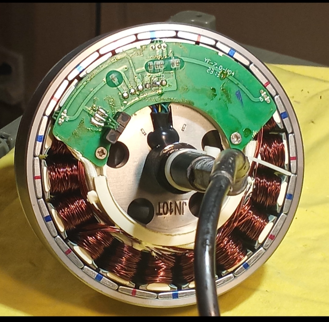

I've got a Bafang G060 geared hub motor on my Voltbike.

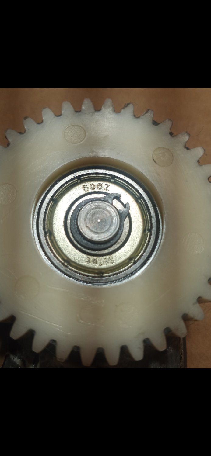

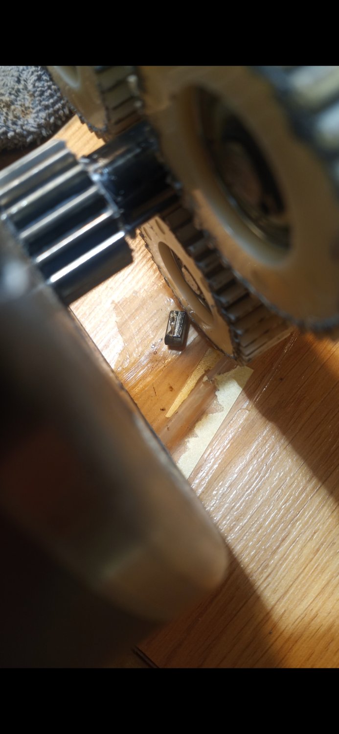

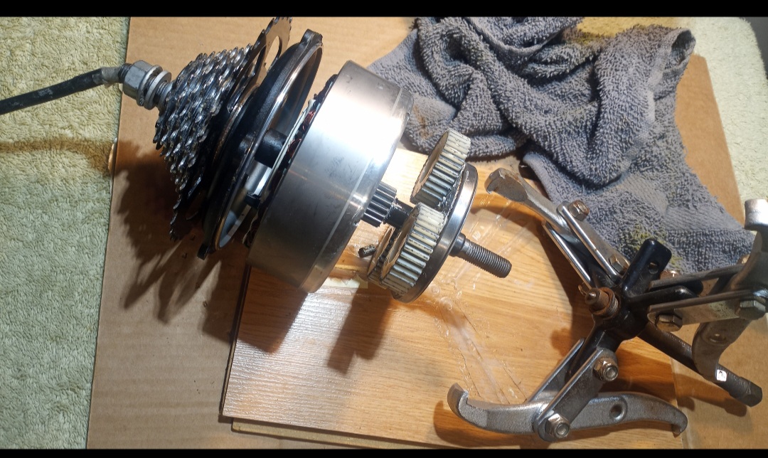

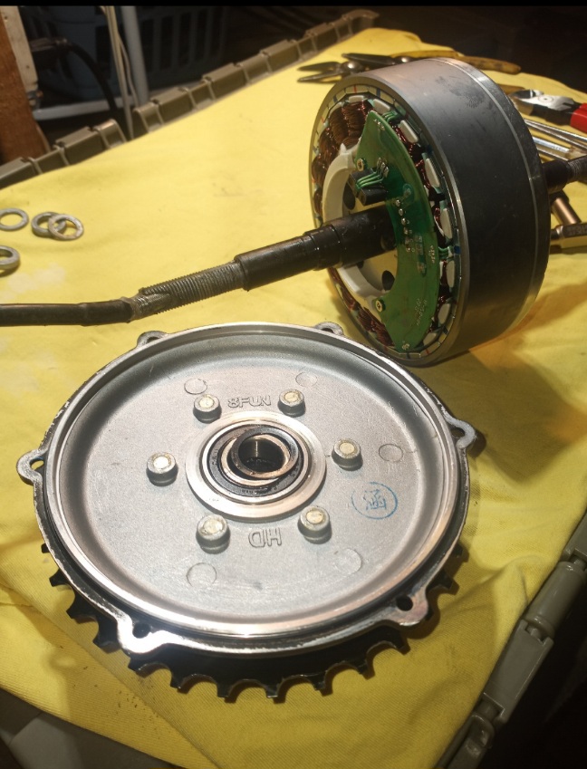

Here's some pictures of the gutz. 😁

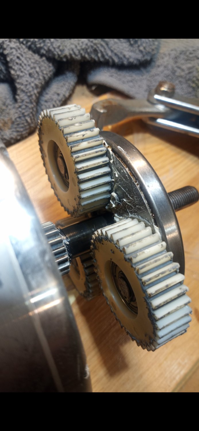

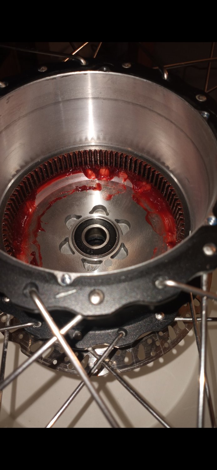

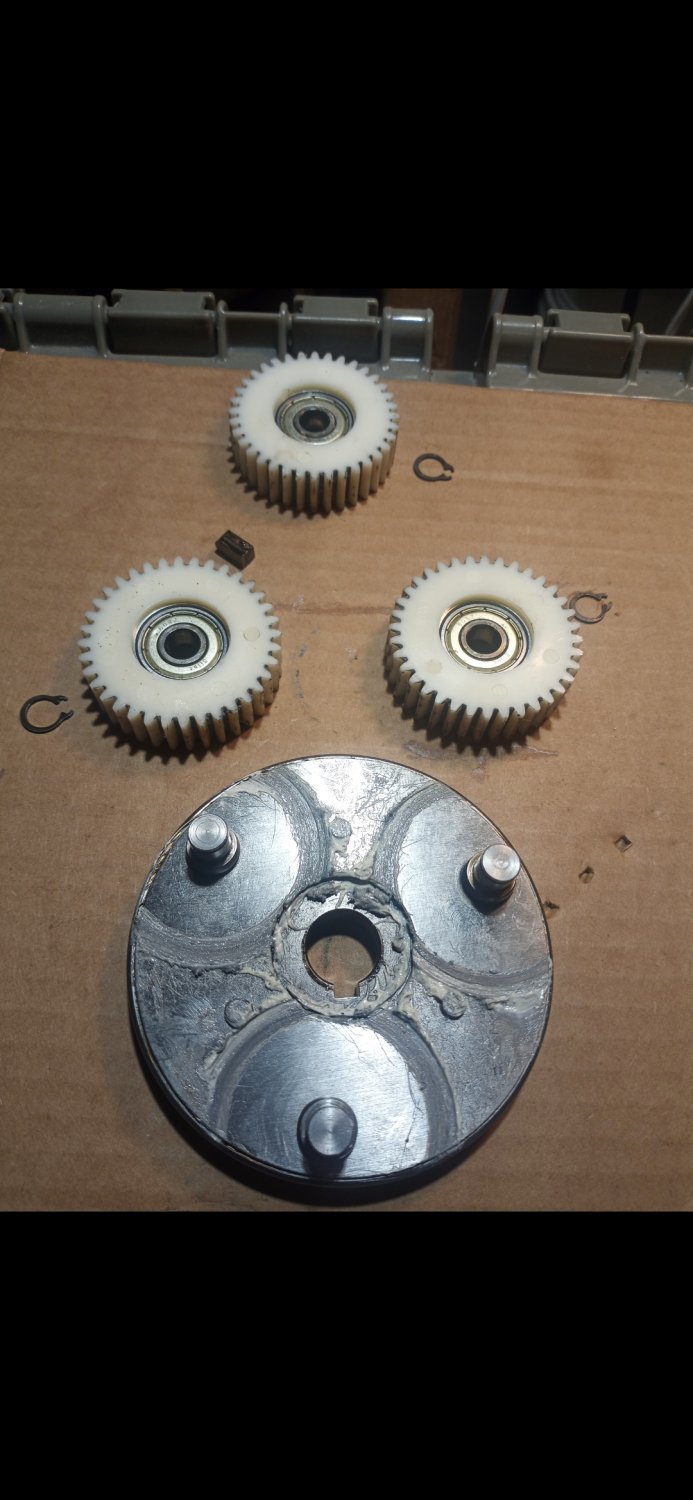

Thanks for the pics, how often you do a tear down and regrease?
Every year.
Winter project.

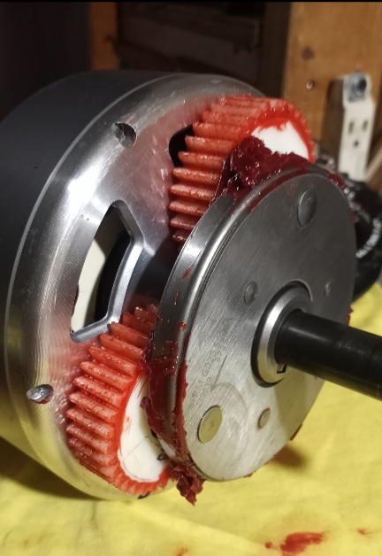

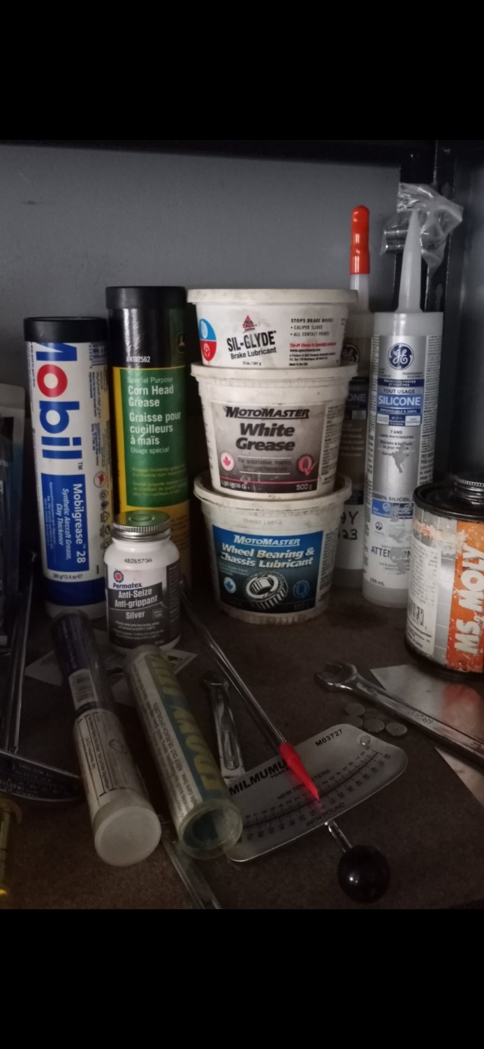

There's Mobile 21 Airplane grease (the red stuff that cost me $50), and John Deer Corn Head grease (cost me $12)
I think stay away from the White Lithium Grease. It evaporates and turns Really sticky.
Nothing left but sticky goo after a year.

The original white grease was like plasticine.
Remember that stuff from school as a kid?
Sticky Clay type stuff.
Not very efficient and it would heat up from the drag.

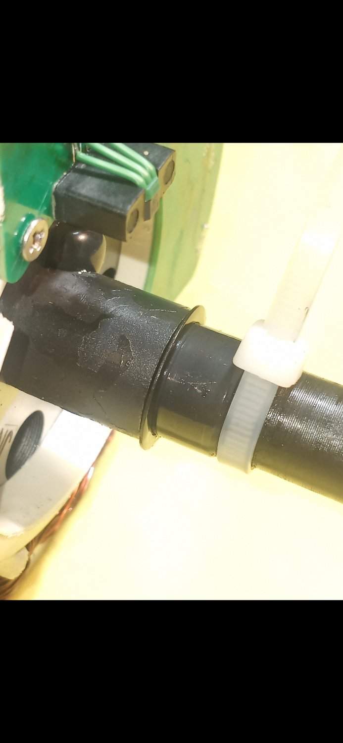

There's a critical shim washer on the axle that I didn't want to lose, so I put a zip tie on it,..
If the shim washer isn't there, the bearings won't be centered and they would bind on the races.

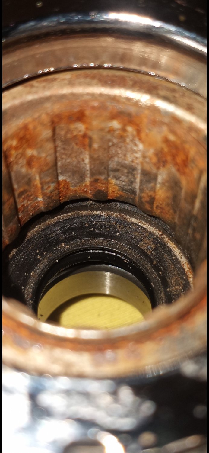

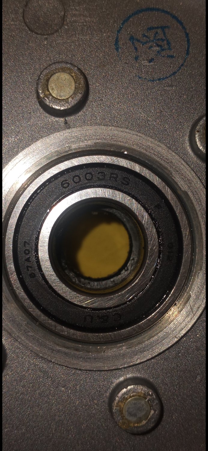

The freewheel was Rusty AF, but no crap got past the bearing and into the motor.
I realized that grease below the toothed ring gear wouldn't get inside the spinning core, if it was below the ring.
I caked it in there, then spread it out.

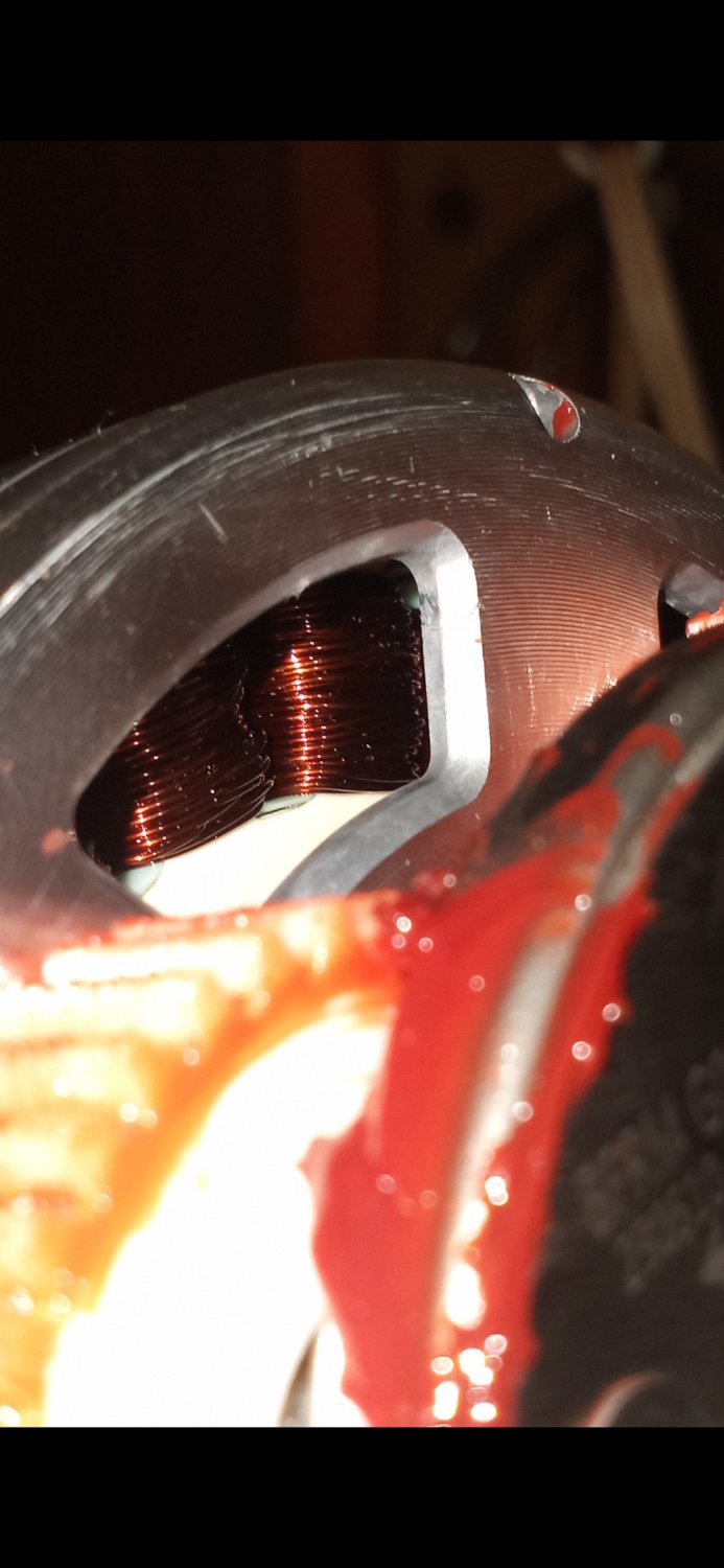

Grease can fling off the spinning gears and into the inside of the motor through the holes in the motor core, and some white lithium grease did.
The magnets are Very Close to the motor core and grease can drag one tge magnets and heat up.

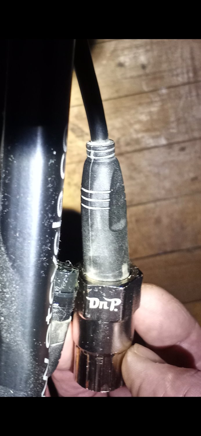

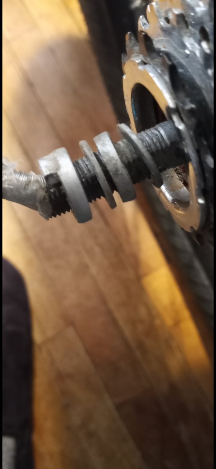

I bought a new freewheel to replace the the rusty one.
And a Hardened Steel freewheel remover with a big enough opening to fit over the extra large 750 watt motor plug connector on my first ebike.

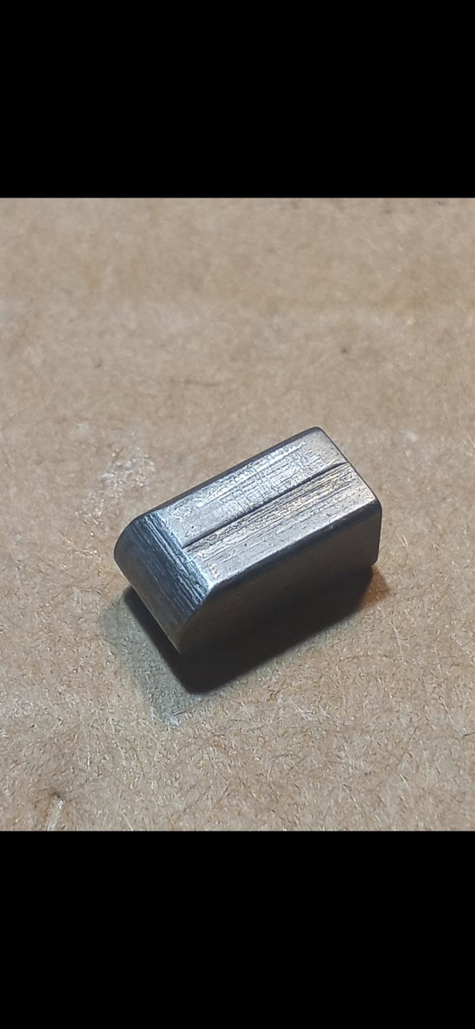

Don't lose the Magic Woodruff 🔑
It's very special. 😁
