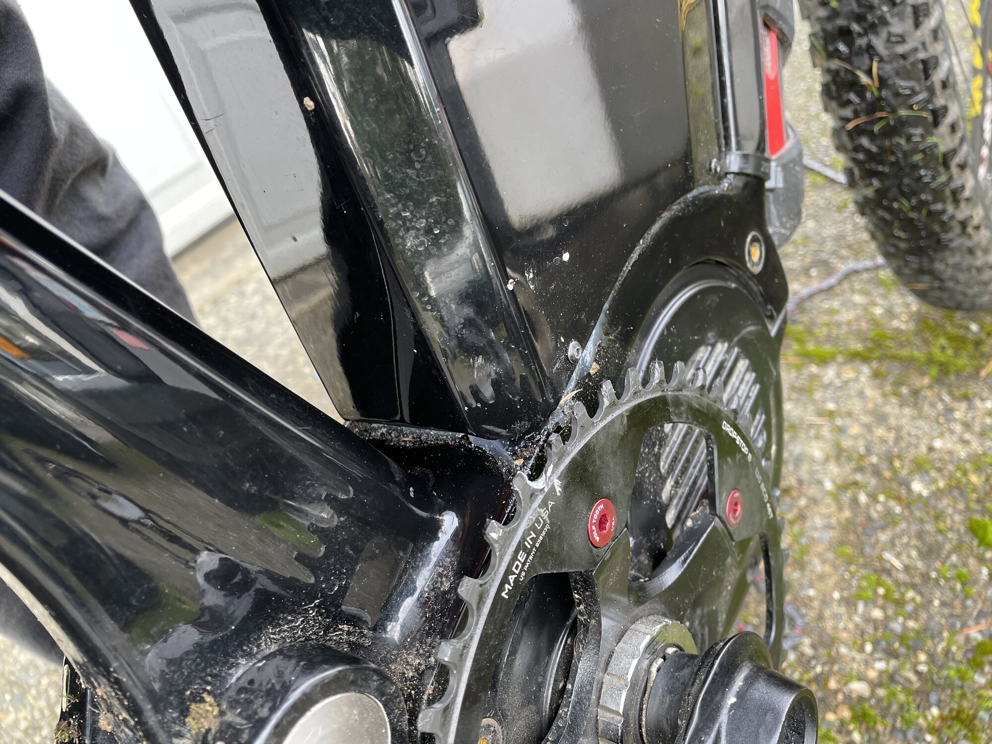

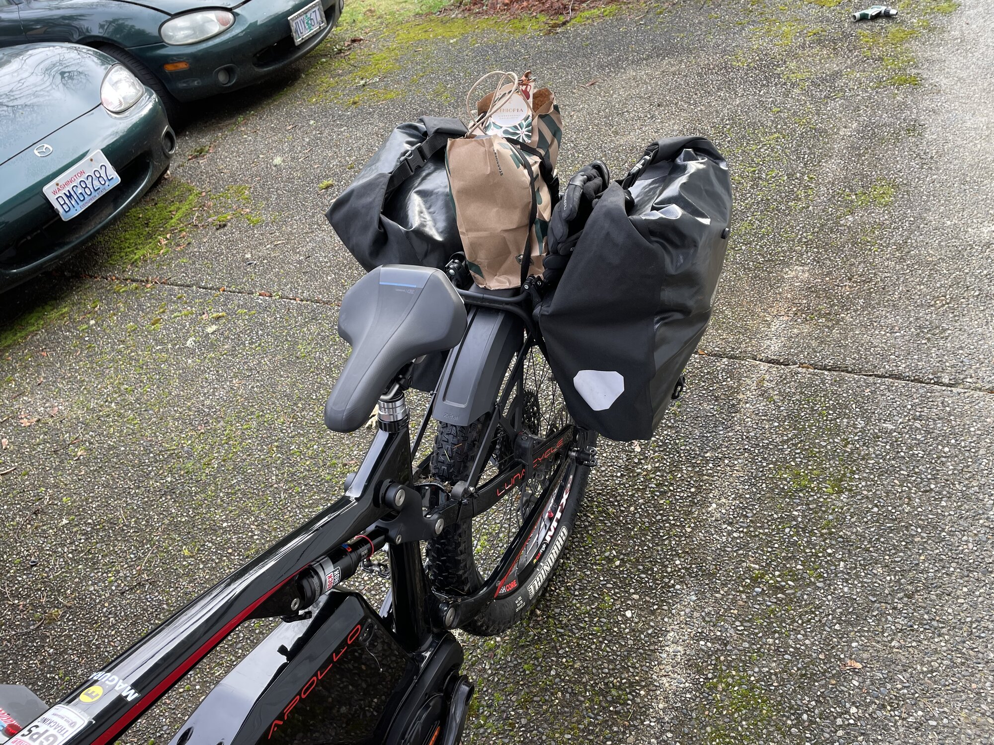

Whelp, I found the limit at about 300 lbs with 46T Wolftooth and KMC top of the line DLC chain up a super steep grade. I was in 3rd of SRAM 10-50 I think. I was getting to cheeky with it though.
The chain giving way took out the chainring with it. I will go to the KMC ebike specific chain now, put the 44t back on and order another 46T. Doh!
see the chainring tooth and the silly ass load I was grocery load. I deserve this. I gotta get on that covid moss in tge driveway.

View attachment 76868View attachment 76869
Got a spare Miata by any chance?

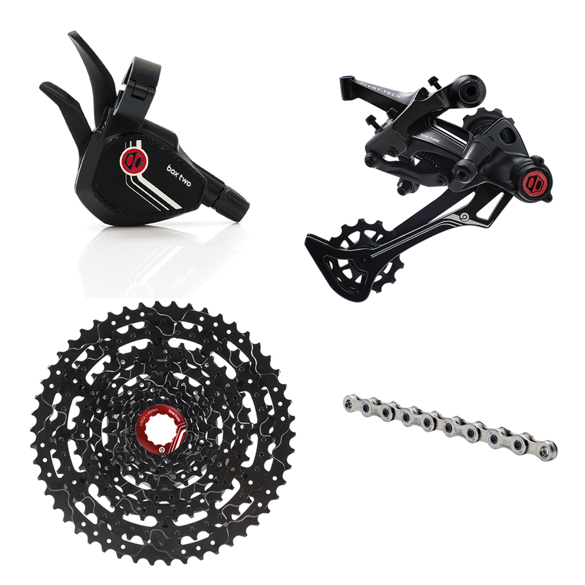

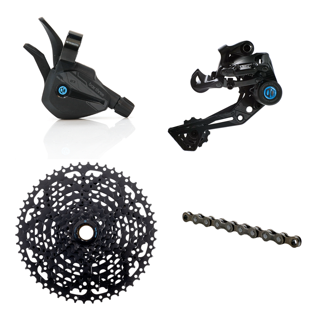

Has anyone ever tried Box Components?
'Box' Components. Would love to get some real world feedback on this company.
