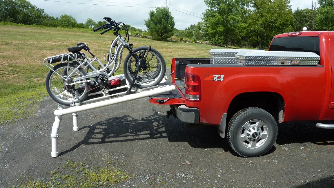

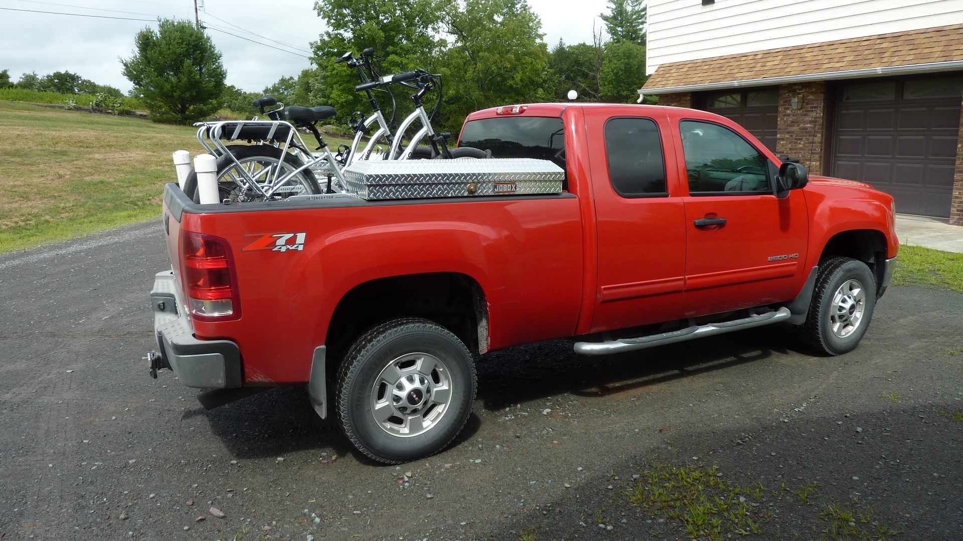

I've been using this slide out rack for over 10 years now:

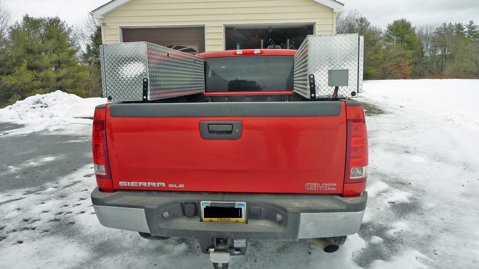

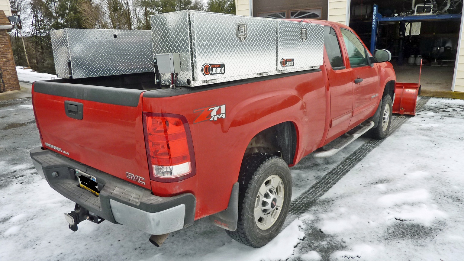

This season, I replaced the low profile side tool boxes with full size units:
I'm looking at adding a "plumbers" cap to mount on top of the side boxes. Until then, I use a tarp across the bikes & box tops to keep the weather off the bikes when the truck is parked. No pics yet since I took the bike rack off the truck for the winter. You can see it up on the lift in the upper right of pic 3. I plow snow during the Winter and there is no reason to have the rack bouncing around in the bed when it isn't needed.
The high side boxes provide a degree of security since the only way to access the bikes is from the rear. A thief would have to climb up into the bed to get at them and set off the motion alarm in the process.
View attachment 76865 View attachment 76864
View attachment 76863 View attachment 76862
