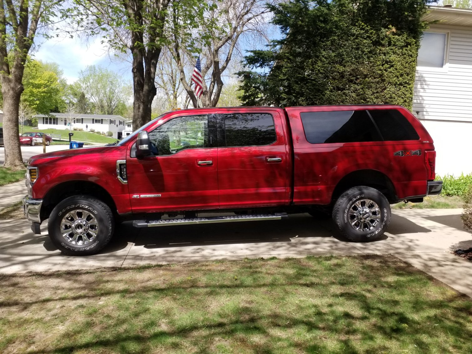

I call it a topper, some people call it a shell. I'll include a picture.

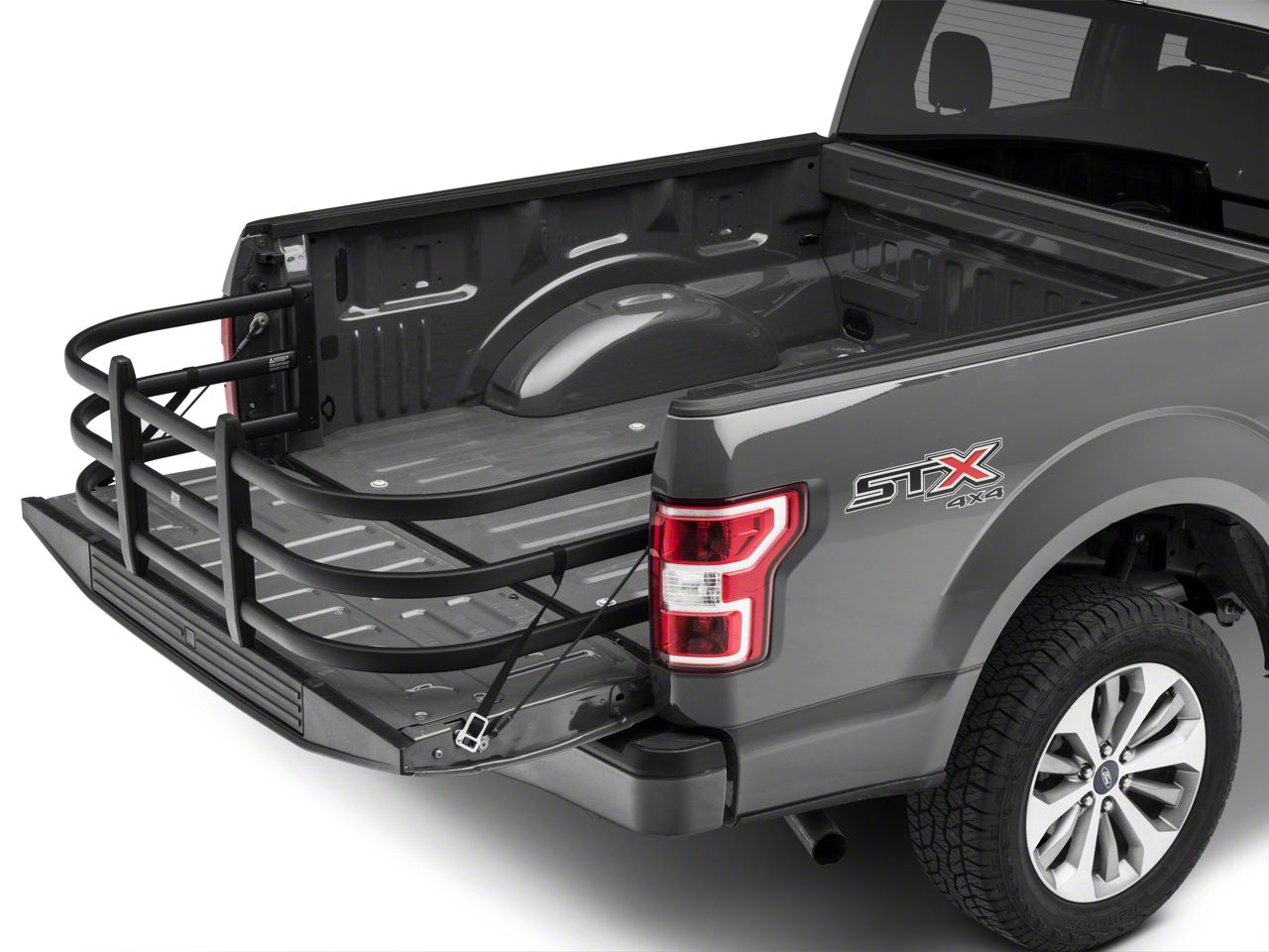

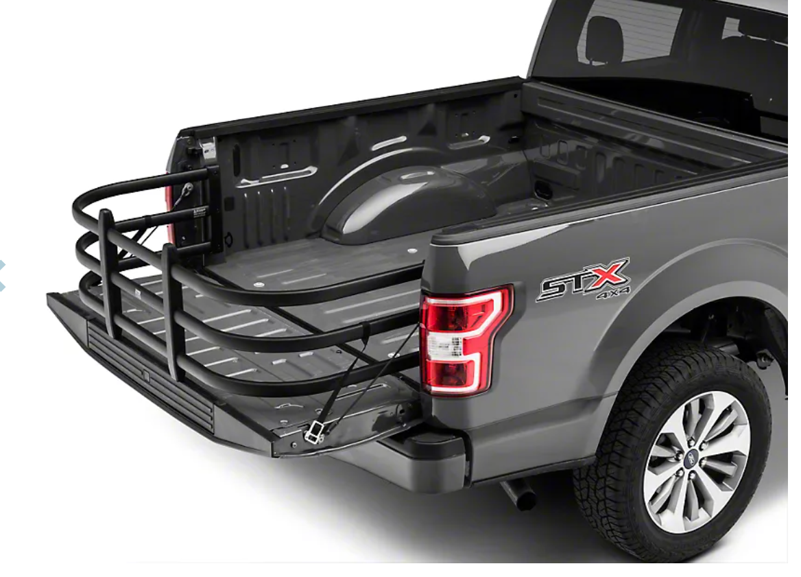

I have seen short bed pickups with toppers carrying bikes without removing the wheels using tailgate extenders like this:
Bungees were used to hold the topper hatch in place.
My bed is long enough, just not tall enough. I hadn't thought about letting the bikes stick out beyond the tailgate. That could deserve some thought to see if there would be enough clearance with the hatch up. I do have a need to tow though, so in those situations, I'd still need to find a solution totally inside the topper. Thanks for throwing the idea out here.

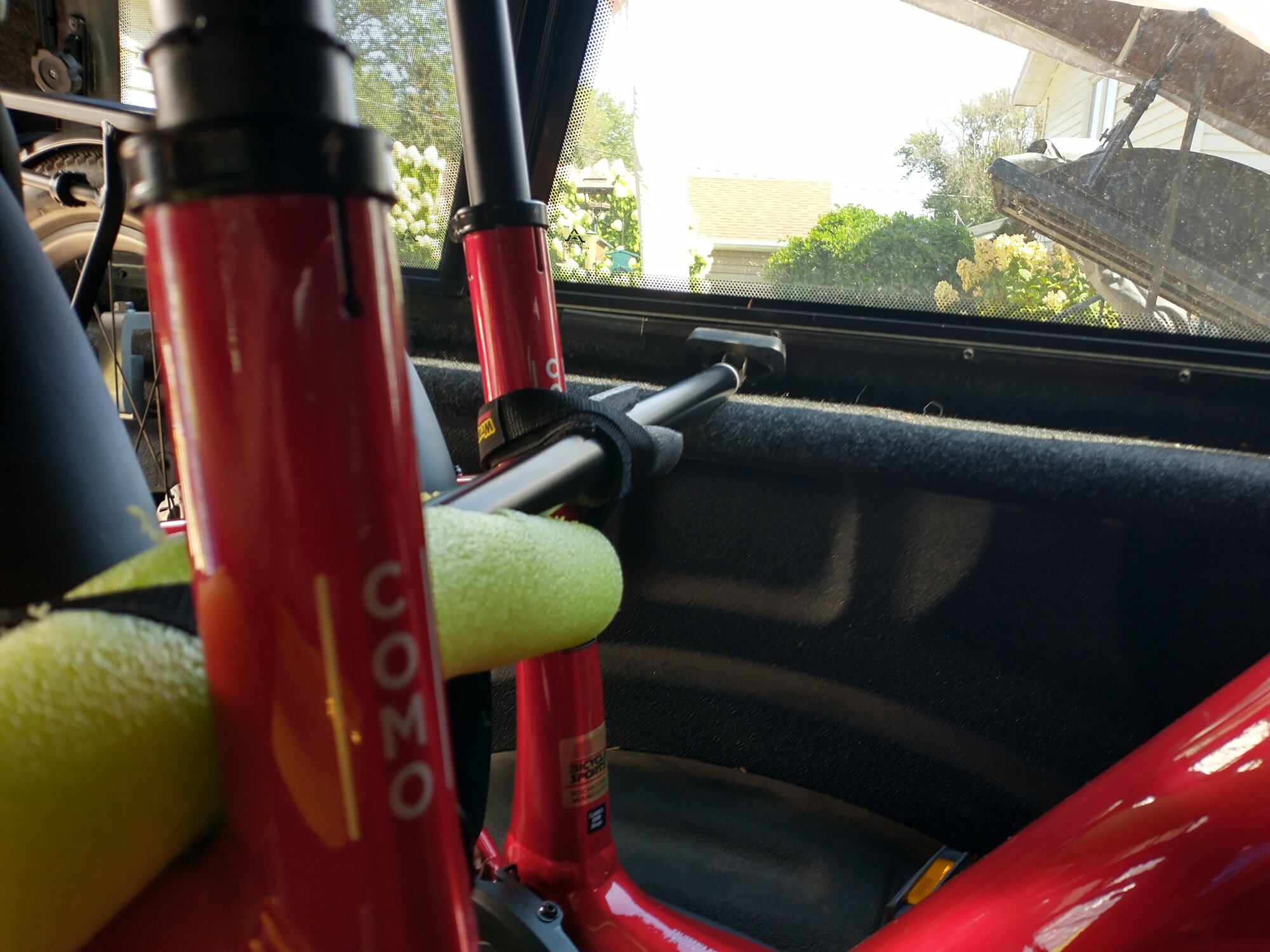

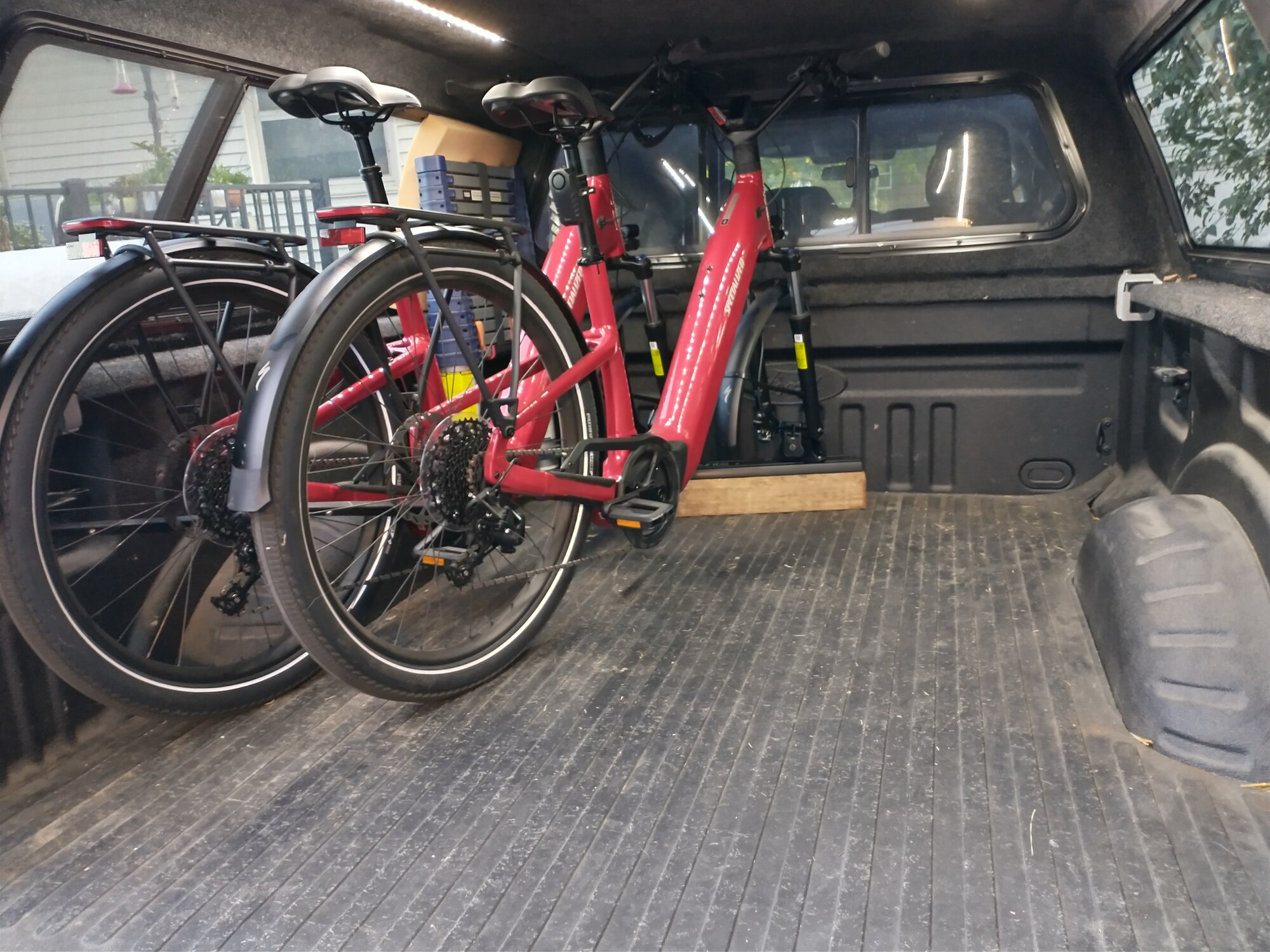

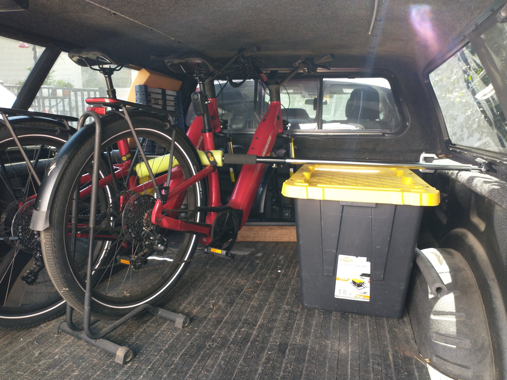

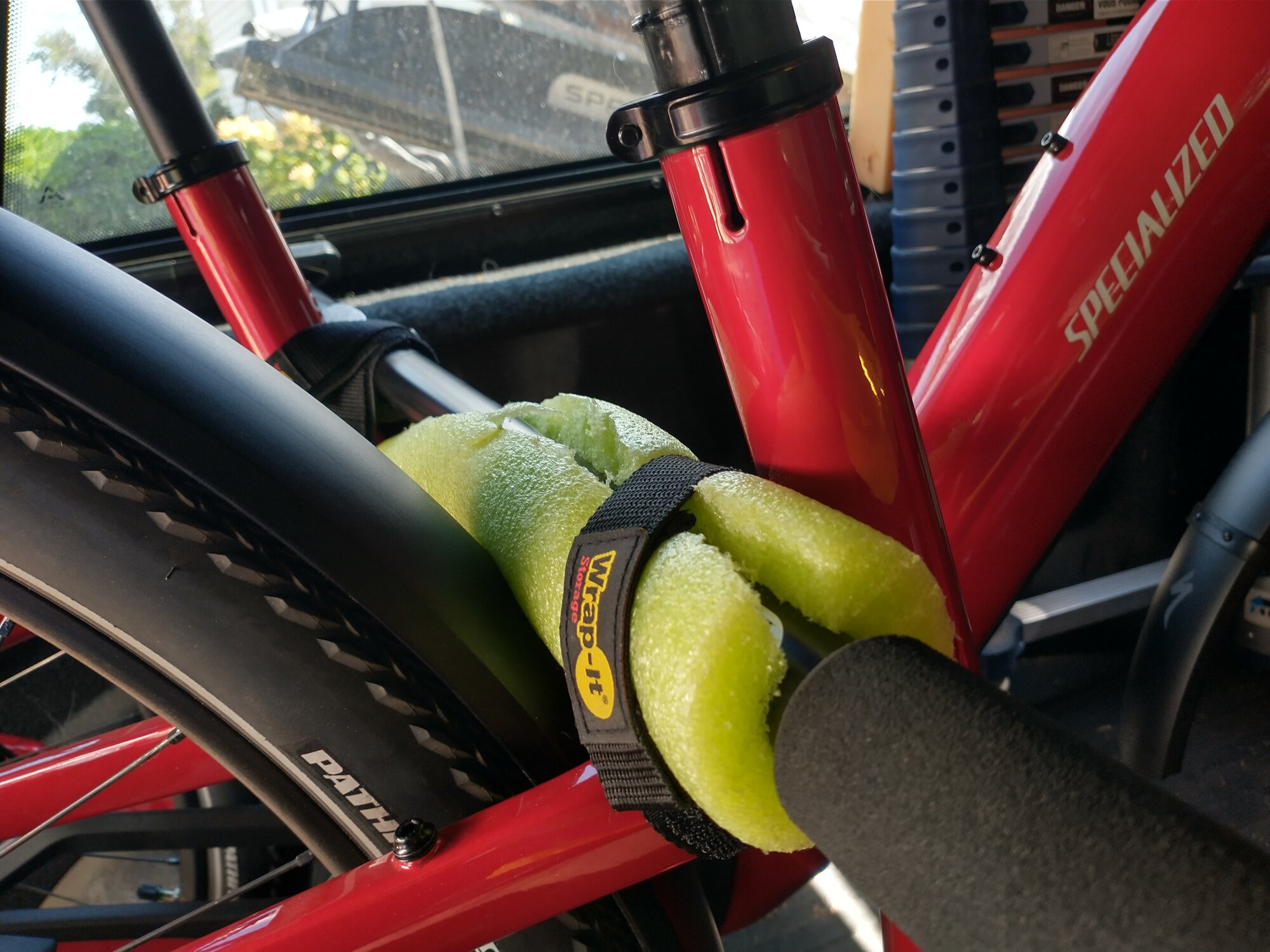

Not the most elegant way to secure, but it works better than expected. My wife drove me around while I sat and observed. The pair of Como 4.0s rode pretty stable. I basically position a loadbar so that I could strap the seat posts to it.

Just a thought, FWIW. I was going to suggest attaching the Rockymount track/mounts to ¾” plywood that would run the length/width of the bed. It would lower the height of the front ends slightly and the weight of the bikes and other gear over the plywood alone would provide sufficient weight to keep them from moving around. You could even place sandbags on top of the plywood to effectively increase the weight load. If it’s stable enough, you could potentially do without the rear wheel stands and load bar making the task loading/unloading the bikes go much faster.

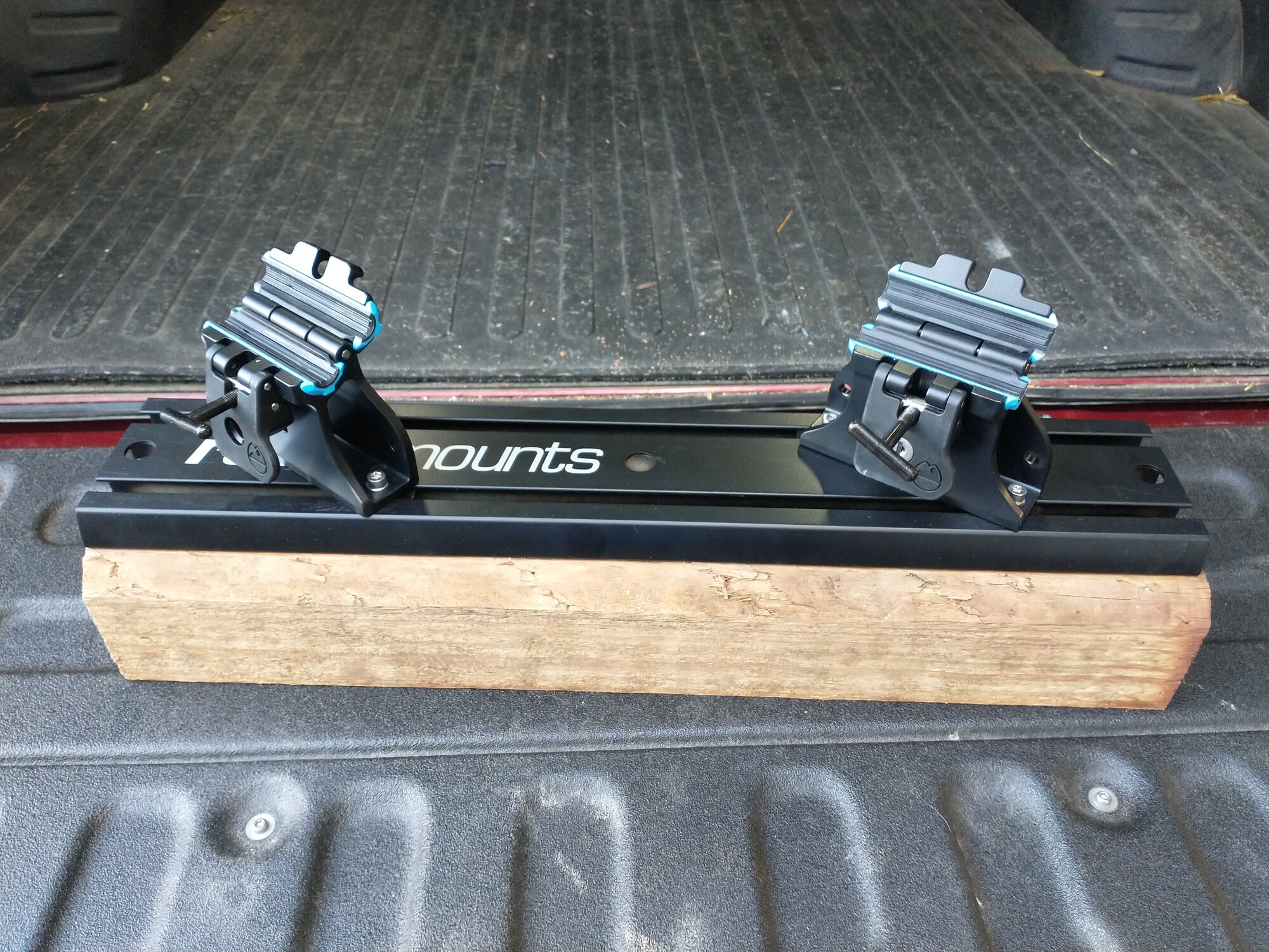

Thanks for the feedback. Part of the reason for mounting the track on the 4x6 was so I can keep the front fender tips on. I actually have them off at the moment, but I'm hoping they'll clear... it'll be close. The 4x6 is pressure treated, so is actually fairly heavy; but, actually mounting the the 4x6 on a length of plywood that runs the full width of the bed may be a good way to go for some added security. I may just do that ;-)
I think I may still *need* the load bar. I contacted rocky mount because those through axle mounts are only rated for 35 pound bikes. They said as long as I had additional support, they think it would hold just fine for the heavier ebikes.
You're right about the load/unload time. It's a PITA ;-) However, I should have prefaced that the only reason I'm doing this is for longer trips where I can't use a hitch mounted rack (Thule Epos 2) because I'm towing a travel trailer. So...if things go according to plan, they'll be loaded twice and unloaded twice ;-) The topper is pretty full with other gear too. I looked at possibly putting a hitch on the travel trailer; it's just pretty clear that some serious beefing up of the rear bumper area would be needed...and even then, most racks aren't "rated" for RV use.
