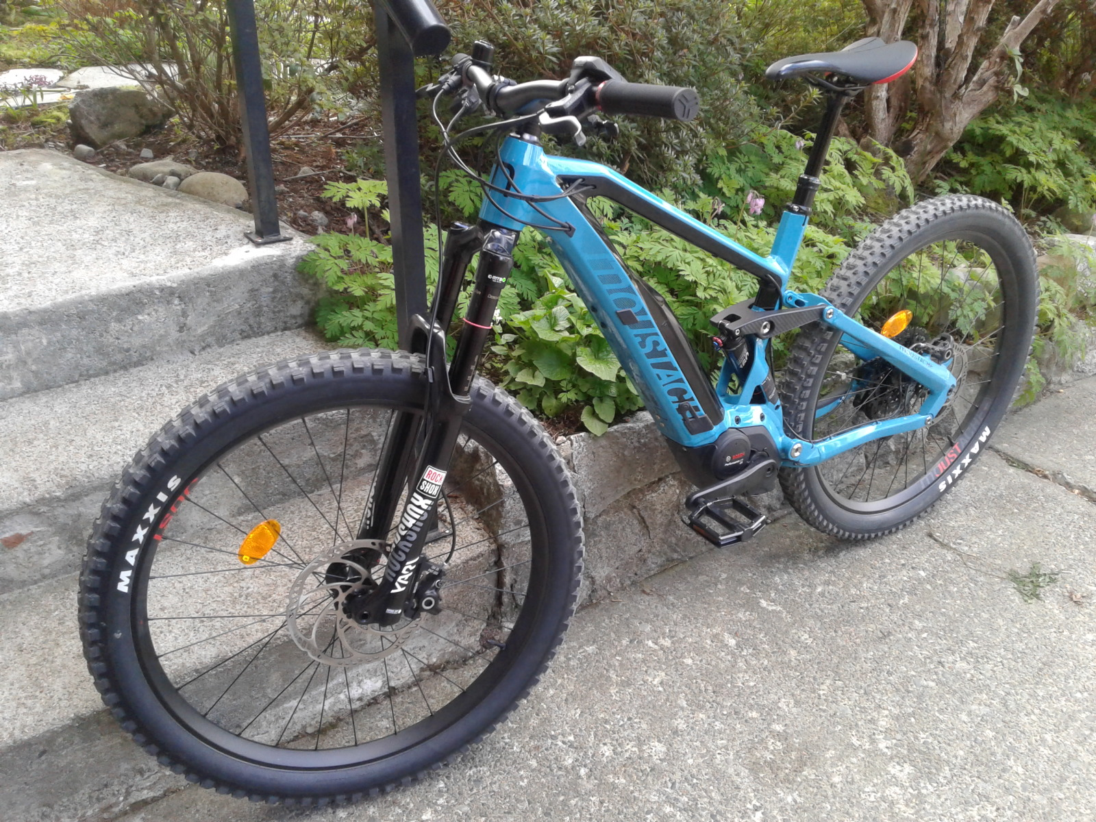

With a rack like Thule on, the FS bike still has way less unsuspended load compared to a hardtail. It will have a negative impact but I think it will be felt most in technical sections and I don't think Steve will be pushing the bike that way while carrying cargo.
Yes Johnny I just tried and it will not fit around the seatpost anyway. The Thule only fits up to 2.5 inch tires and these are about 2.6 even though they call them 2.8"
Hmm too bad. Another problem with those seatpost racks is that it has one point of contact that is almost vertical to the force caused load hence they are rated for low loads like 20lbs max.
Maybe you can try these old man mountain offerings. They have racks that fit even fat tires and seem to be better built than thule.
Hmm too bad. Another problem with those seatpost racks is that it has one point of contact that is almost vertical to the forces caused load hence they are rated for low loads like 20lbs max.
Maybe you can try these old man mountain. They have racks that fit even fat tires and seem to be better built than thule.
Yes those are looking like a viable option. But there is no Moustache option on the Ebike list.
Mike that does look like the most solid solution for the rear. I wonder how bad the handling would be with front panniers with a powerpack on each side?
Steve, I'd suggest carrying the two batteries in the rear panniers. I picked up 4 Ortlieb E-mate panniers for the expressed purpose of extra battery carrying capacity. These bags are perfect for the Bosch Powerpack, Yamaha and Shimano external batteries. Unlike other Ortliebs, these E-mates have a sleeve in which the battery slides into. That sleeve is attached to a hard plastic inner pannier liner that sees the battery weight taken up by the QL3 mounts to the rack. It will not bounce around in this bag with that sleeve setup.

Heavy as a tank, yes, but very doable. To put the batteries in front is just going to make the steering feel heavy and slow, requiring a good long time to get acclimated to that kind of feel.

Steve, I'll second what Johnny says. Contact OMM/Robert Axle Project with the size of your rear thru axle. Using the specs of your bike last evening, I checked on their fit chart and though they don't list Moustache, the Comenecal E-Mtb features that same rear axle spec as yours and it's listed as being in stock there.
But give them an email just to confirm!

Not unless the spirit clouds my judgement me on some rare summer morning ! But first I will see if I can get 100 km ( pavement ) on 2 batteries in Turbo before the Bikespeed arrives and before the bike gets heavier. Right now it is a svelt 50 lbs plus the water bottle. I will toss the spare in the Vaude /klickfix handlebar bag I have on hand. It is rated for 7kg

I like the way you roll Mike (-: Those E-mates look great but I have been waiting for over a month for my last order from Rose bikes and it seems to be stuck in pandemic limbo right now. Has anyone tried getting anything from Europe lately such as from Chain Reaction or Rose bikes?

I'm thinking that Steve has picked a real winner, too. Beautiful bike, that Moustache.
I like that Race 4 but if I cannot get a rack on it I would need to carry spare batteries in a backpack which would stink in summer (-: But WAIT ...I might be able to squeeze a powerpack in a bag under the top tube. Race 4 is back in the race!
