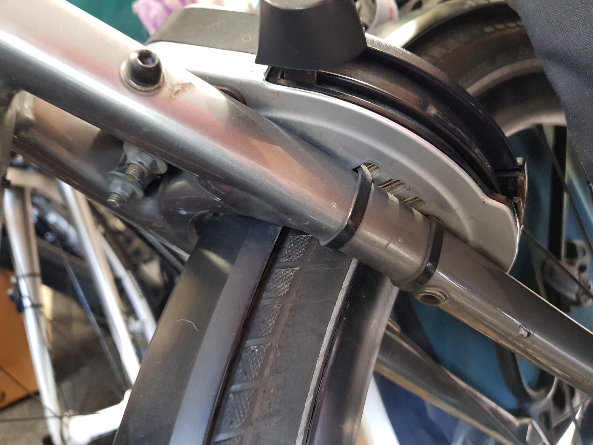

Any mount a frame lock to the factory mounts on a Turbo bicycle? I tried the ABUS 4960 but the mounting hardware was too narrow. Wondering if the XL sized ones will work.
The positioning of the screw holes is just plain weird. My LBS tried and I subsequently tried too. We ended up just cable-tieing an Abus on.
In the picture you can see that I have put it on the outside of the frame, but it is better if you put it on the inside, which is what the LBS had done. I only changed it because I preferred the key on the other side of the bike, but I'll change it around again when I can persuade my lazy-ass to.
It's almost as if the Vado's frame lock bosses are useless! :oops:
Abus does make an adapter kit to mount frame locks to bikes without the frame inserts. I posted the link earlier in this thread; post #20. It uses zip ties as well but spaces the lock off the bike frame with mounting studs preventing paint damage.
