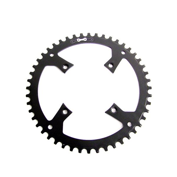

I don't know what to buy a medium drive? The specifications state 48T, 104 BCD w / chainguard. Can some link from the net help me.
THX
Buy from this store:
It is the only exact replacement and the only store where I could buy the part. I you cannot buy, ask me, I will suggest an alternative for you.
Note: Don't lose any of the original chainring screws! Don't damage them with excessive torque when tightening. Use a threadlocker fluid (Loctite Blue or an equivalent).

By the way, it turned out I was able to install the new chainring wrongly last Autumn! The diagram on the ring is on the drive side (and it should face the frame). So what? The chainring has already worn in and I won't replace it, as no ill effects can be observed.
