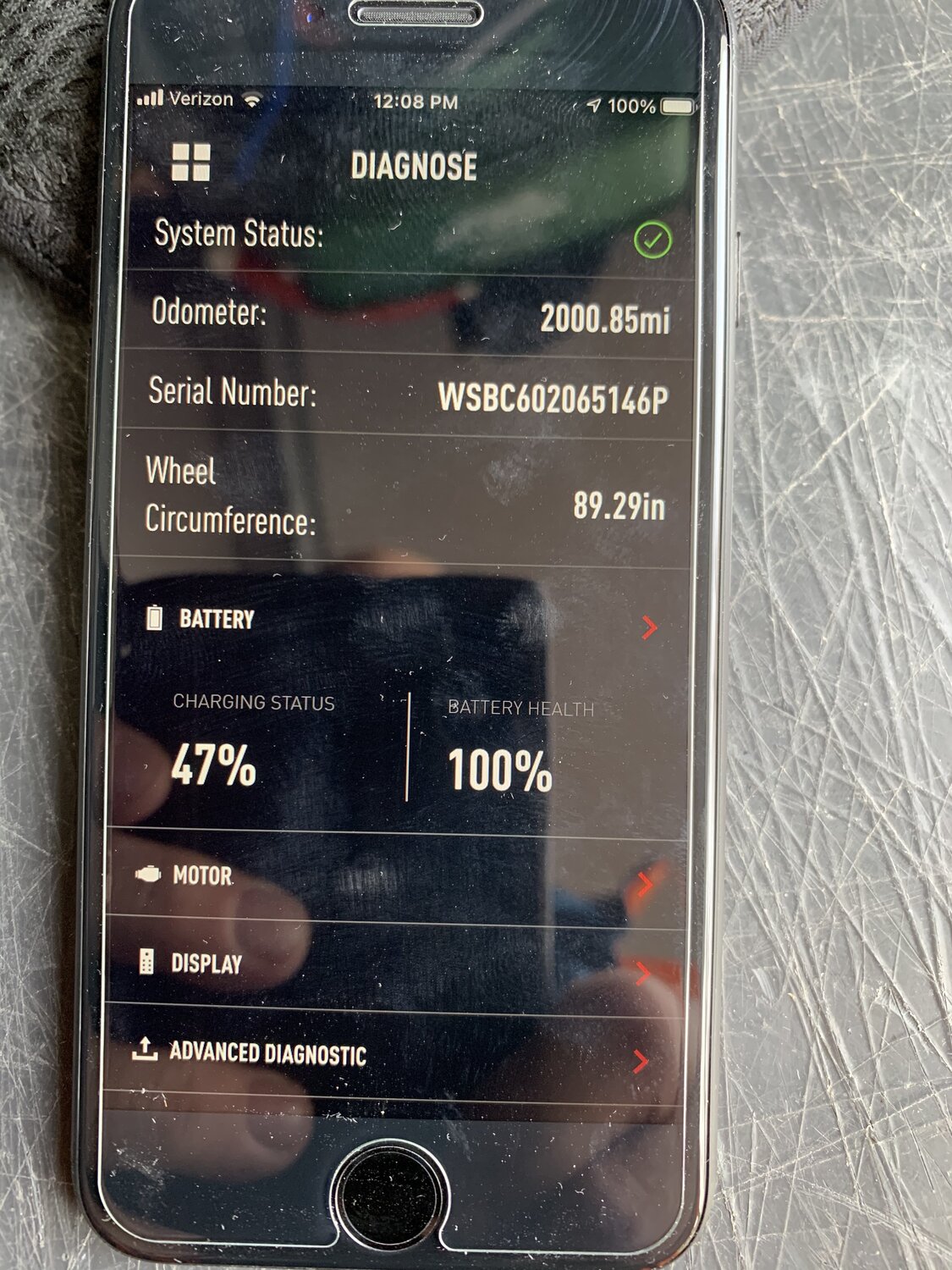

89.29 inch wheel circumference. What tires do you have on your Vado?Got the Turbo Vado 5 July 24th, today, December 24th, hit 2000 miles.
No major big whoop, but nonetheless, did the miles in 5 months.

OEM tires on the bike are Specialized Trigger Sport, 28" x 1.85" (700 x 47c) (47-622)89.29 inch wheel circumference. What tires do you have on your Vado?

Okay thanks. I missed these post. I had the same tires. However, my wheel size was set to 2255 mm or 88.7 in. That's weird. That wheel size in not uniform across all our 5.0 Turbo Vados, especially with the same rims/tires. BLEvo is reading my Wheel size now as 2300 mm or 90.6 in. since I changed to Electraks 2.0 700 ×51c (51-622).OEM tires on the bike are Specialized Trigger Sport, 28" x 1.85" (700 x 47c) (47-622)
