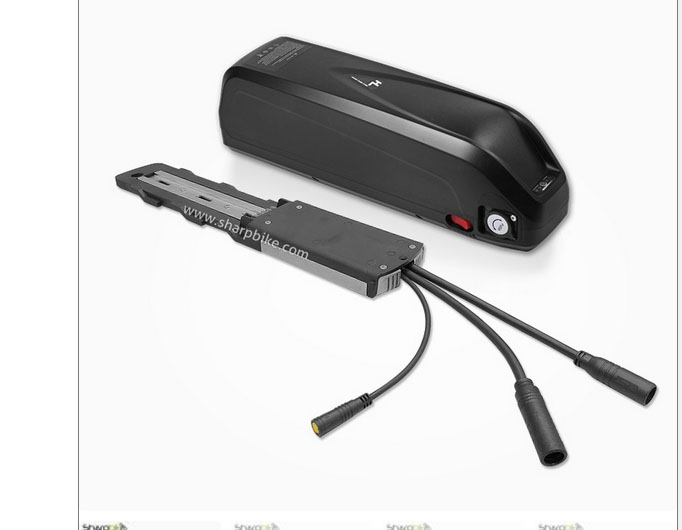

If you can't find it in the frame, it's probably inside the battery cradle.
Thanks for this! I'd started to develop a theory that this was the case, but it didn't seem any thicker than my existing ebike's battery cradle so I dismissed and figured it was tucket into some nook or cranny somewhere. Am I right in looking into these that one of these 3 wires coming out of this example picture you shared is a julet that likely has a splitter to power/control things like the display, lights, etc?
