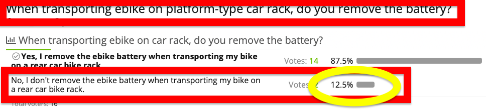

What does that mean? 13% ??
It's a poll, someone changed their vote. Now 12.5% it was 13%. K?
You're welcome.
