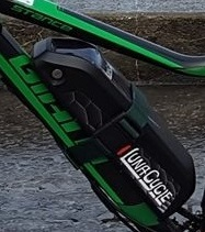

When I got my new Luna Giant with BBSHD, it cuts off on the bumps. I checked everything and it seems fine except for the battery mounting that seems not adequate to control the vibration on the bumps. I placed a buckled belt and the problem went away for good. The buckle makes it very convenient and it's a snap to exchange to a second battery.

I am 3,000 miles now and always removed my battery for charging but haven't even thought of checking the connectors since the power cut off on the bumps never happened anymore after I placed the high tension belt around my battery.
Maybe I should look closer, since a quick glance on the contacts looks fine and shiny.
I needed to remove my battery tray when I installed my Luna Cycle triangle bag. I once forgot to lock my battery down when trail riding and the battery tray slide down and that caused the power shut off. Added loctite to the battery tray screws and I now always lock the battery into the tray.
