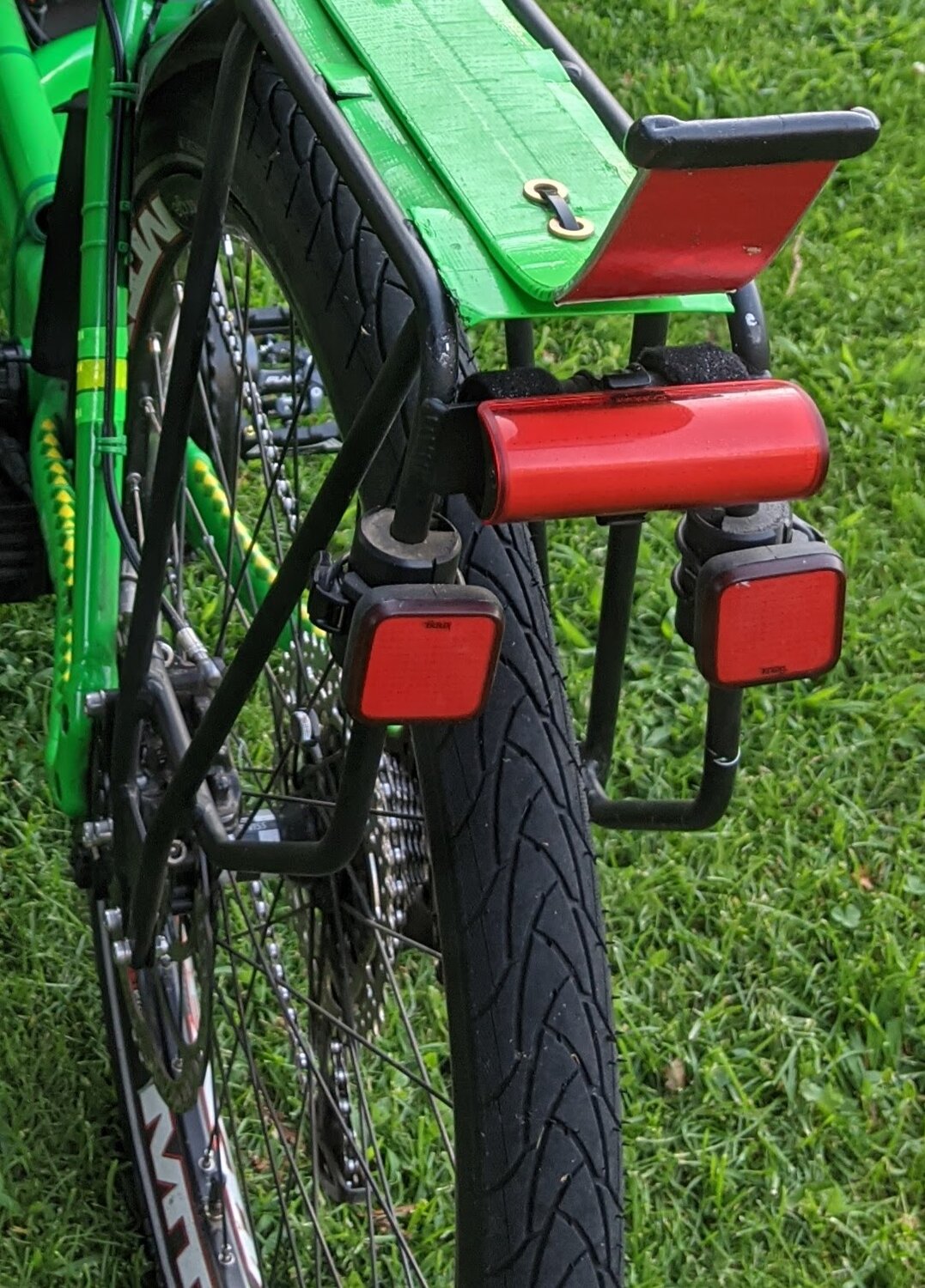

Unfortunately, blinkers to indicate a directional turn are just not going to work on a bicycle that is trying to get a result from overtaking autos - here in the USA at least where the closing speeds are considerable. The ineffectiveness of the directional blinker is for a couple of reasons. If the light is part of a single unit on the seatpost, the issue is an oncoming auto at speed is just going to see a blinking light. The driver doesn't have the time to process the light and the arrow and the fact the arrow is on the left side of that (to them) really small light fixture under your seat. Unfortunately also... and this is more of a USA thing, an auto driver most likely considers themselves to have primacy on the road and they aren't going to take a blinker seriously. Making a signal and then taking the lane to make a left turn for instance, can result in squealing brakes and a lot of anger from a driver. Been there and done that.
I tried to get around the side-separation issue with a product called Winglights that go on as bar-ends. Long story short they didn't work. Very bright but drivers don't seem to expect directional blinkers on a bike, and they certainly didn't respect them.
Getting past the use of blinking lights as blinkers, I still use them as part of a taillight solution. BUT... because research shows that blinking lights make it more difficult for an overtaking driver to measure/ gauge your progress I use more than one light. One blinker in the center and two bright solids on the sides. A Knog Big Cobber can issue a bright momentary blink that is up to 470 lumens. A Knog Blinder Square can put out 100 lumens.
And notice how I put a piece of turned-up aluminum flat bar on the rack? That bar is lined with 3M prismatic (street sign) tape for a big red passive reflector.
I laid out other options here. Not the least of which are lights that use interruptive blink modes designed for hi visibility while at the same time preventing a moth effect.

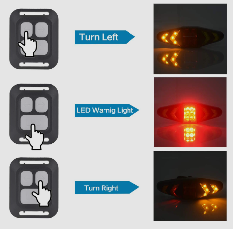

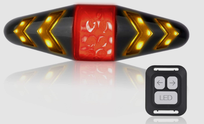

Most people don't even understand hand signals and at night they are pretty much useless.
I got turn signals for my ebike and that has helped a lot. You can put one on front and back and one remote controls both.
OTYTY Bike Tail Light with Turn Signals, USB Rechargeable Ultra Bright LED Safety Warning Bike Brake Rear Lights, Wireless Remote Control, 4 Modes
