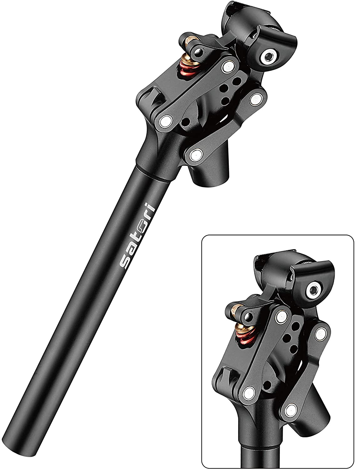

Also, take a look at the Satori Animaris suspension seat post... excellent quality and a great value.
The 31.6 mm is back-ordered... you could use the 30.9 mm with an adapter sleeve. Good luck! ;)
The 31.6 mm is back-ordered... you could use the 30.9 mm with an adapter sleeve. Good luck. ;)
I've had the Animaris for about 3 weeks and like it a lot. For my 210lbs, it works fine on my front-only suspension eMTB. I had to use a Cane Creek 30.2 shim with the 27.2 size Satori--fit my eAhora XC100 perfectly. At $59, a real bargain compared to the expensive Redshift, etc., suspension seat posts.

Do you have this in your bike? Any reason this would be better over the Suntour?
My guess is they would be comparable. I ordered the Satori that was more like an up and down shock absorber and it was garbage. Glorified pogo stick that did not offer any comfort. Stick with the suspension posts that work more horizontally as opposed to vertically if that makes sense...
Yeah it seems the best ones are engineered to move a bit diagonally and not just up and down.
I think you may be confusing the vertical spring post design with the better horizontal four-bar link parallelogram design. ;)
Yes, I don't think I'm confusing it, but instead I purchased the Satori shock style-not the model you have, and it was horrible. My Suntour is similar to yours there in the picture. I tried to get away spending 35 bucks and got a rock hard pogo stick. I think my current Suntour moves similar to your Satori...
To clarify, we are in agreement that the pogo stick style shocks are garbage and should be avoided. ;)
I'm recommending the superior four-bar link parallelogram design... the Satori Animaris is better quality and half the price of the Suntour. I have tried both.
Then I buy Animaris next. I only paid 75 bucks including shipping for my last Suntour from Aliexpress...
