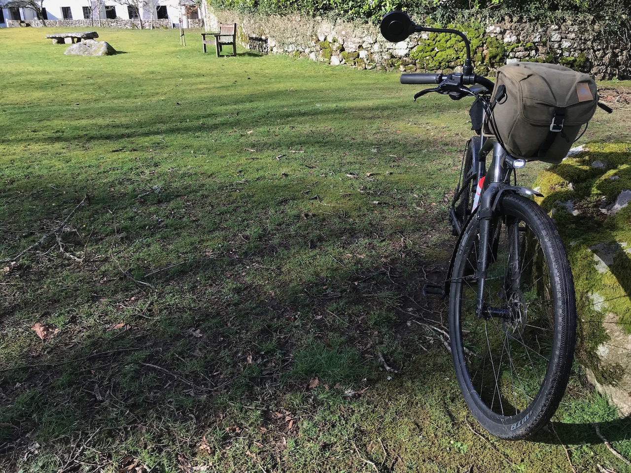

I am curious about the Byways and how they handle the gravel, including loose, sandy and muddy conditions. The slick centre-line does not translate easily in my mind to good gravel road riding
They ride fine in the dry and hardpacked gravel I have around here right now. They perform much less well in softer and sandier and muddier conditions.
They are great on the road - any road, potholed, gravelly etc. Not great in deep mud especially singletrack because of the wide centre smooth thread, but as the name suggests they are for back roads rather then where more grip is needed. It's always a compromise between speed on road and grip off road and I'm happy with these as I tend to do 60-75% road to 40-25% offroad. On dry gravel they seem fine - but I'm kind of aware of their limitations on sketchy stuff so I probably ride accordingly, if you see what I mean.
I have Pathfinders (SK) for winter muddy use but I ended up not swapping over last winter, the Byways were just so good. I would definitely recommend the Pathfinders for a lot of mud or gravel because of the knobs rather than the smooth centre strip but they are more sluggish on roads. Horses for courses etc.

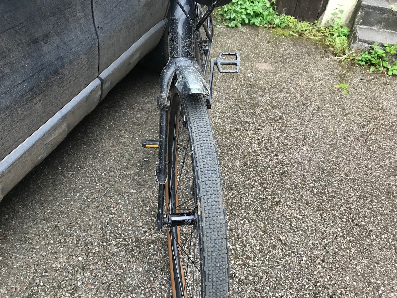

Pathfinder followed by Byways:
For my gravel/pavement combo bike (not electric) I've run a few. Currently running Panaracer Gravelking SS in 35mm on that bike. Originally ran Schwalbe G-one allrounds, don't remember the exact size but somewhere in the mid 30s. The schwalbes were definitely the more supple tire and handled pavement better, but also were less durable and more finicky on gravel. The panaracers are gripper on gravel and slower on pavement.
