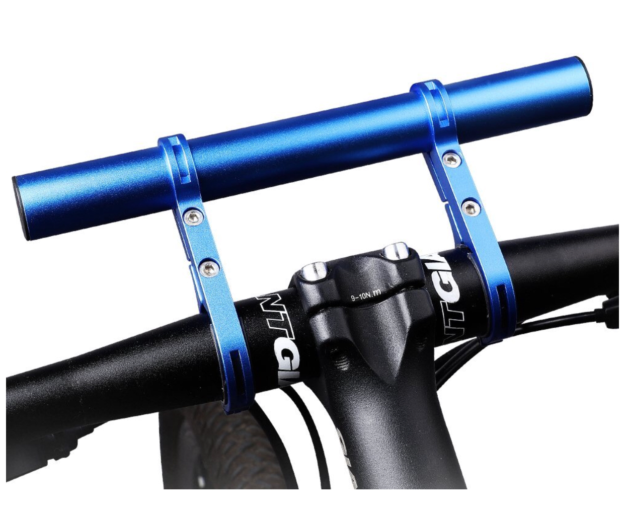

You could get K edge garmin mount like this.. and tilt the light upside down and install it. That is how Trek Super commuter has the M99 light.
1367000_2017_A_2_SUPER_COMMUTER_8_Plus_US

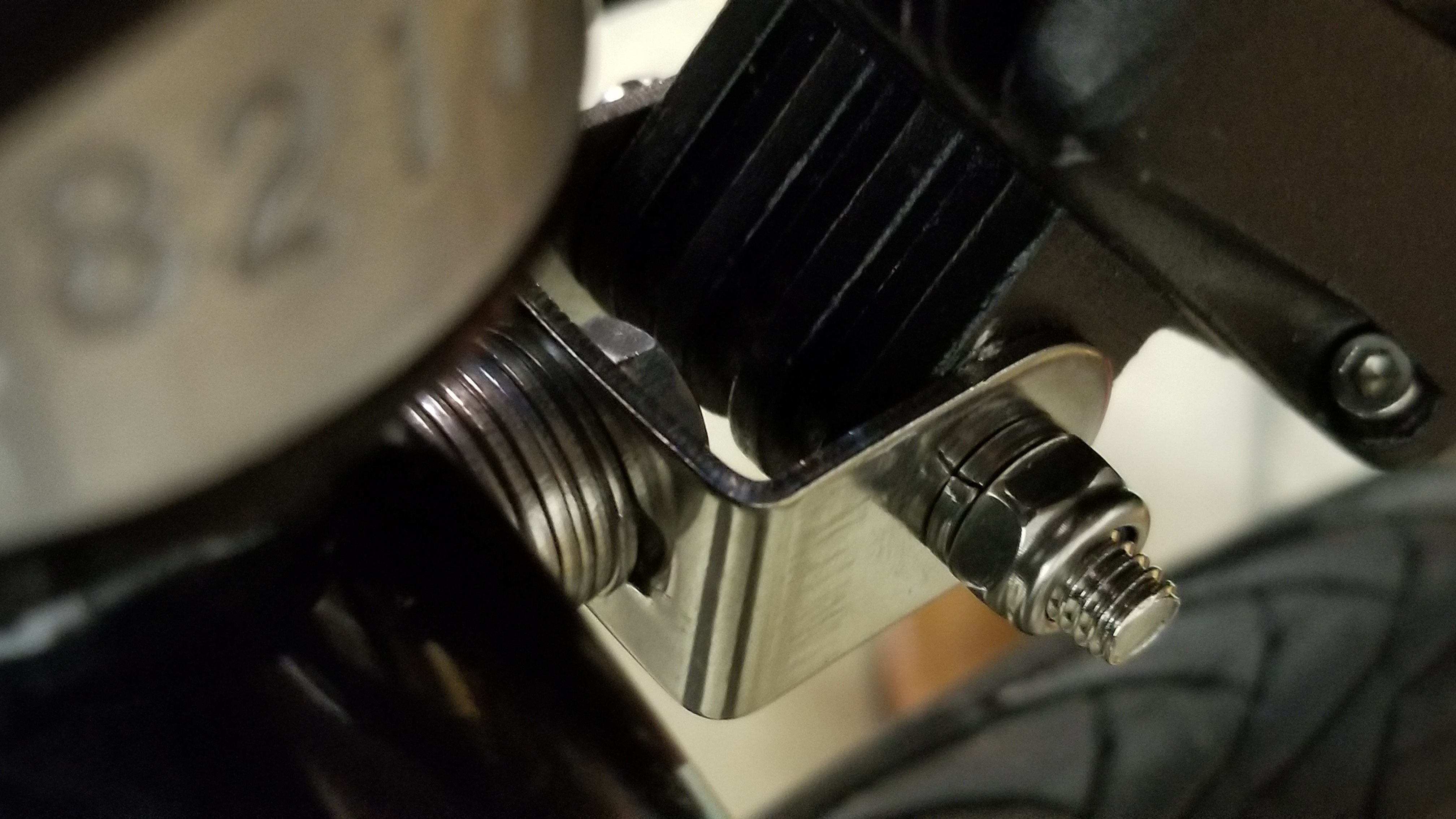

Part of the difficulty is that the light has a clamp that has a screw going through it but is not interlocking, while most models are both interlocking and have a through screw.
Without unscrewing it, I measured that black clamp at 1.0 inch wide.

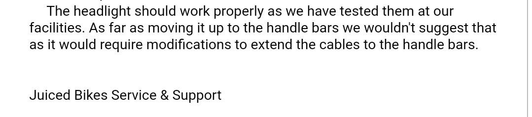

Asked Juiced. Got a useless response.
Even stock, the light wastes much of it's beam illuminating the tire.

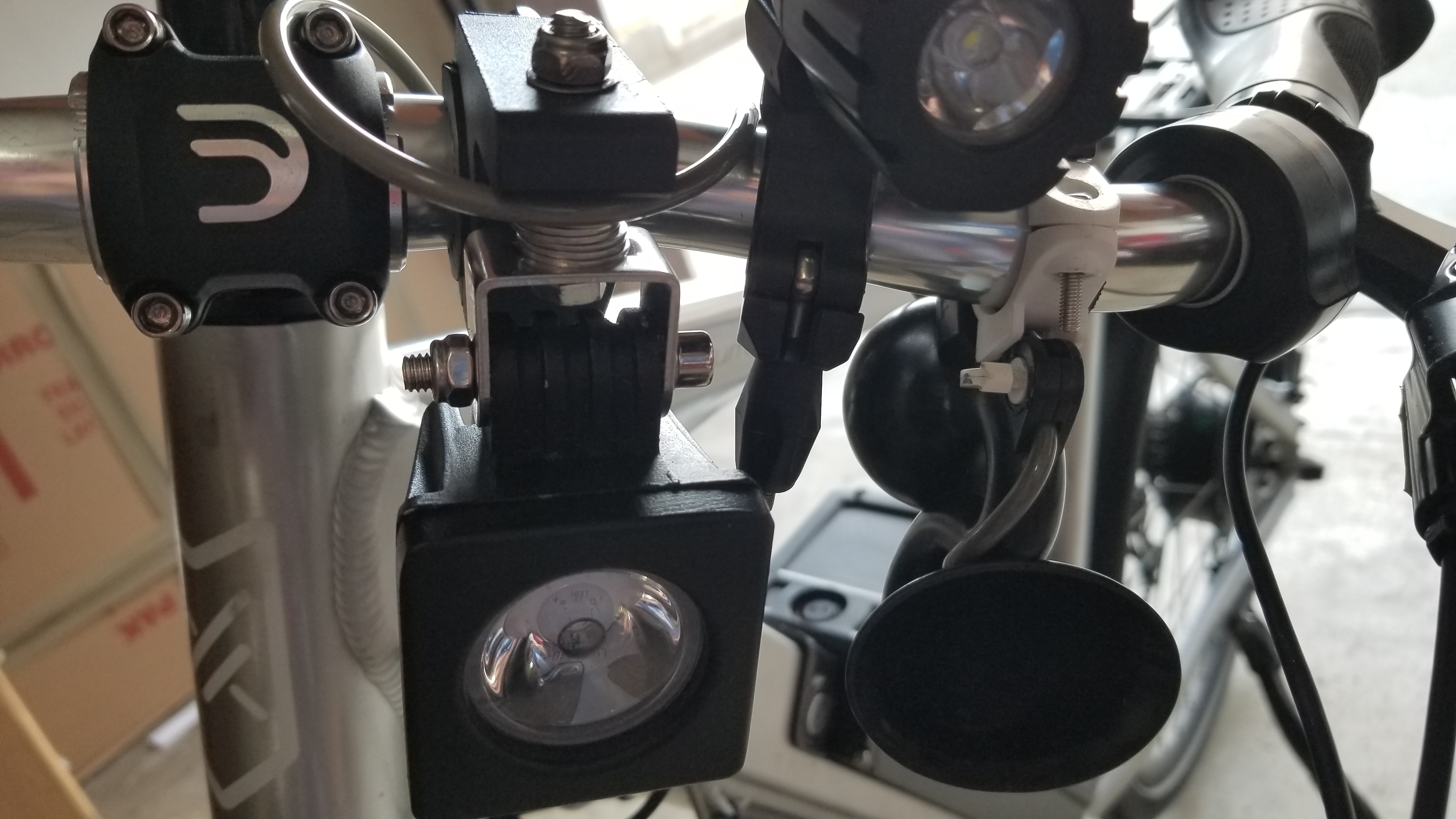

Success! Had to use a zip tie or two to keep the wires mostly out of the light beam. Also need to remove some of those washers to keep the light higher.
The lamp wire wasn't long enough to have it on top of the mount unfortunately.

The upside down mounting is better IMO. Think it looks better. Upside down is how I ran a Cygolite for a long time.
Soon, I will try to fit the BadAss Sharks alongside the headlight I still run at the fork crown. I happen to like the crown mounting location. I don't lose all that much light to the fender, not on my bike, anyway.
