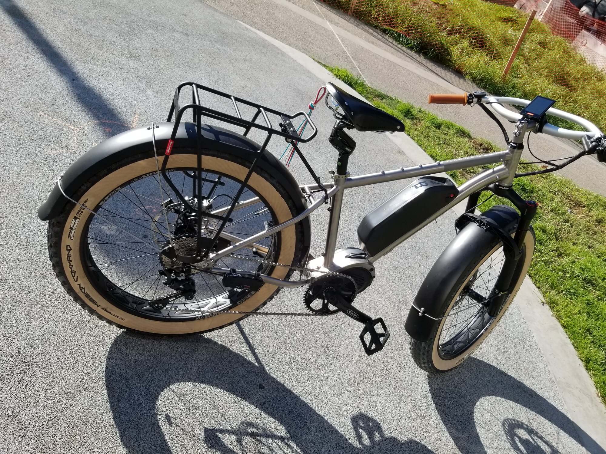

Thanks Deacon. You had an influence in the build. The entire D1x genesis started with you and (I believe) Scrambler discussing the Archer; leading to my installing one on my Lm'td to accommodate a Domino throttle.
So, when WW approved the throttle, I alerted Amit to 'possible' ('impossible' is a better term) clearance issues with Shimano shifters (and every other shifter I'd tried - except the D1x, but I didn't add that part). I was curious if they'd find, or knew of) something besides the Archer, but they came to the same conclusion. No dice.
Expectations tempered by bitter facts, I was stunned they found me a small frame. So on a roll, to expedite I made clear to Amit I'd compromise any unavailable parts.
My only change was omitting 4.8" Knobby tires for Vee MC 4" Gumwalls.
(Second) UPS Delivery date is tomorrow. Knowing UPS has (ahem, cough, choke, snort) difficulties, I designated a commercial address.

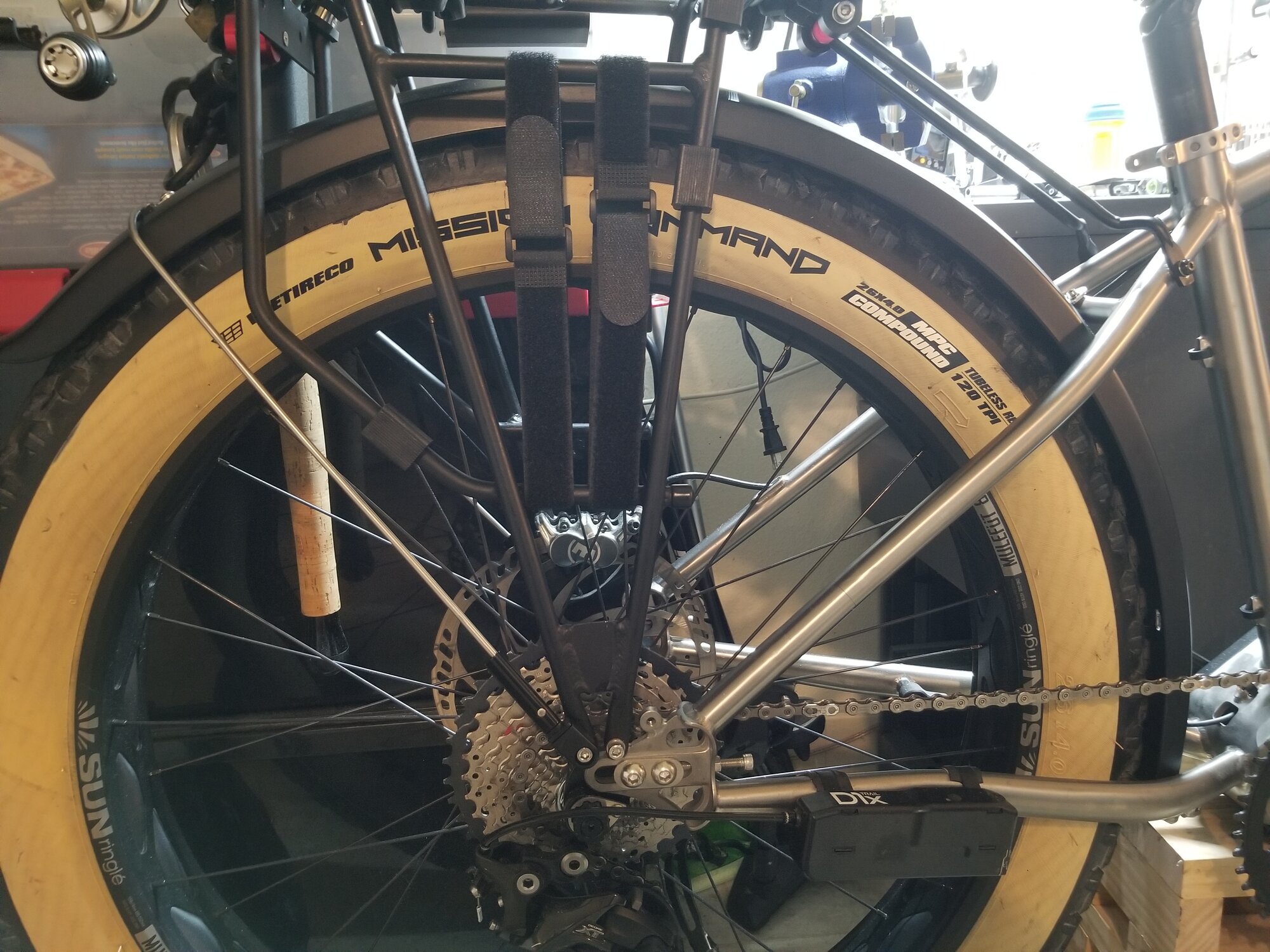

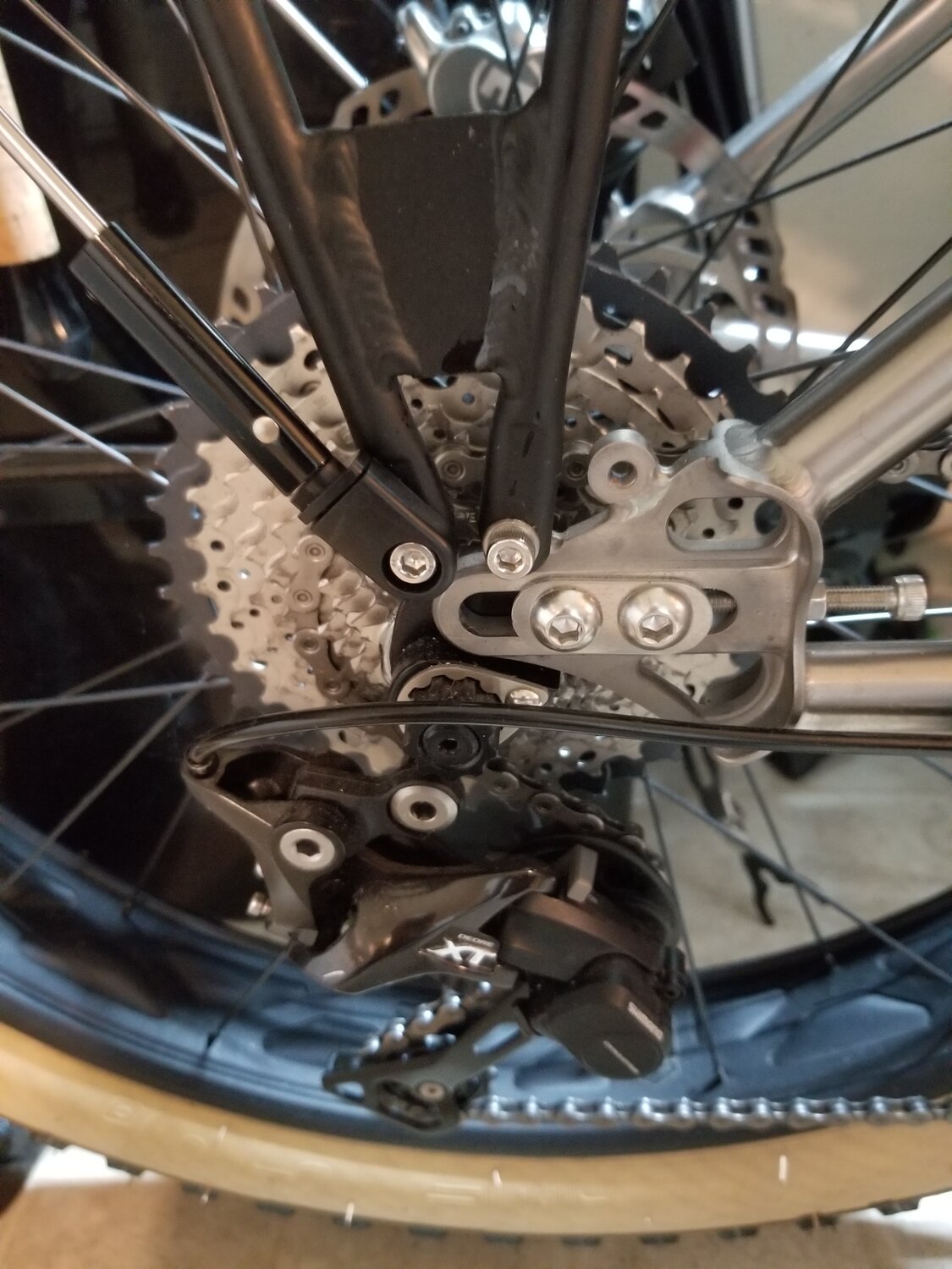

That's a very interesting way of mounting the axiom rack and using that tab for the rear fender support.
You're right. You can see the UC on the WW website. This CrossTour has a difference in the frame geometry, or perhaps because it's a small frame, but they reversed the extender plate.
I'm using an Axiom rack, the model without the middle bar, but the same mounting plate >year now.
I've drilled and attached Torque Plates to a 100NM rear hub's axles; carried >80lbs for miles once a week or so. Even drilled holes in it to mount fenders and it stays solid. Glad they are using the extender 'tubes'.
(Edit) I've since eliminated the entire lower assembly.
And, after resizing and cutting the fenders, eliminated one stay, replaced the clips w/ Portland's; the frame 'stay clip' w/ a Honjo and isolated fenders from stays w/ 3mm, adhesive silicone strips, the Fenders are perfect for me, w/ the only vibration point at the Honjo, so much quieter.
Highly customizable.

I wanted two batteries, but I didn't realize WW was going to mount the second battery on the top tube, which would make it impossible for me to step forward off the pedals, so I ended up taking off the battery and mounting plate.
With my bike/rear rack the mounting plate fits perfectly. It's almost like the rack was made so the mounting plate would fit. I plan, if I end up keeping the bike, to install the mounting plate on the rear rack, so I can carry the extra battery on the rack. It would even be locked in place.

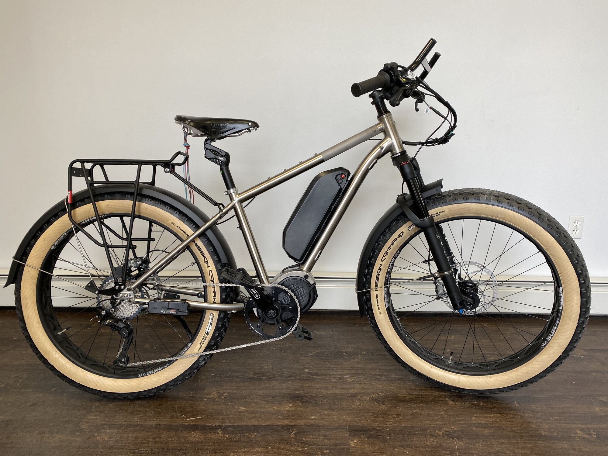

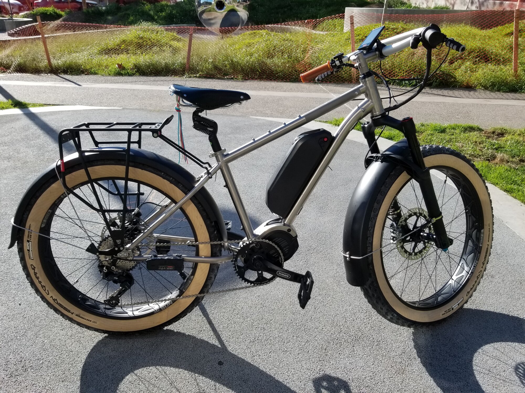

Here's the build sheet.
Drivetrain
Frame Size: UC/CrossTour Small/Fat
Color: Ti
Motor: Bafang M620 52V X1 2300W
Battery: Jumbo Shark 52V 16ah
Throttle: Domino Twist Grip 0-5K Ohm Throttle, Standard Firmware Profile
Drivetrain: Shimano XT 11-speed, 46T Front Chainring, 11-40 Rear Cassette
Shifter: Archer D1x
Cranks: Bafang Aluminum 170mm
Wheels/Tires
Wheelset: SunRingle Mulefut 80 26”
Rims: Aluminum
Tires: Vee Snowshoe XL 26x4.8 Mission Command 26x4.0
Suspension
Front Suspension: Manitou Mastodon Pro
Brakes
Brakes: Magua MT7e
Rotors: Magura HC Storm 203mm (I have 220mm(F) and 203mm (R) MDR P's ready to install)
Cockpit
Handlebar: Surly Moloko (I'll be using my alloy Jones Butted H-Bar Loop's. If I like with this geometry, my plan was to get the titanium bars, but like the ti frames they've been 'out of stock', were expected in May 2022 and may be no more).
Stem: Salsa Guide 60mm (I have 10 degree, 60mm and 80mm Titanium stems to install)
Grips: Ergon GP1 (presently Black Domino rubber grips, switching to my Gum color)
Suspension Post: Kinekt 31.6
Saddle: Brooks B17 Carved Men's Black,
Axiom Rear Rack/ SKS Fat Fenders
Accessories
Chargers: 4A (Satiator out of stock at WW. I need more advice and study to find the best charger)
Firmware: Harness w/2-year SW Upgrades
Pedals: Crank Bros Stamp 1 Black
Is this frame from a new batch of frames that have recently been delivered to WW, or is it an 'old stock' frame, like my UC Pro frame?
I think the 26" wheels look better than the 27.5" wheels on my UC Pro. If I do end up keeping my Pro I may end up switching to a 26" wheel. I did mention this to Pushkar, but he thought I might have a problem with pedal strikes.
Is the 170mm crank arms a standard size for the UC Pro and UC Cross Tour, or is this a shorter crank?
I'm really interested in how your bike shifts (as in skipping in the smallest cog).

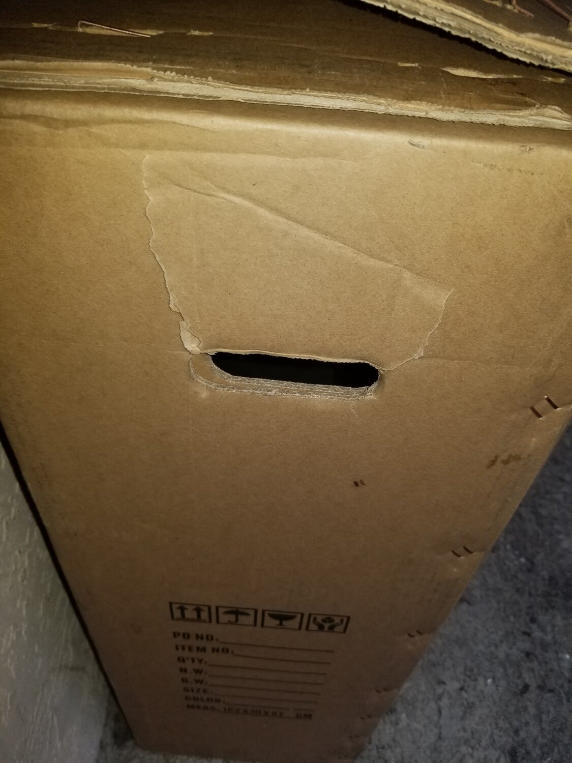

My battery came loose in the box 😢.
WattWagons advised my to check inside of box for damage, and yup. It can see where the battery crashed into the end of the box.
The UPS guy was end-over-ending the box. I heard a thump, something with some mass.
Every time it was end-over-ended, the battery crashed around. It tore off two right side fender braces, and the Bars are packed throttle side down (uh oh); throttle body is plastic (uh oh). Well, at least now I know what the insides look like. Nice gears. Cracked casing shattered when I tried it a few times.
It appears the deep scratches on the Shark Case (only on two sides and the rest of it looks new) were made by it hitting the crank.
Who can be certain. Battery was 'hanging up' wherever and whatever it could. I'm not even sure how it was packed.
In general, WW's packaging was great. No expense spared. I buy that foam they use for various projects. It ain't cheap.
Was the box, which says "This Side Up" dropped off a truck or loading dock on it's end while loading/ unloading?
One handle cut-out is torn. That's happened to me when a heavy file box got away from me and ripped right out of my hand.
This was about 100lbs and that cardboard is multi-layers thick, but that's the only grip point on each side and it tore out of somebody's grip.
I look at the bright side. It could easily have been a so much more serious if one of those cells shorted out.

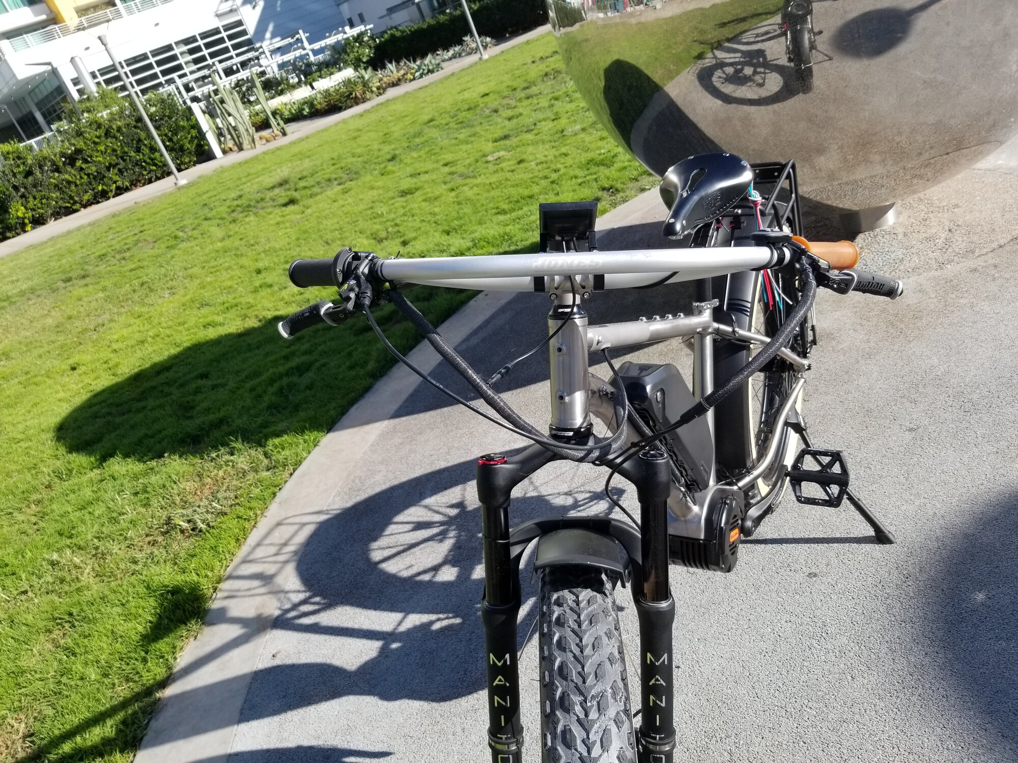

Just starting the wiring harness. Have to go by my bud's for compressed air to blow that blk Domino grip off.
I'd heard Bafang's mount had 'clamp issues'. Sure enough, I stripped one side without much trying. Same as the (see below) fender-stay tabs. This time I used a flat head, longer bolts w/ washers.

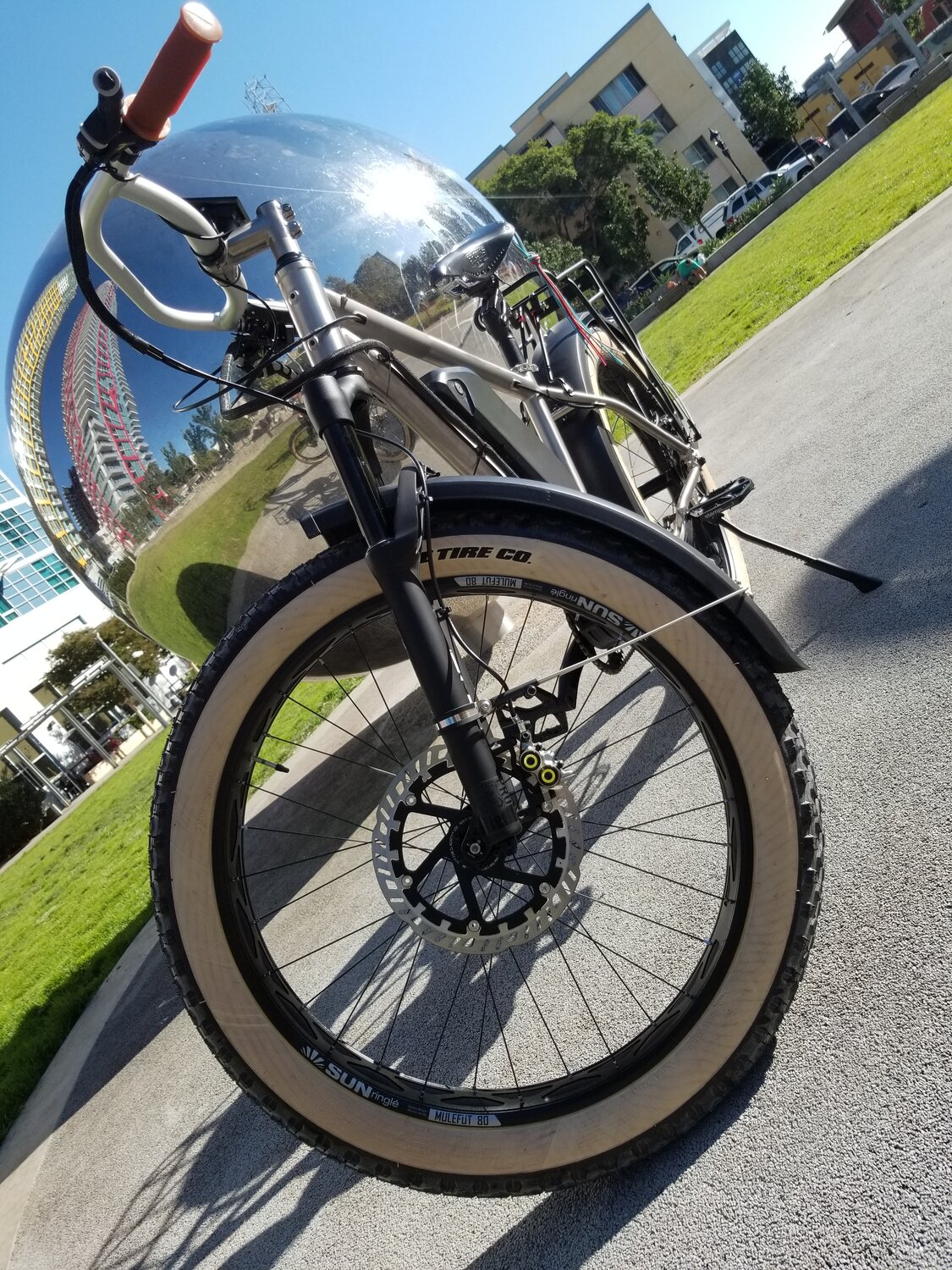

Titanium, on titanium, spaced with titanium at the top. 220mm MDR P's midriff.
The Magura cut-outs as installed work perfecto.
I had an F and R fender stay loose. WW pointed out it could be more, like my Fender-Stay tabs damaged - by the 'flying battery'.
Right they were. My fix is simple. Use a longer bolt w/ a washer so it can't pull through the plastic.
WattWagons even tuned my Archer wireless shifting. Pressed two buttons, I'm live and shifting. They didn't plan for UPS Mayhem, Loki or Dionisius with a hangover, but rose to the task, getting me on the road like it was a 'race day' commitment.
Even tuned my Archer wireless shifting. Pressed two buttons, I'm live and shifting.

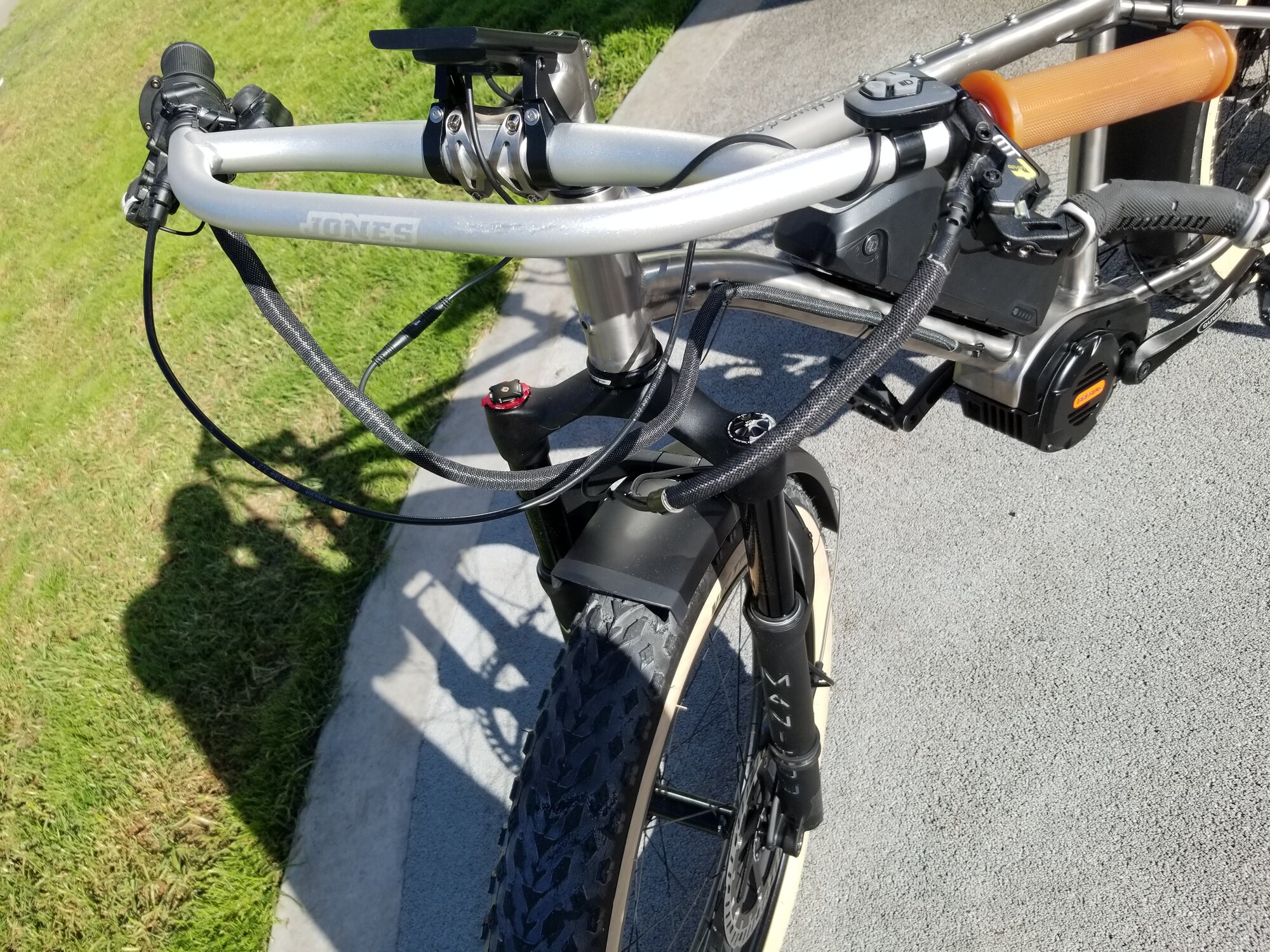

Yea the front looks super clean. Big benefit of those Magura e-levers and the electronic shifter is the wire is thin and flexible - way more than a shifter cable housing so you can wrap them together right up to the handle. Is the wrap easy enought to remove if you need to get in there? Mine is all held together by a silly amount of Jagwire clips but they are at least held together in 2 groups. I could get them wrapped in 2 clean lines like this + the front brake to the fork but I worry about ease of fiddling... and I wouldn't be able to wrap them as closely together at the handles. I did manage to find the right size 2 and 3 cable grommets for my E06 frame from GiantBikeSpares so I was able to preserve that clean part of the look at least and not have to try and punch a hole through the single cable grommet that shipped with the frame. They actually fit the rear stay pass throughs (same as the Hydra's) as well so I think I may pop one in on the brake side and run my speed sensor through there so it's no longer external - would probably work on the drive side with the 2 hydraulic lines for the Kindernay too! 1472-PLUGIN-712 is the part, and as far as I can tell 1346-PLUGAA-806 is the same and about $1.24 each. One thing I notice is WW doesn't reorient the banjo bolt on the rear calipers for a more straight run to the pass through - I don't blame them as the oil is a PITA to clean but if you've gotta undo the line to run it any way, why not go for it?
Even with the external wiring on the downtube it still looks super clean with that wrap though. This makes me want an HT fatty for my second motor, but between the smoke and the incoming rain it looks like summer's truly over and I don't know when I'll be able to go ride again...

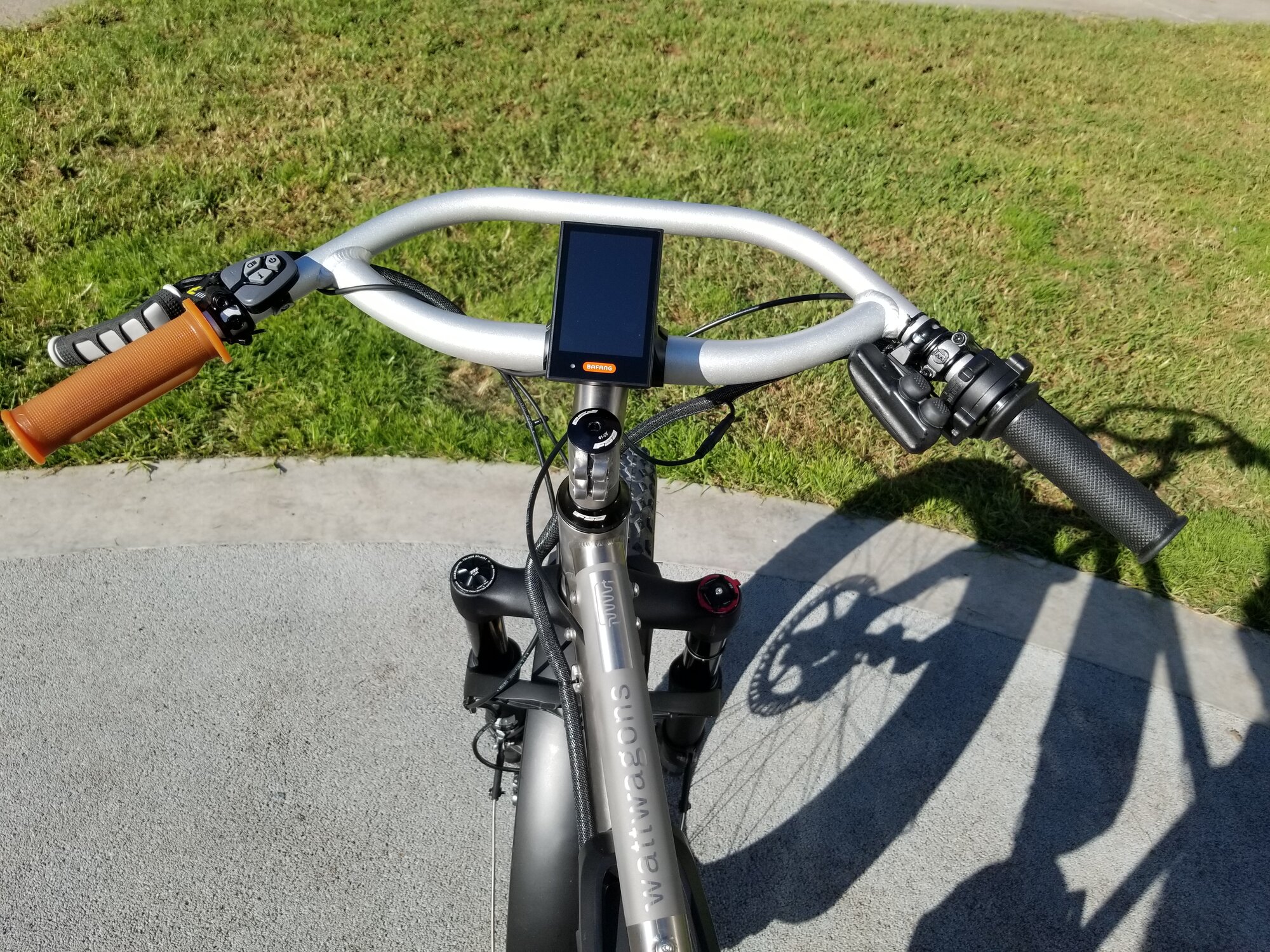

I've never seen anything like those grips on your brake levers - kinda cool. The bars look like they could take some Spirgrips if you like that kind of riding position - I almost exclusively ride on my SQLab horns now but the Spirgrips are basically the same deal but a hinged clamp so you could actually fit them on the front of your bars where it straightens out.
Lumintop is selling the new USB-C version of their B01 bike light + a 5000mAh cell for $30 shipped on AlieExpress through the 21st, great bike light, excellent run time. Your bar has so much real estate on the front it reminded me I used an AE and a store coupon and ordered 4 of those lights... I already know they're great since I have an older microUSB version with some miles on it. Black felt tape on the flat bottom face in the reflector dish eliminates the glare that's bounced up
That's my initial 'mock-up'. Still need a couple parts to finish my wiring loom. Wireless shifting and lighting helps reduce clutter.
Circuit pro's using butted Jones H-Bars are drilling holes to mount things. Hey, that's (sorta) my idea, but my interest is internal wiring.*
In my handle-bar ends I've installed latching, push-button on/ off switches, inset 1/8" beneath the flexible rubber grip's end.
One, I'm wiring to turn the throttle on or off. The other is a 'standby', wired and in place.
They're undetectable and I made them replaceable too. The throttle's set of 22awg wires exit a 0.04" hole on the underside of the bar's throttle side.
Both switches and insert adapters = 13gms + wires.
Moloko's weighed 709gms. My Jones' 525gms - Jones titanium's weigh 562gms - good luck finding a pair.

The bike is light. Doesn't feel like 65lbs.
I went with a 46t, but find there's ample room to install a 48t Ring and a 50t looks doable too.
The chain-line is centered dead on (going from largest to smallest) the 6th cog.
The 220mm MDR P in front w/ MT7's is not excessive at all.
The Mastodon fork

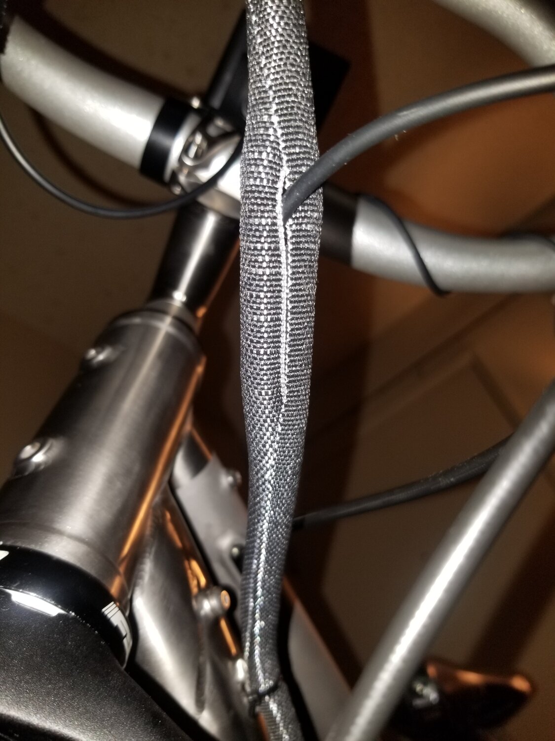

The Flexo F6 wrap is easy to remove, replace and work with
Many grades and types. I use self-wrapping, woven.
3/8th's will actually cover the 'splitters' in Higo wiring. Didn't like the hook and loop.
No wires from the Archer - just the short cable from shifter on the chain-stay.
The trade off is the 6 cut-off and 3 throttle wires. Only soldering required is 3 wires from the throttle to the Higo adapter.
Throttle > off/ on switch in the bars uses 2.2mm spade crimp-on connectors. The trade off is the 6 cut-off and 3 throttle wires.
Only soldering required is 3 wires from the throttle to the Higo adapter. Throttle > off/ on switch in the bars uses 2.2mm VW style spade crimp-on connectors.
WattWagons adjusted the Archer nicely. I click and pause pedaling, resume it shifts smooth and certain.
Once they had the parts - read: a titanium frame - holding up the show, they had the bike completed and shipped in a week. That includes the time they waited for the special order throttle.
Re rear Brake Banjo. Perhaps the hydraulics are disconnected at the lever, sealed off with a rubber cap and fed through going up. If done properly, very little leakage. Keeping both inlet and outlet the highest points, I've disconnected and reconnected hydraulics without bleeding.
Real PITA to loosen that Banjo end and I certainly agree clamp on portable lights are the way to go.
The Fork is the [LE] Pro version w/ Dorado air. 120mm.
I'm starting to think you were wise to go with a derailleur setup instead of the Kindernay hub.
As you probably read in the Kindernay thread I recently took the wheel/hub off my Hydra for it's 250km flush/oil change and found out that all of the fluid had leaked out of the hub.
I did a flush with Kindernay fluid and mineral oil and refilled the hub and installed it on my bike today.
Now I'm into 'watch out a leak' mode.
If the hub is leaking that will mean it has to go back to WW, who will probably have to send it back to Kindernay, which is located in Europe. The nice thing about a derailleur setup is if I can't fix/adjust it properly my local bike shop can.....the same day.
Once I got things dialled in on my UC Pro the derailleur has worked fine....as long as I don't use the smallest cog. :confused:
Also, the wide motor combined with a fat bike spider gear and wide crank arms give the bike a horrendous Q factor. I've gone back to flat pedals, from clip-less, because the angle of my foot , when clipped in, was causing some hip and knee pain.
I like the way you're dealing with all your wires. Well done F&F. 👍
