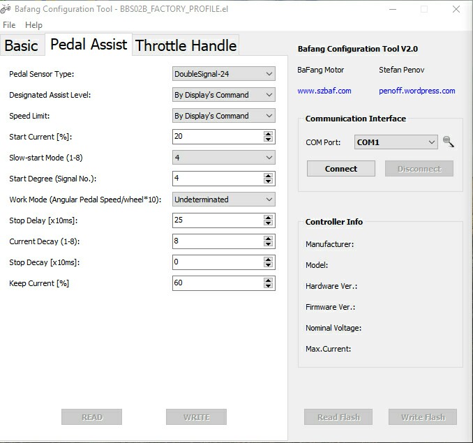

Kinda of a long way to say that you are unaware of how to program the motor correctly.
Mine is round indeed. Thanks for the input.
Pick up a Programing Cable and download the pc software or you can use the phone app which will require an OTG Adapter for your phone.
There's quite a few threads on here or just search BBSHD Programing through Google for an explanation of settings.
Hacker's Guide
For your immediate concerns.
On page 2: Pedal Assist
Set the Start Degree to 1 for immediate power up on pedaling
Set the Stop Delay to 1 (not sure if it accepts 0) for immediate power down when you stop pedaling.
Once you tweak these and other settings I think you'll be happy with the motor.
Hacker's Guide
