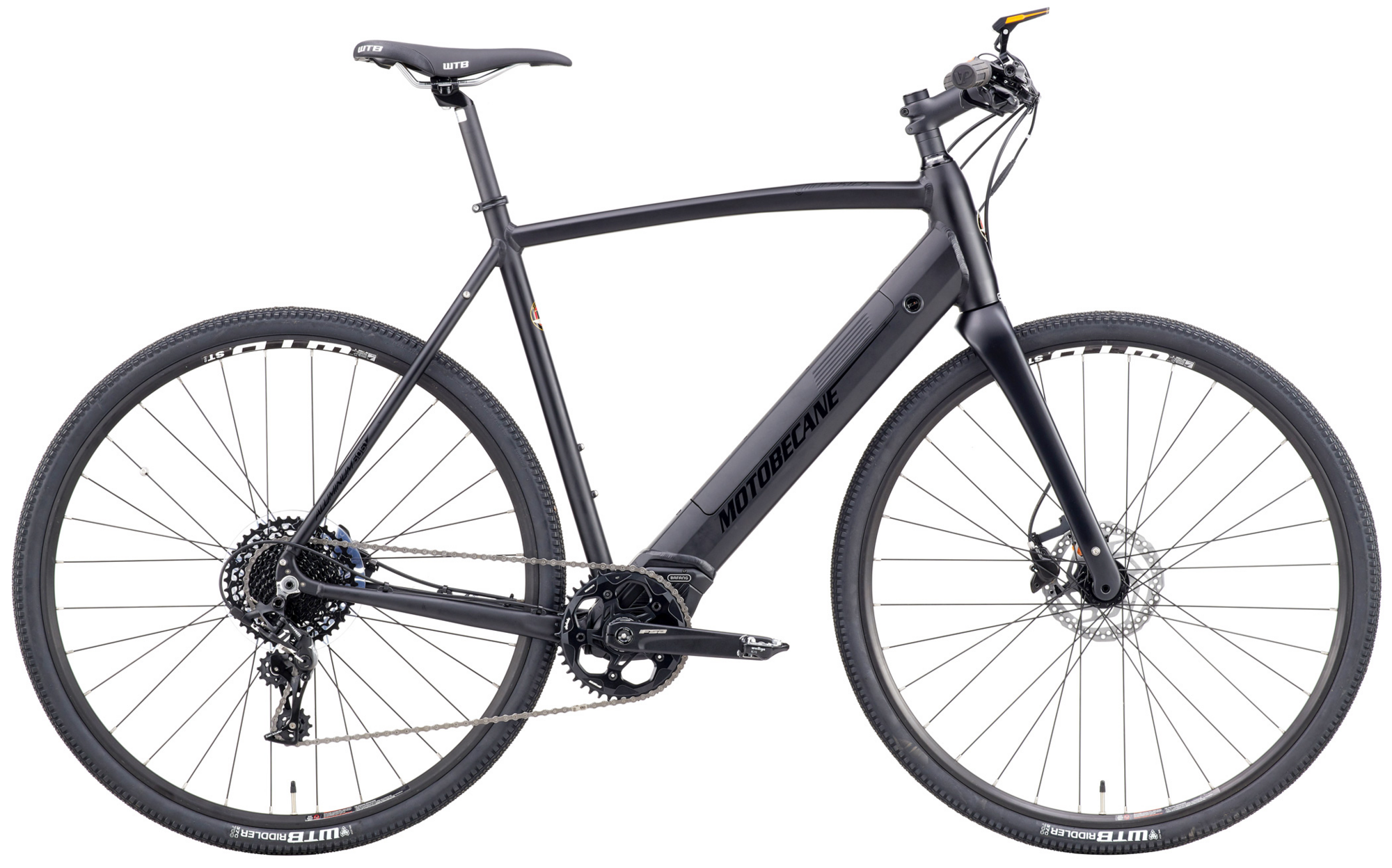

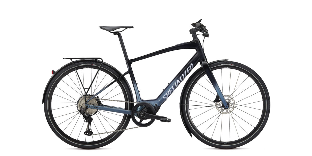

Based on your feedback on the bikes listed above, I think the Specialized Turbo Vado SL @37 lbs. might be a good match.
Also look at the eMulekick @35 lbs... both are super lightweight bikes with integrated batteries and Class 3 speeds @28 mph.
https://electricbikereview.com/specialized/turbo-vado-sl-4-0-eq/
http://www.bikesdirect.com/products...tric-flatbar-road-bikes-emulekick-express.htm

Actually the battery is easy to remove on the eMulekick @33-35 lbs less the battery weight and you are under 30 lbs.
http://www.bikesdirect.com/products...s-electric-gravel-road-bikes-emulekick-sl.htm
So in the end meeting both goals can't be done, however this one comes close, as I said in a previous post, all carbon fiber including forks.
This lacks power but at some point you have to decide between power and weight. 41 lbs this is pretty much as light they come, with a removable battery it might be as little as 35 lbs.

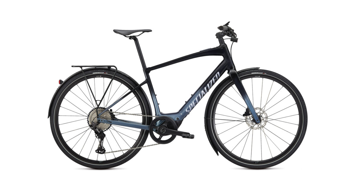

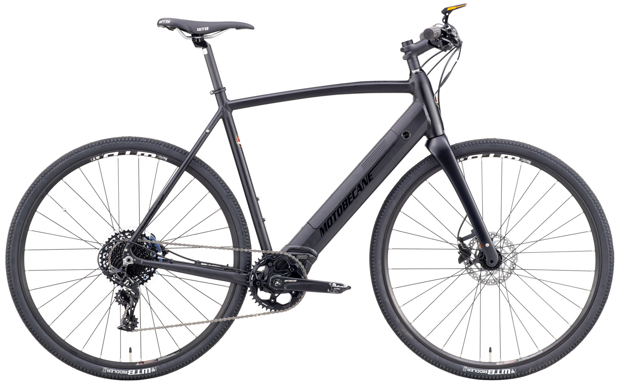

View attachment 53454View attachment 53456
Thanks for this. I wasn't getting updates in my email so I thought you'd all disappeared but see you're still on the case! Thanks guys. SO... with this Specialised Turbo Vado SL, the weight is pretty good (15KG) but do you think it would provide a high level of pulling power up the steep hills I have to go up? I think I read that the torque is only 35NM so I guess the motor must be impressive. How would you say this compares to the Specialised Turbo Levo as regards weight and lots of power up steep hills? Is there a big difference when the battery is removed for carrying indoors? x
BTW, you can always remove the 5-6 lb battery when carrying the bike up steep stairs to reduce the weight to an acceptable level.
Once arriving home on my bike, i expect to have to lock up my bike briefly, remove the battery and panniers and do a first trip indoors followed by second trip with the bike. It seems removing the bike is the most practical way for me to lift it up our stairs. Having a slightly heavier bike whilst riding isn't such a problem as the assistance will help if i'm struggling.
Turbo Vado SL: You cannot remove the main battery yourself and that's the price for the bike being so lightweight. You can buy an additional battery extender for more support uphill (since riding uphill uses a lot of battery) and remove that extender. But not the main battery.
