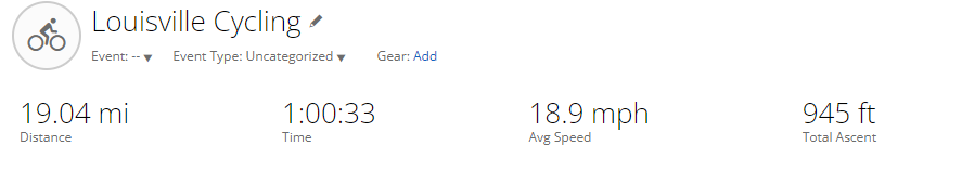

I ride my GMAC 10t 3 times a week for over 8k miles with typical rides about 1.5 hours and 1.5k elevation gain without any issues. No signs of any overheating issues when opening up the motor.
I do run a Grin PhaseRunner and CA3 with temp control and push this system to the limit everytime I ride it (i.e 6% grade, 25mph+, 15mph+ headwind). Temp control starts at 90C at ending about 110C. In the hottest conditions I stay between 90c and 100C. Many other ride stats I can post but this seems the worst case (grade+speed+wind)
Here is a 1 hour, 1k elevation gain ride. FWIW, 18.9mph average is 'super fast' for this loop considering the typical wind (I typically average about 15-17mph)
I have a friend/neighbor which beats this by a SUBSTANTIAL margin on his GMAC equipped Juiced CCX but he is 70# lighter, highest motor temp he has ever seen is 75C (CA3 temp control starts at 90C). He has averaged 21mph for this loop which is completly insane IMHO.
