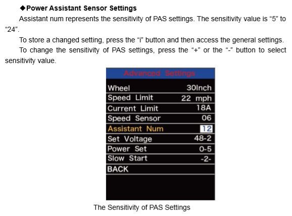

@camdon44 , I think the culprit is in your advanced settings. My "Assistant Num" is set to the default of 12; which is the midpoint, of the range.
Also, it looks like your controller has a newer firmware. As my Current limit doesn't have a "Sport" option

My wheels are set to 28" , If you're referencing the 30" from this image; it's a screen grab out of the pdf file, for the controller.
