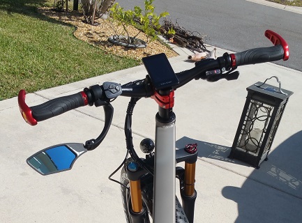

Like the red and gold accents! Looking sharp. What is up with the mirror on the low side?
I find the position makes it easier to give a quick glance at the mirror, because the backdrop is usually the road; which is a more static background, against the moving objects in the mirror.
LGC, when I do get a mirror thats exactly what I plan to do. Ive seen many guys on Harleys or similar motorcycles run their mirrors like that.

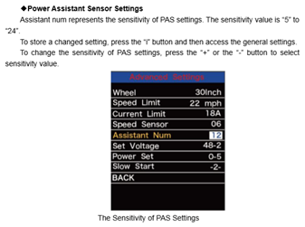

My wheels are set to 28" , If you're referencing the 30" from this image; it's a screen grab out of the pdf file, for the controller.

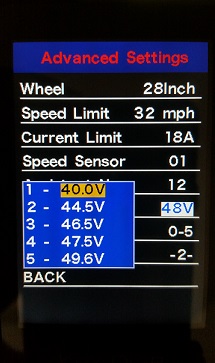

These are my Advanced settings:
Slow start is a delay before the motor kicks in, when you resume pedaling; this can become important if you start pedaling mid turn and the motor kicks in before you're ready for the increased speed. When you get a chance, checkout the link that I sent you to the manual (via PM); it has a brief description of each setting.
Mine was set to 20A

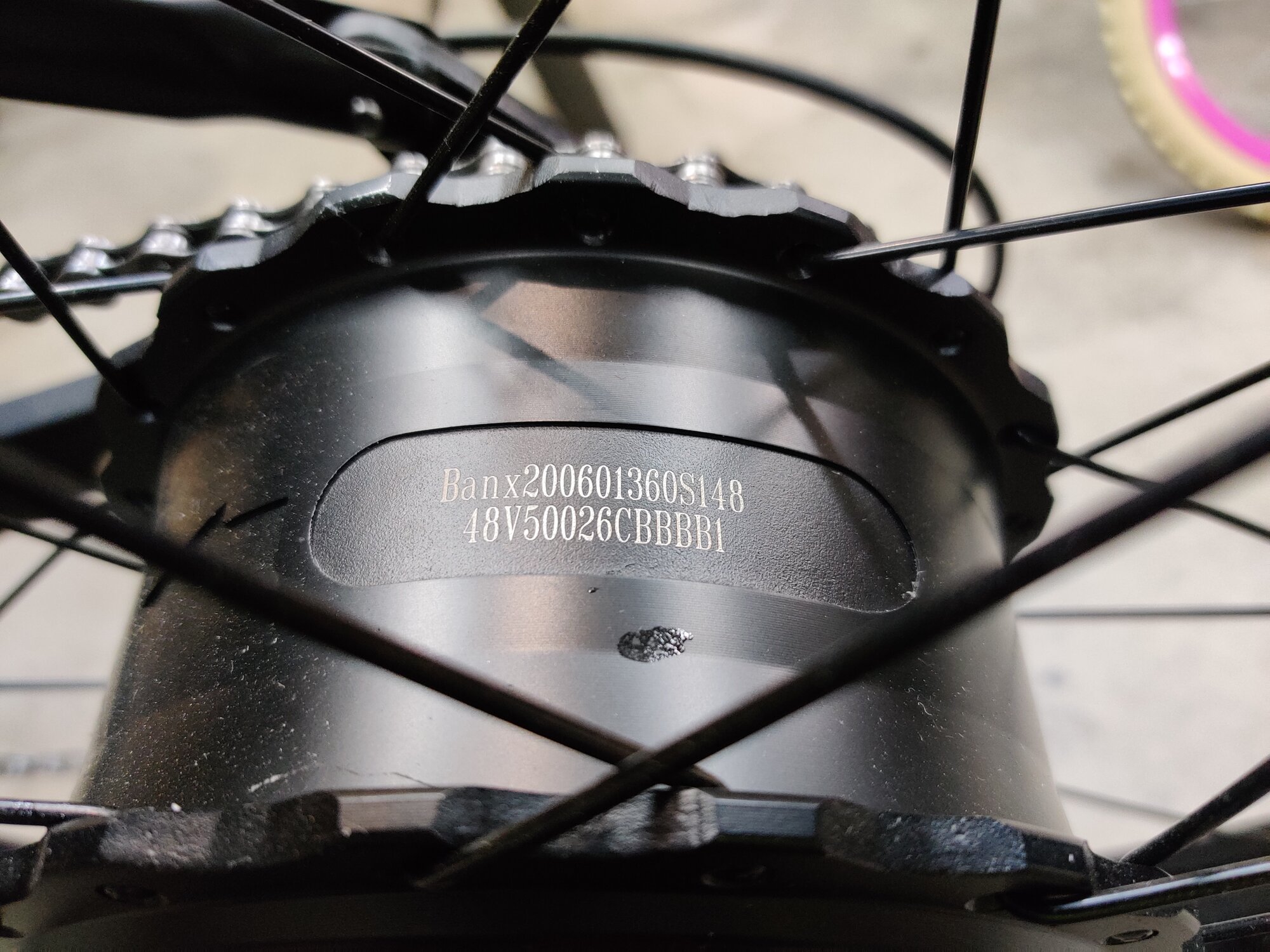

My motor has the same label I questioned wallke and the said it’s an error - on the label! That is some error! Doesn’t feel like 750watts but waitin for the pedal sensor - bike delivered from UPS had scratches, broken cadensensor and derailleur guard crushed - removed it and seems the derailer which is NOT Shimano Altus as advertised but lower end Tourney seems to jump around gears on its own so will need to adjust - pretty frustrated with that. Wallke sending new guard and sensor via dhl so hoping to get by next weekend.

Dont get me started on the advertised 750w Shengyi motor that isnt on the bike. It happens to be an unknown (Banx?) that just so happens to have some sort of model number that begins with 48V500..... Hmmm. Like you said they claim its incorrectly labeled. Maybe Shimano incorrectly labeled these cassettes and derailuer too?

Why is the motor label showed 48V500xxxx?
There is an error on the label of the motor when it left the factory. The motor cell is actually 750 W. When we found the error on the motor, the bikes were already packaged for shipping. The problem is that the label was misprinted but the performance is completely consistent as designed on a 750W. If we made a changes to the label, it would have delayed another three months. We don't think that the customers would want to wait for such a long time. Therefore,we kept the original label and we will print the right label on the motor in our next batch.
