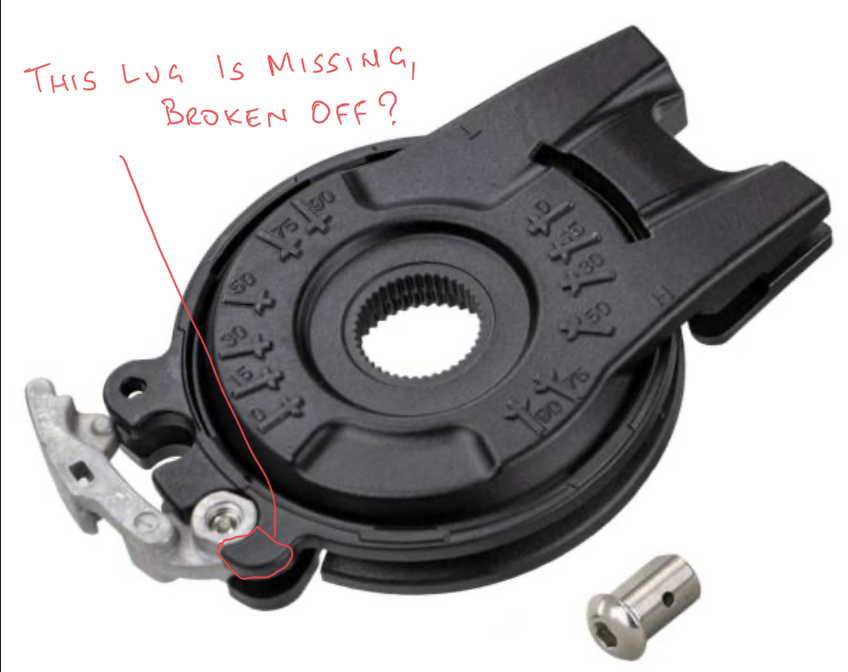

Recently, had some work done on the Enviolo hub, as had a broken part, which was swapped out and some new cables. So assuming that it is associated with that, maybe an alignment issue.
