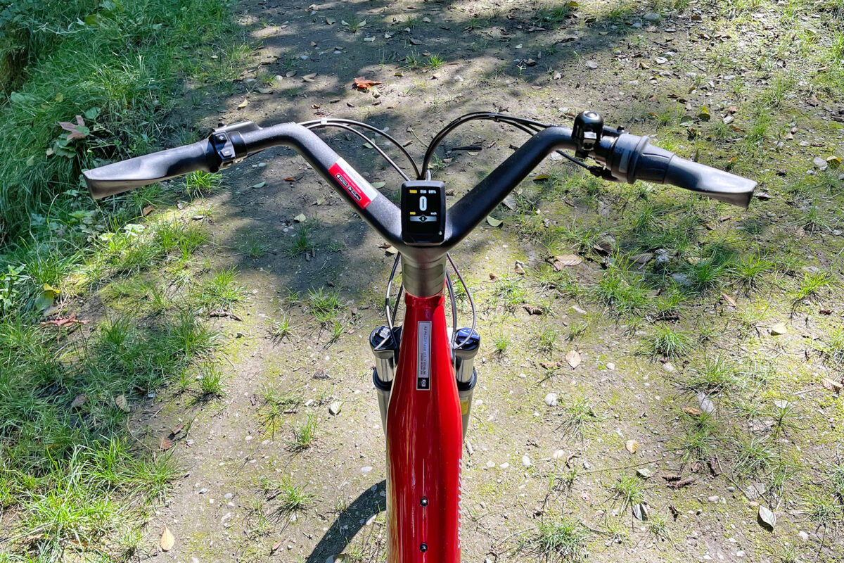

I wanted to give everyone a heads up regarding the new Specialized Turbo Como 3.0. I worked so hard to find a new bike that fit my body and met my mechanical needs from my Townie ebike. After test driving as many options as possible in Victoria and with the great amount of help from this website and the guys at Caps in Port Moody I was happy to purchase this bike. Everyone was very helpful and supportive.​
Myself and my husband have always had Specialized bikes and this is the brand that fits my body, after being customized. I was confident I could do the same with the eBike and was so excited to purchase this expensive, new bike. I soon realized after visiting a few bikes shops that Specialized has totally limited the adjustments to this bike. You can’t adjust the handle bars at all, it’s totally locked down and cannot be adjusted. WHY would they do this? I am beyond frustrated with this ebike, I just need to raise the handle bars up another inch to ride it without pain. I am at the point I am going to cut pieces of pool noodles to put on my handles.​
I just wanted to add this comment to anyone’s interest in this model of Specialized so you don’t make the same huge mistake I make.​
PS, one more point. Specialized should realize their demographic is older riders, why make the computer screen so hard to read. I can't see anything in the sun and the read outs are way too small. LOVE my Bosch system on my Townie much more.

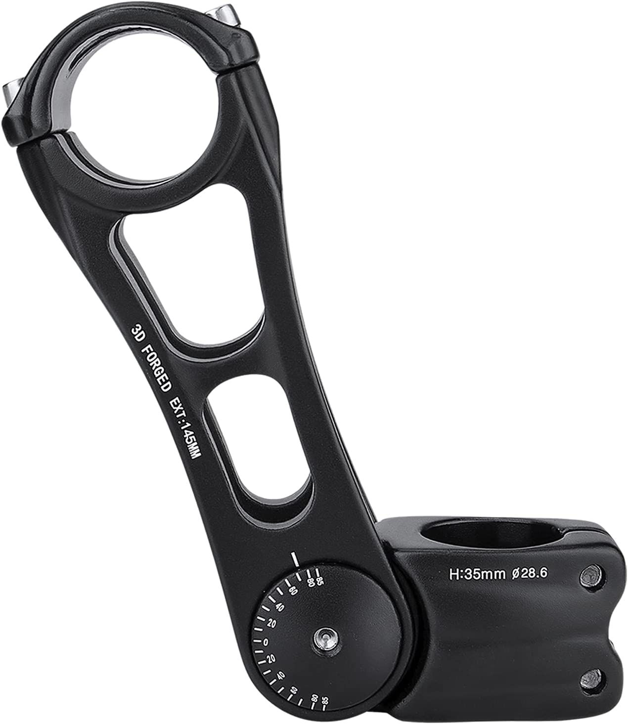

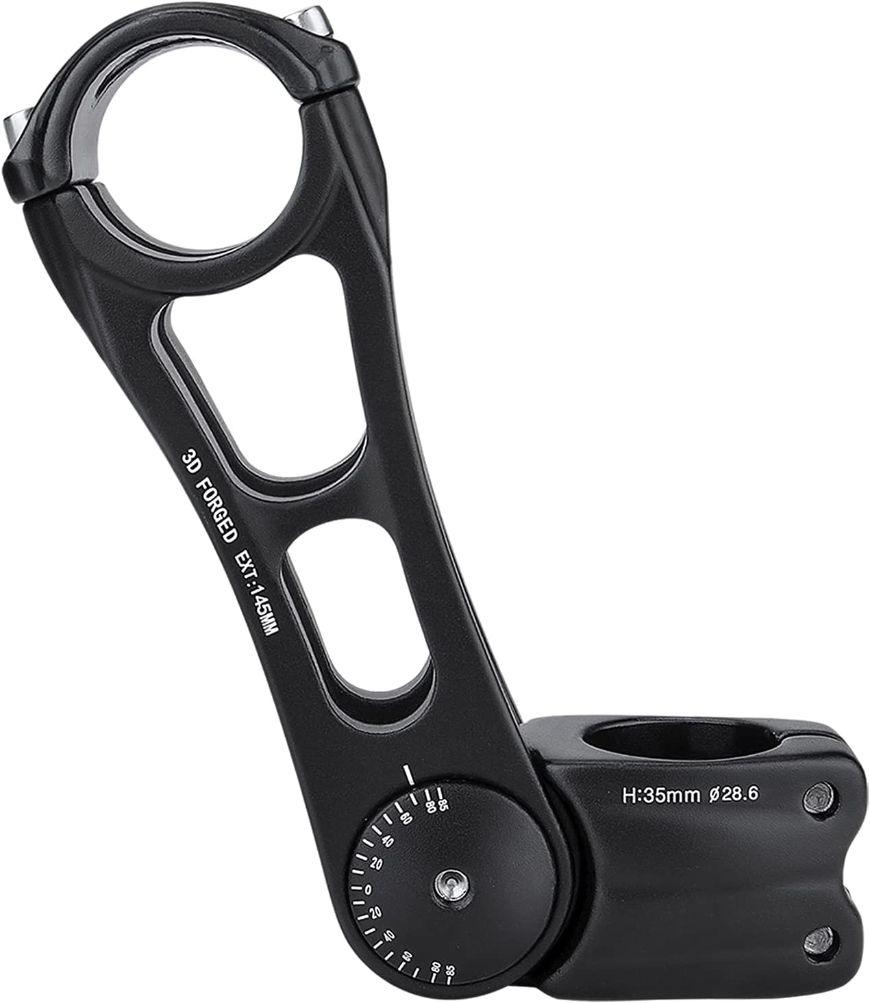

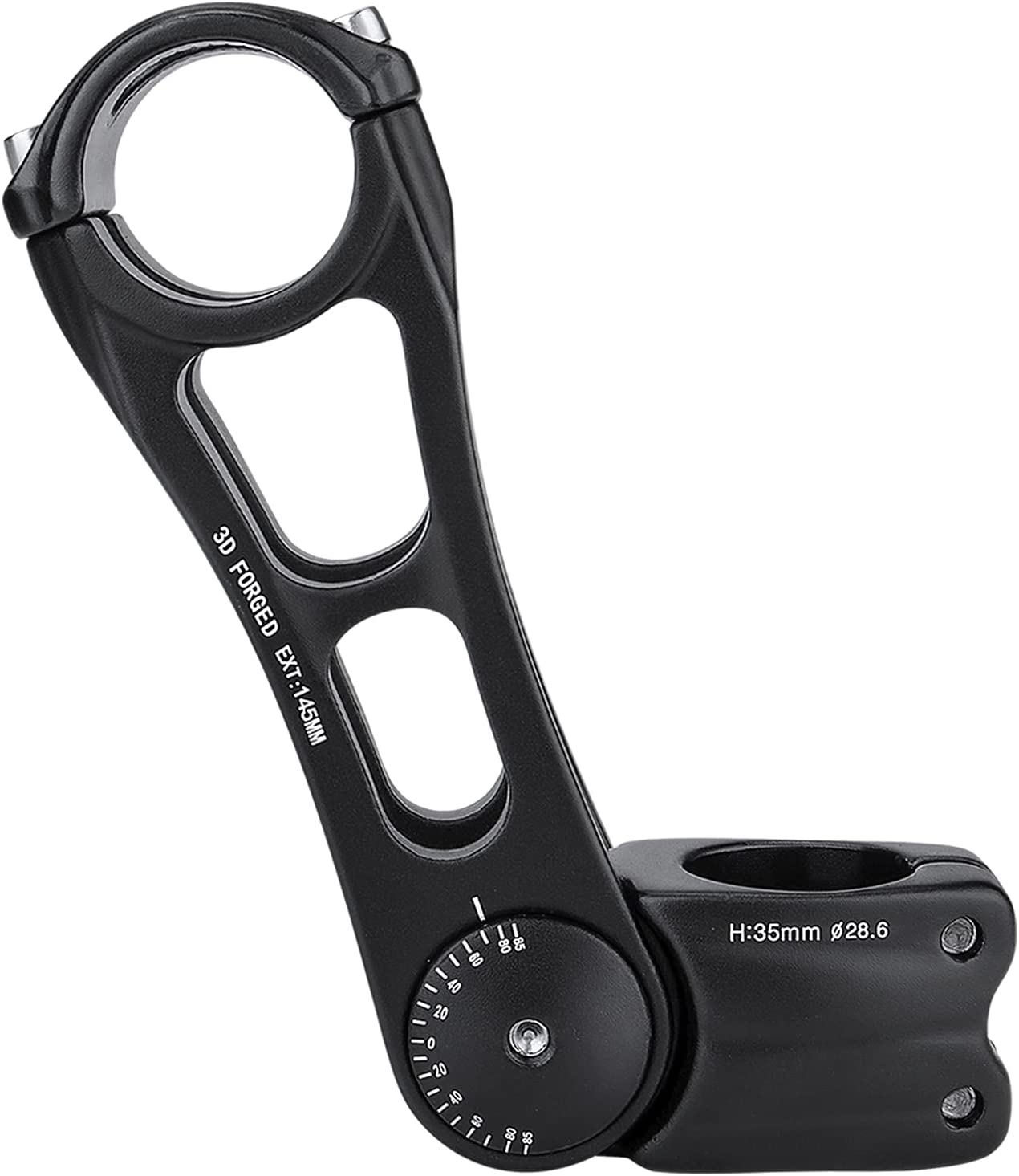

Out of curiosity and boredom I looked at an image of this bike. The stem riser and handlebar looks like a single unit but the fork stem should be a standard size like 1 1/8" (28.6mm). Can't a bike shop just replace the riser and handlebars with more standard units? It looks like the cables/lines are long enough for additional height. Parts would easily be less than $100, then cost of installation if you can't do it yourself.
$20 for this one, they come in different sizes and styles if you don't like the look. Then handlebars of your choice as long as the cables are long enough for what you choose.

There must have been a misunderstanding. Even without seeing it in person I'd be confident that the stem and handlebar can be removed and that the steerer tube is standard. Should only need new stem and handlebar and additional steering tube spacers. There are options for display mounts that would take the place of a steering tube cap or spacers.
You would need to find a shop with at least a little bit of imagination and minimal ability.
If you already have the bike and like it (it looks like a great bike) it might be worth the effort to have it looked at by a competent bike shop.
Of course I could be entirely wrong about everything and specialized has some proprietary fork/steerer tube but that seems unlikely.
Multitasking as I'm out for a ride.
As EMGX said, the steerer tube should be of standard size, and the TCD display mount is Garmin compatible. (Unless I'm wrong).

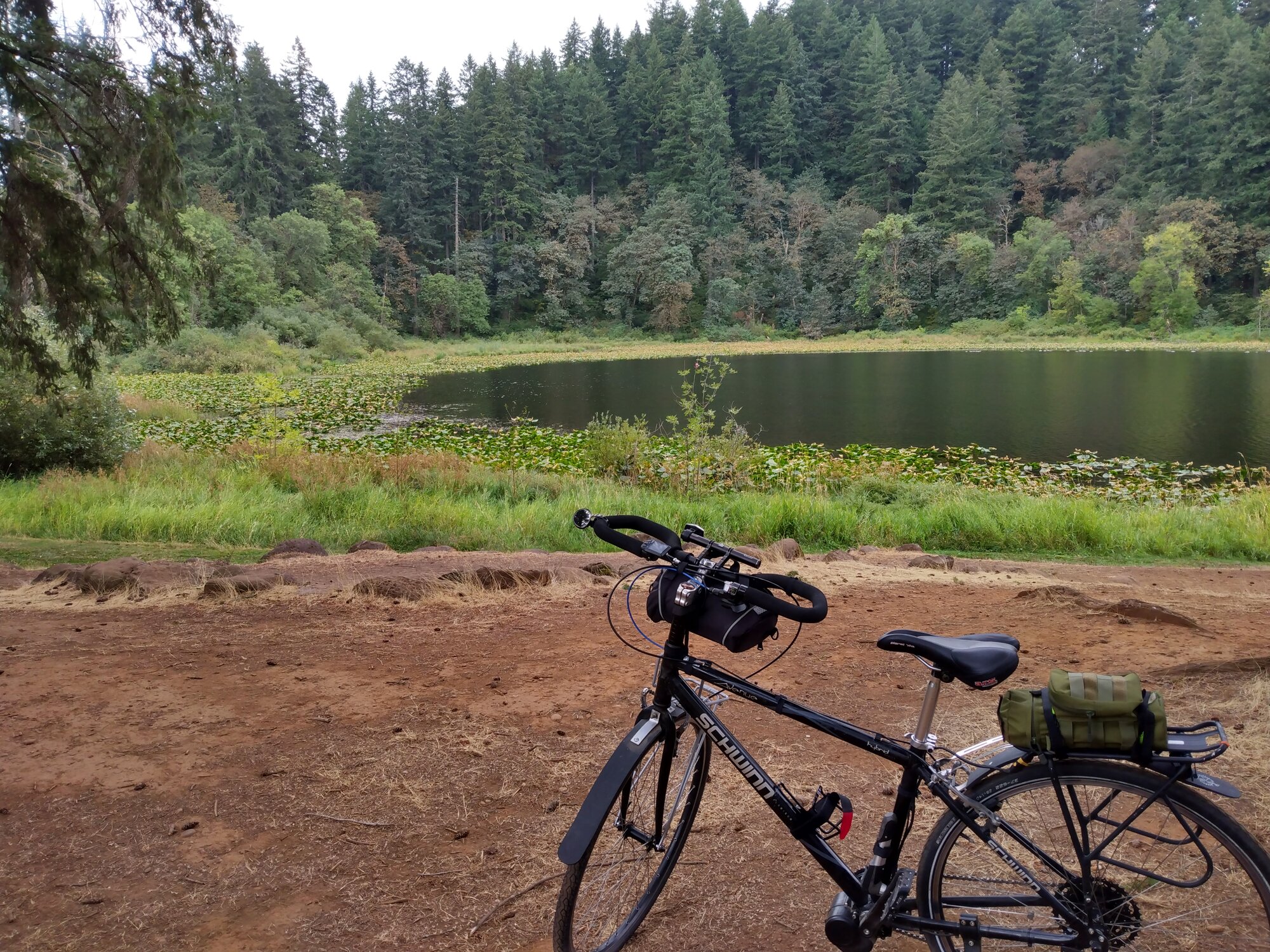

P.S. The picture Alaskan showed indicates the comfortable handlebars are located very high. Making it even higher could be difficult even with a 75 mm stem raiser, and it would cause the rider to sit not only upright but in a weird backwards position.
