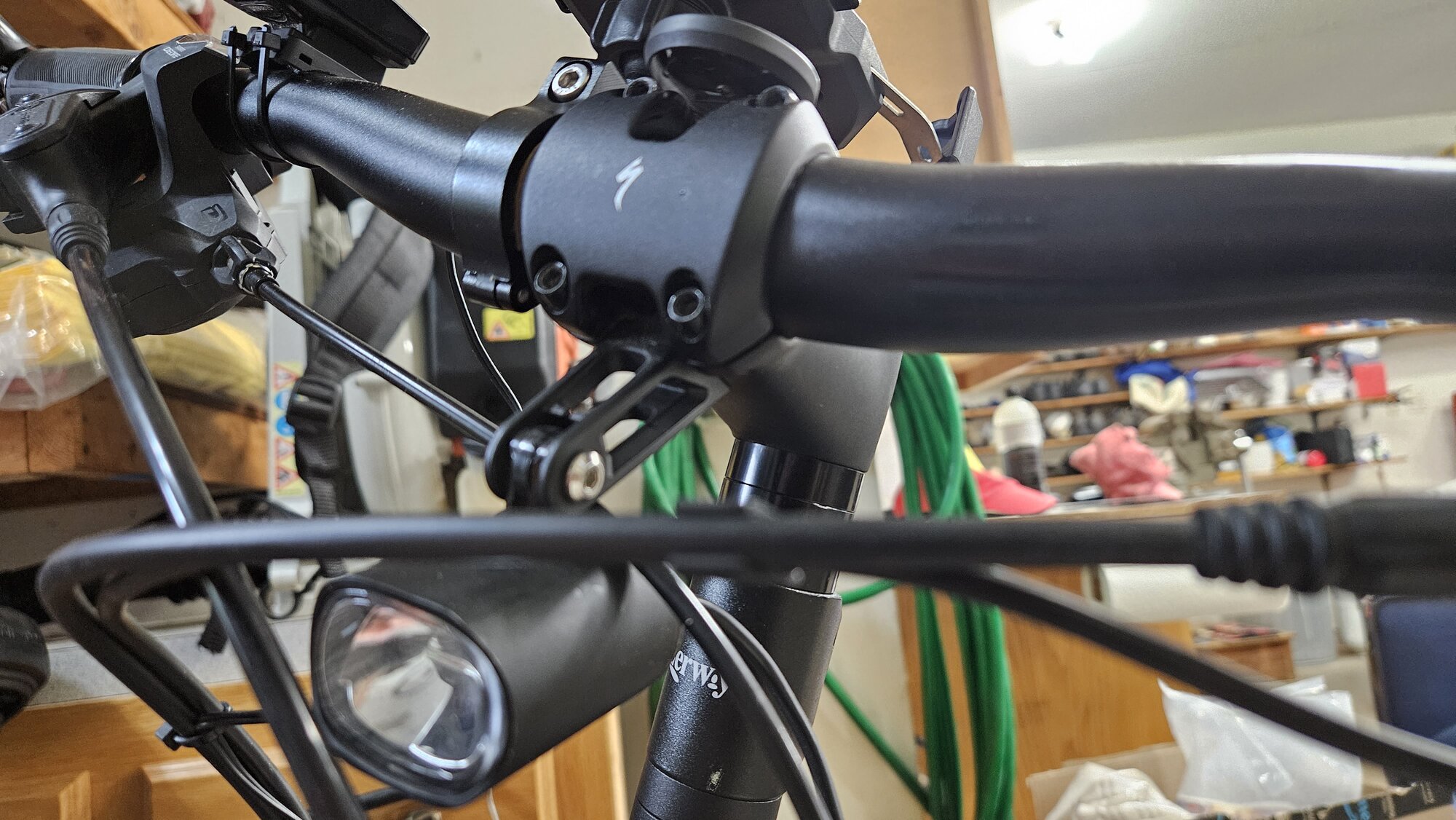

Vado SL and Red Shift Suspension Stem
Drozdster
I am thinking about installing the Red Shift Suspension Stem on my Vado SL but don't think it will work because of the light being in the way.
What have others done to get around this? Other Suspension Stem manufacturers? Move the light?
I don't feel like reinventing the wheel if others have a solution already. LOL
Thanks!

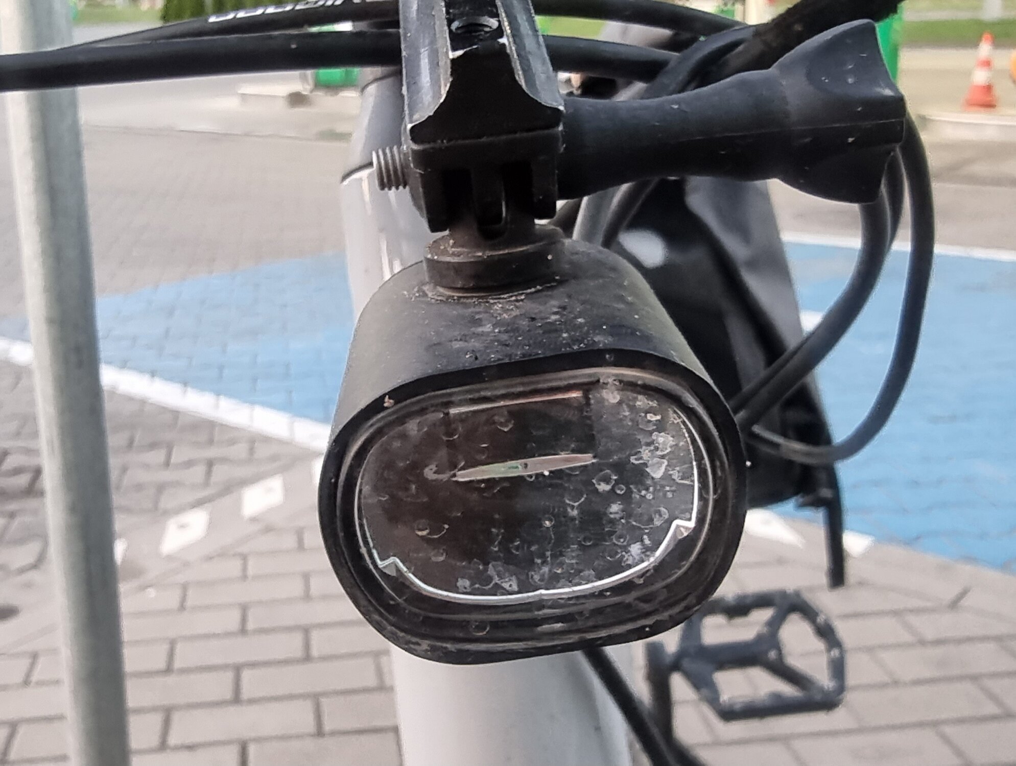

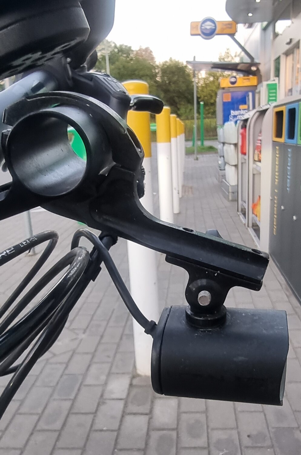

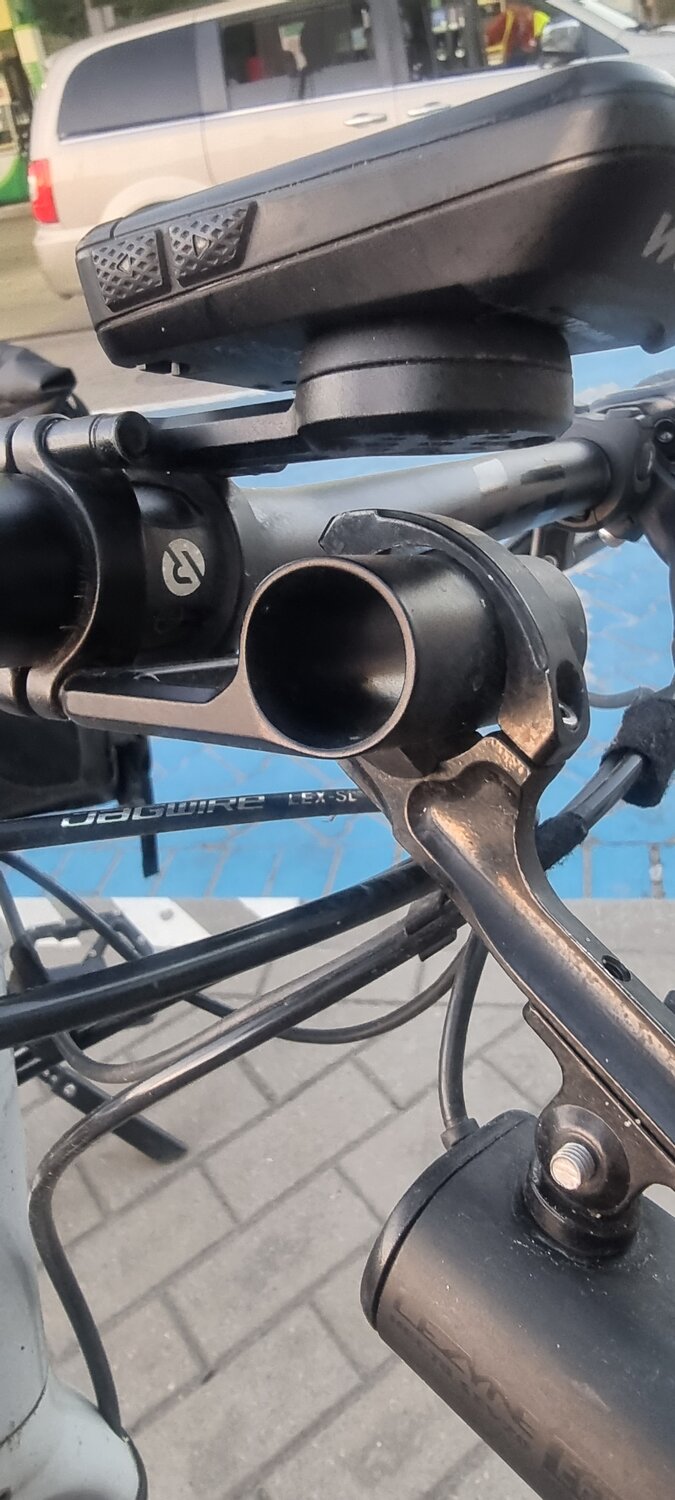

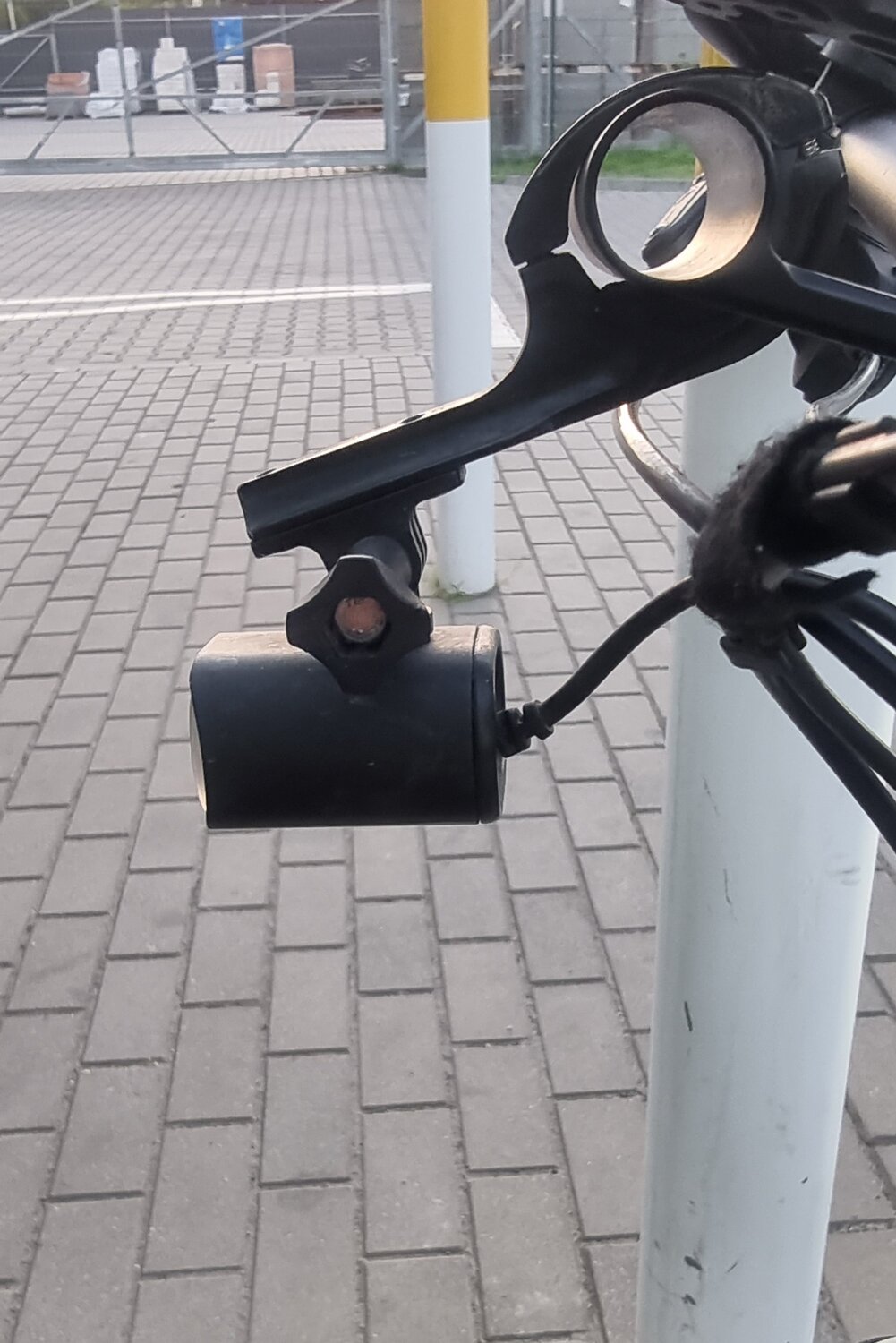

Stefan....how do you affix the OEM headlight to the 25.4mm RedShift utility mount??

Thanks for this Stefan! You are the McGyver Cyclist!!
I've said it before...I have a bit of OCD....and I don't love the extra bits and extensions necessary to secure that light.
I need to take my light off and see how it is connected. Drozdster might have a more 'refined' solution.
My previous solution, that is, installing the GoPro mount on the bars didn't look good and the light was on the left side of the bike centre.
I am a very poor mechanic, so adding the "shim" cost me a lot of nerves. However, the solution has turned out to be totally reliable. Like in "set it and forget it" 🤣
