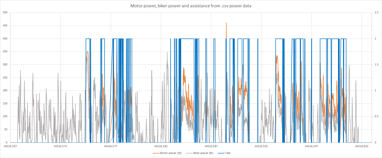

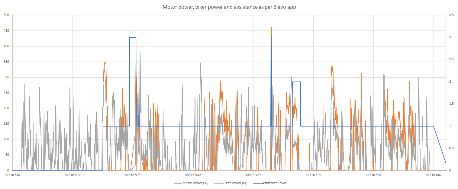

I've done some more study on this now and I think there are some problems with the Blevo app when it reports assistance levels, and therefore what it reports when it calculates the data. Bear in mind this is on a Vado 3, not one the bikes for which the app was written.
Below is the thumbnail graph of a recent ride, when the majority of the time, the assistance was either OFF or in ECO mode. The app reports that, after an initial time when the assistance is switched on, it never goes below ECO and briefly goes to TRAIL and TURBO modes. In fact, for a lot of the ride, the assistance was switched OFF. Rider power grey, motor power orange and assistance levels (on the right side, levels) 0,1,2&3 for OFF, ECO, TRAIL & TURBO.
Below, is the same power data with a logical analysis of the times when both rider power and motor power are present, representing times when the assistance is either ECO, TRAIL or TURBO (it is irrelevant which). There are many occasions where only biker power is being recorded, corresponding to when the assistance is OFF. This is at odds with the reported BLEvo data in the .csv file. I shall have to analyse the data further and perform some calculations to see how they stack up against Paolo's, but it may take me a while... Incidentally, the assistance level is shown as an arbitrary number 2.
