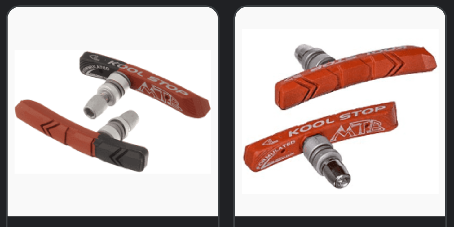

I first used and posted about these ebike pads in 2016. Evaluation samples, and bought more over the years. High mileage riders might be dissapointed in rim wear. They are an improvement, but the Salmon MTB, labeled “for wet conditions”,
pads are nearly as good. I mean REALLY close. But I’m slowed down. My new trike will be Magura 4 piston and regen braking. A complete shift in thinking. But it’ll be a big lumbering ride. Lots of inertia.

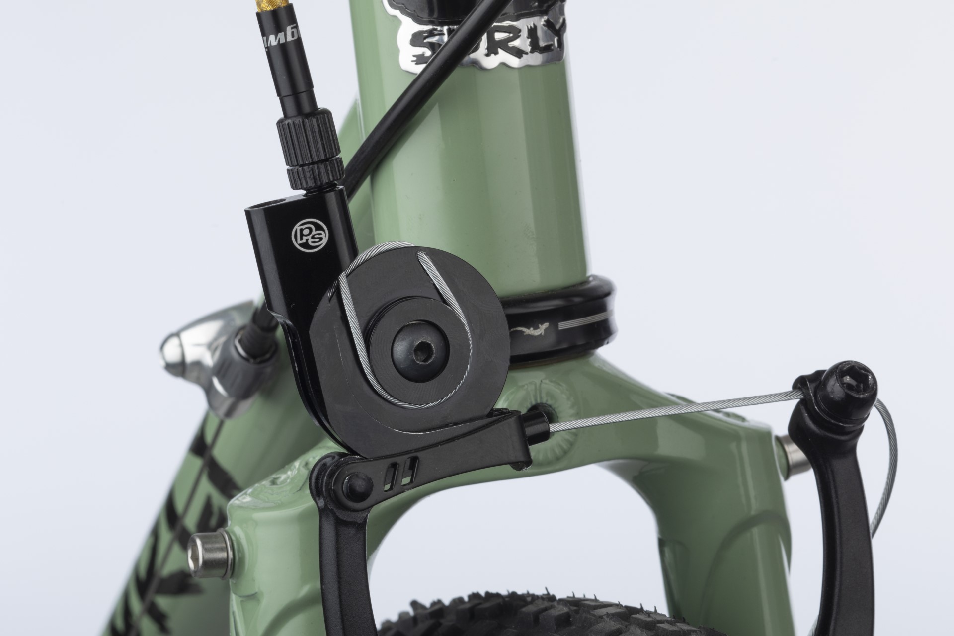

Another thing to consider is adding travel agents to your brake cables
The TAs are indeed a great addition if someone was upgrading from something like road type brake levers to use with the V brakes. If a bike already has the appropriate levers in conjunction with the V brakes they wouldn't be needed ... although I have heard of folks with smaller hands or those with compromised hand strength who have added the TAs to their existing v brakes to help with braking strength.
Huh, You learn something new every day !
I have never even heard of TA s before....still don't know what they do, even after reading instructions !
They increase the amount of cable pulled by a little bit when the brake lever is initially pulled. So less pull on the lever creates a bit more leverage at the brake itself.

The TAs don't change the total amount of cable pulled by the lever, it just becomes non linear. With the TA's cam setup the first part of the lever travel pulls a different amount of cable than the latter part of the lever's travel, but by the time you've pulled the lever all the way you've gotten the same amount of brake pad movement as you would have without the TAs.
All the descriptions indicate their purpose is to “fix” incompatible levers pull. No?
Define "booster". I ask because I've read different descriptions of brake boosters.
A spring system would probably be a "Booster" what you are describing sounds a little like a compound bow, the cam would probably increase the leverage at some point.
That's what I use them for. 9 spd Shimano 105 road levers with V brakes (I think they're Nashbars) on my road/gravel ebike. It's not like these levers don't work at all, it's just that the braking force seems better with the TAs in place.
