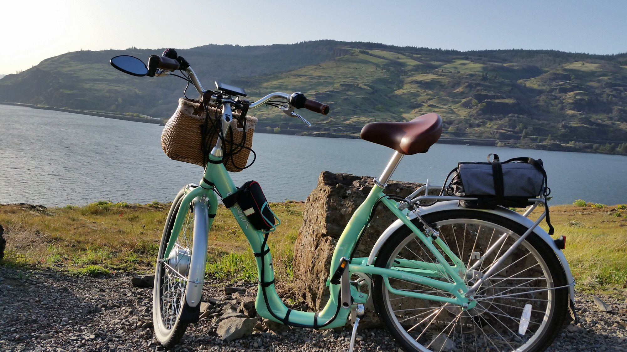

I wouldn't recommend a DIY conversion unless you already have a bike that you like and want to convert or if your wife has some specific requirement that isn't fulfilled by a ready made ebike or if you just really want a project. Otherwise why bother when for similar cost you can get a new UL listed, warranted bike. I agree looking for one with torque sensing although my wife likes her cadence sensing Biria conversion as much as a prior bike that I converted for her with torque sensing TSDZ2. She needs a very low step bike and I already had the front hub motor from an old project which works great even in very hilly terrain. She doesn't mind the exposed wiring or battery on the back rack.

I also thought the BBSHD was way too much motor for a granny bike. Maybe Grandpa wants to ride it. I'd like to get my wife a Biria like EMGX, and it would be fine with a small hubmotor.and small battery. Could probably sell it every time we went riding.
