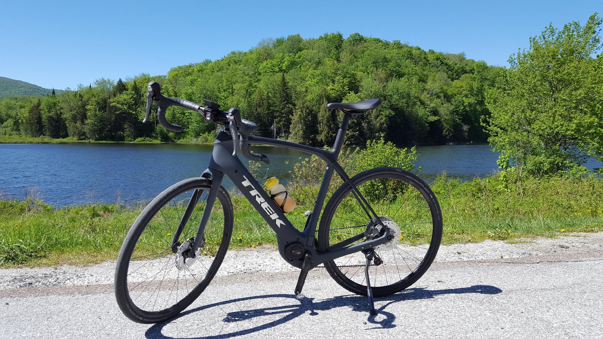

Did a short ride today, 14.6 miles. Half way out, I noticed dark clouds forming on my return route. So turned back early after exploring a gravel side road. With a total ride of 14.6 miles, Kiox indicates 86% of charge remaining.
Picture below, from yesterdays ride, 26.4 mile loop. I now have my small, bar end mirror mounted. Still haven't decided whether to remove side stand or not. It is pretty useful, but heavy.
Picture below, from yesterdays ride, 26.4 mile loop. I now have my small, bar end mirror mounted. Still haven't decided whether to remove side stand or not. It is pretty useful, but heavy.View attachment 88543
I had my kickstand removed. I figure the bike is heavy enough why add weight!!! Beautiful picture
