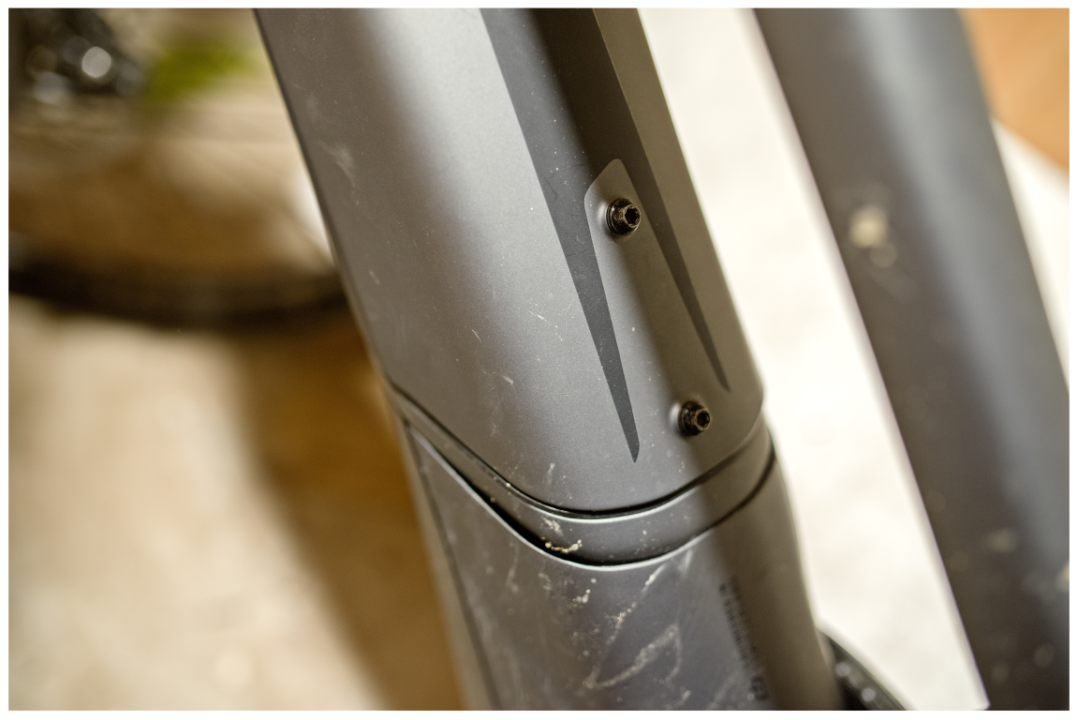

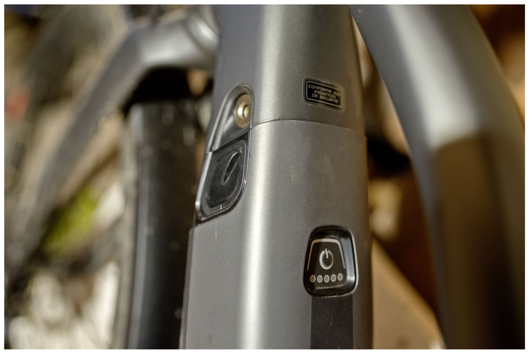

@smitty, my cellar garage almost never reaches temperatures below the freezing point but it is cold. For that reason I learned removing and re-inserting the battery to charge it and store in the flat. Re-inserting the battery is even not hard after some practice. The point is the bottom part of the battery cover needs to be
neatly aligned with the chamber.
This is the properly aligned bottom of the Vado battery on re-insertion.
This is how the top part of the Vado battery should look like before locking it in the frame. There is a very small gap, almost invisible in this picture. Now, this part needs a slight slap to lock. It doesn't even need the "ye ole good slap"!
