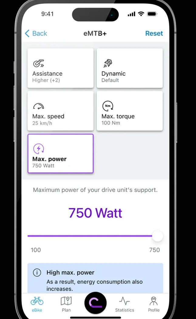

Bosch Smart System does something similar with adjustable pedal dynamics. By reducing dynamics and assistance to Lower, you get pretty much the same thing.
It was certainly not present in 2017 :) Is there a comprehensive Motor Power Cap in the BES? Like moving the slider to limit the Peak Motor Power to 50%?

I know the max motor power of my 1.2s motor is 520 W. If I set the cap at 50%, I know the motor power won't exceed 260 W. Now, the torque and power are related by the rpm. Is setting the motor torque same as setting the motor power? How the relationship with the rpm looks like there?
